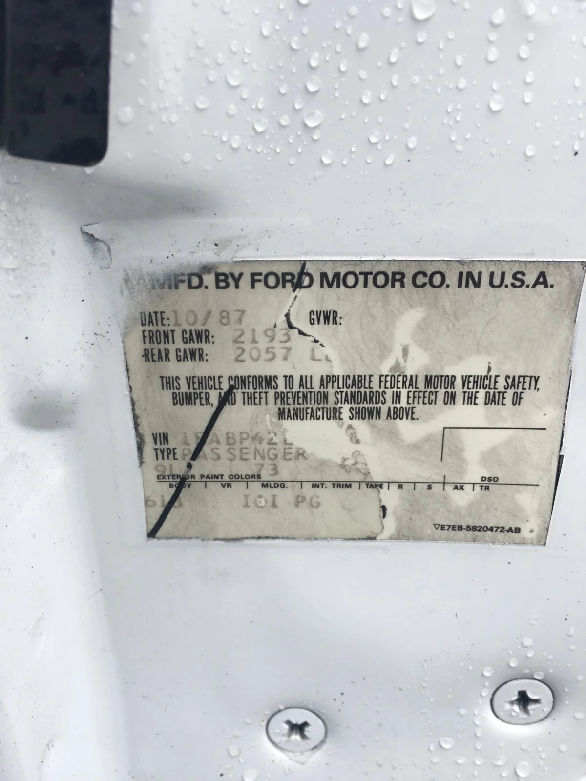

Looking at door tag Ive look every but can't find what mines is saying about my Notch
anyone know what PG stands for under int trim or what's next to it

PG = Smoke Cloth
1988 Mustang GT VIN and Door Tag Decoder Form | 1982-1993 Mustang GT Registry

That door tag is from a 1988 GT 3-door sedan (hatchback), not an LX 2-door sedan (coupe/notchback)
VIN
1FA = Ford vehicle manufactured in USA
B = active belts, no airbags
P = passenger car
42 = Mustang GT 3-dr sedan (hatchback)
E = EFI H.O. 5.0L V8 engine
_ = VIN check digit
J = 1988 model year
F = Dearborn Assembly
______ = ______ 1988 Ford scheduled for production at Dearborn Assembly
Door Tag
Date - 10/87 = October 1987 build
Exterior Paint Colors - 9L 73 = Oxford White (9L), Titanium lower accent treatment (73)
Body - 61B = Mustang 3-door sedan (hatchback)
Mldg - III = Titanium bodyside molding with Blue inset stripe
Int Trim - PG = cloth Articulated Sport seating, low-back front buckets (P), Medium Grey interior trim color (G)

With a build date of 10/87, it could be an '88.
My '88's build date is 12/87. I purchased it 01/88.
They used to change over in August for a September introduction.

Yes, it's a 1988 model. I fixed my error.

Curious as why the OP stated he had s notch, but that tag is off a hatchback (61B)
The tag is partially missing as well, so wonder if it’s been tampered with

OP has a 1986 LX 2-door sedan (P26/66B coupe/notchback)
Door tag is from a 1988 GT 3-door sedan (P42E/61B hatchback)

Lots of missing info on it as well.

Probably the door got swapped at some point.
