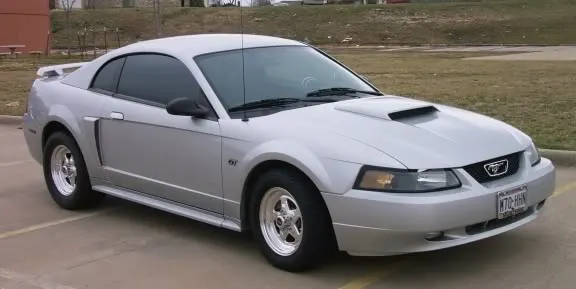

This could possibly be a dumb question but i have been searching and can't find much of an answer...
Will 15" drag lites/ pro stars fit on an 01 GT? What should the backspacing be? I know I've seen sn-95 cars with them... I'm either going with them or some deep dish bullits. But I like to be different and I haven't seen any newer stangs around here with weld wheels.
josh
they do fit you could go with 15x8 with a 5.5 backspacing or a 15x10 with a 6.5 backspacing.
I assume those are 15x8's in the rear...what size tire is that?:nice: I can just see the car with a spoiler delete and the mach 1 grill delete....Im tyring to invision my car lol:flag:
