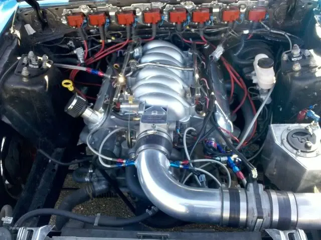

Wondering if anyone has some tips on setting up my suspension. I have UPR pro series front coilover suspension including anti-rollbar and adjustable control upper/lower arms.. I am running a ls6 vett motor with th400 trans 4k stall. I believe it has 4cyl springs in the rear. I noticed when i sit in it the car leans a bit to the drivers side and im not fat... So any tips on setting this thing up properly? Im running 275/60/15 MT ET Streets. Slips are 1 NA pass and the other 2 on a 100 shot... but my converter isnt liking the extra power so i need to upgrade soon.

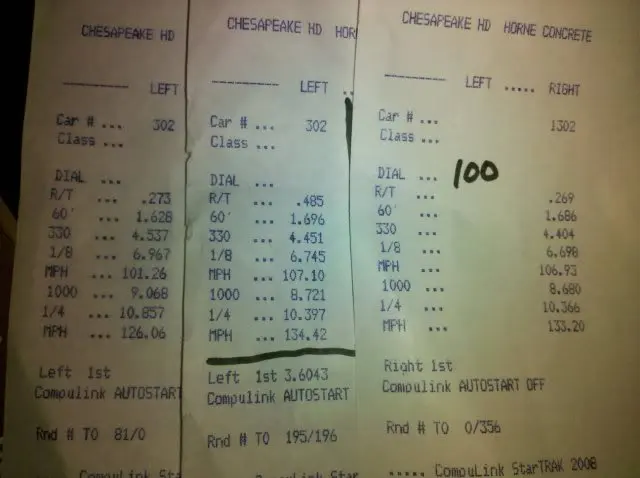

Love the car man. The problem is it looks like you have $20k in a drivetrain and 25 cents in a suspension to put the power to the ground. Dude, you clicked off a 10.3 @ 134 on stock 4 cylinder springs??? That's a DEEP 9 second car scaled with the right suspension under it.

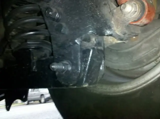

I cant tell the springs in the rear dont say anything on them unless im missing it somewhere.. I just know they feel soft so i guessed 4cyl. and the rear control arms i cant tell what they are exactly either. but they are boxed and have 2 holes on the bottom .. imma try to get a pic
are those control arms welded to the lower shock mount? If so thats all wrong for the southsides. Either way, get rid of those southside lowers, they work well on a 12 second car, but they are too aggressive for what you are running and will cause you nothing but problems.

Thanks for the info, I have a message in with the original owner about the rear springs and control arms to find out for sure, BUT the front springs are 150# i thought they were 14" .. i have to jack it up and take a peek to double check the length but im positive they are 150s.

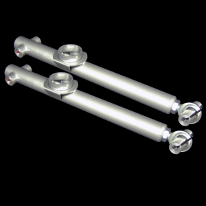

Definitely go with the UPR control arms rather than the mega bite jr. (I've run both) You don't want an arm with the relocation brackets on a Fox Body. The UPR Pro Series control arms are super simple but they work well.
I agree with this to a point, not saying that there is anything wrong with the UPR stuff, but the team Z is a better design. They make the only double adjustable lowers that i know of so you do not have to remove the front bolt when making adjustments to square the rear in the car. Just loosen up the two jam nuts and make the arm the length you need it.
UPR
Team Z
Also, i think your car would benefit from thier relocated upper control arms. Thats something that you would have to talk to dave about to make 100% sure though
UPR
Team Z
I like the idea of the lowers being double adjustabe... but from an engineering physics standpoint, I don't like the extra point of failure introduced by that teamz design though. (I suppose he wouldn't sell them if they break though?)
Anyway, the fastest stock suspension cars don't use that double adjustable style or the upper arm relocation.
Look at UPR, Wolfe, RaceCraft, even TeamZ. Their fastest guys use parts that all look very similar. I've been using UPR for almost ten years and have been very happy with it.
