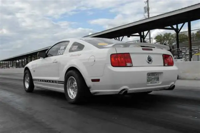

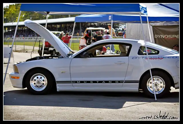

I am looking for the pic of that white s197 stang with the draglites on it that was posted on this site. I am looking into doing this and wanted to know what the owner did to make it happen. I cant find the pic no where, need help. Who owns it and can you post the pick.
I can tell you that Weld Draglites do not fit unless you do alot of caliper grinding in the rear. I think the fronts are working with like a 3/8 spacer. Lately guys have been using Jeg's version of draglites and prostars which look the same but the rears fit with no issues but the catch that some don't like is the fact that its a 15x8wheels with a 5.5 backspace, most want a 15x10.
rear 15x8 with 5.5 backspacing will work in the jegs wheels
front 15x4 with a 7/16th spacer i think i used. in the jegs wheels will work

Thanks guys, does anyone know the pic I'm talking about, he is a member on here?
i could of sworn i saw a picture on another board. i actually think SVT performance. hes got a gt500 front end. but all i saw was the rears on there.
edit, and if thats the guy your thinking of, he did a crap load of grinding on the rear brakes, vs the 15x8 jegs set up that will bolt right up and then a spacer up front.
