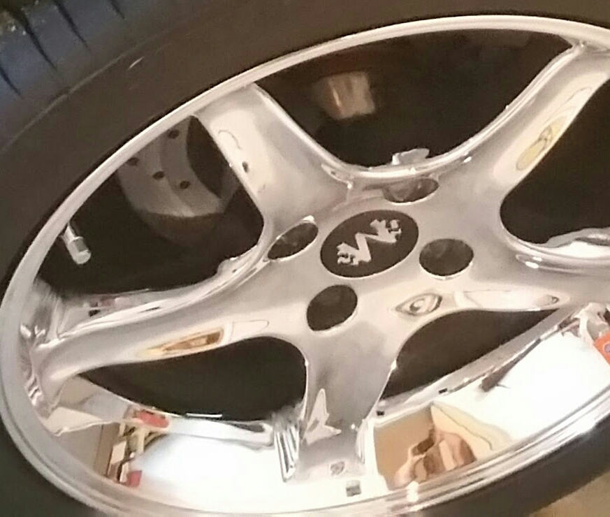

Does anyone out there have first hand experience with c tek drilled & slotted rotors on the foxbody?

Installed last month, no issues. Stops better than stock but you are probably paying more for looks than performance

More show than an upgrade.
If really wanting to upgrade the brakes, a good set of shoes/pads, new brake fluid and quality plain rotors will allow them to work as best as they are gonna get
I've got drilled/slotted on my car and I'll be the first to admit I did it 100% for aesthetic reasons

know that some Ebay and cheaper drilled rotors are actually worse than blanks,, have less friction surface and thus increased stopping distance, and are prone to cracking- plus most shops wont turn them

I did this with the c-tek rotors Great improvement over stock and yah, it looks cooler. The c-teks are only like 20 bucks more than the centric flat rotors so I figured what the hell. Rotors are made in china but the quality is there.
