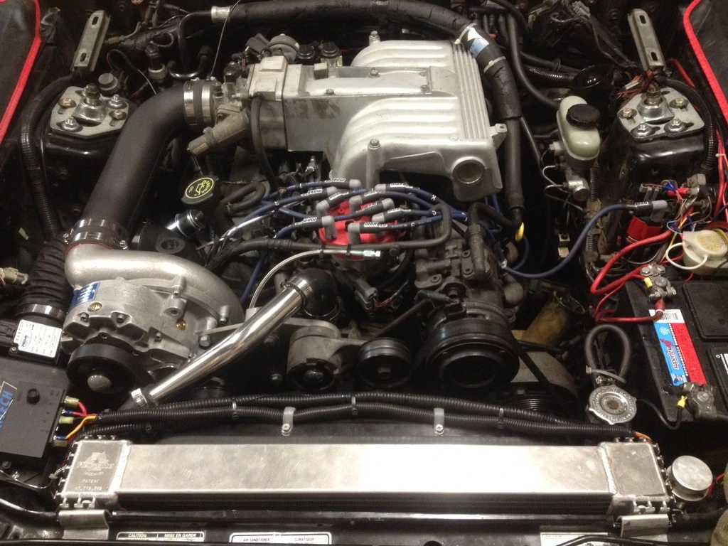

Got more beer. Wife even bought me a mini fridge in my garage for my bday. Raining here again so nothing to do but hang in the garage and continue putting this thing back together. Front accessories are on. Now doing belts, hoses, then upper intake. Love to show some pics but honestly, I like to stare too long at stuff and think about it...... Lots of stuff going on in life and this is just a temporary escape from it all. Jammin on some Black Keys radio, sipping a few and gettin dirty. I suppose the last thing I'll do is crawl underneath and hook the pipes to the headers. Don't know why but I hate doing that.
Reactions: Davedacarpainter
Alive and seems well. Fired right up and smoothed itself out in a few minutes. Just gotta put the hood back on and wait for the streets to dry up. Probably raining all day tomorrow. :(

Thanks man. Just been very busy. Full time job and a private business to run. And family comes first too so after all is said and done, your outta time to play.
I just put the hood back on. I have a radiator leak, nothing big. One of those kind that maybe the gunk will seal it up. The head lifting caused damage to the radiator I think. Blew the seal where one of the tubes is connected to the tank.
Gonna warm it up, check the timing and go for a ride since the sun is actually out. Gonna rain later.
Test driving went well. Outside temp is 80 degrees and it hits 8psi at 6k rpm. A/F ratio 11.3 WOT. So far, just the minor pre existing radiator leak. No other leaks evident.

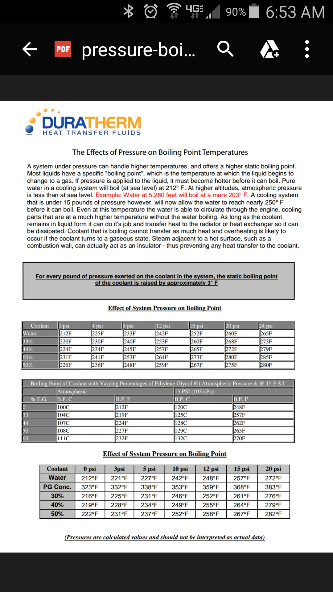

I'm thinking maybe the thing will seal itself. Very small leak and I'm running an un-pressurized coolant system. I got the lower radiator cap seal removed. Coolant freely moves in and out of the overflow tank but remains contained in the system. Huge radiator so it never over heats as long as the coolant level maintains.
May i ask what the reason is? This actually makes the boiling point of your system much lower.
First of all its not going to boil with my rad and fan setup.
I prefer preventing pressure build up since it reduces hose and gasket leaks and failures. This car could probably handle the pressure fine but I've done this trick with alot of success on "beater" cars. And now that I have a minor radiator leak, this helps it from getting worse. It's just a trend I've been on for years and years. On any car I've ever done it, I've never had a catastrophic coolant loss that left me stranded somewhere.
BTY, how much lower of a boiling point does a 50/50 mix have under no pressure compared to what's considered normal pressure?
Found this. Looks like a 16 psi system raises it from about 212 to 252, for just water.
Joe
I wasn't attacking you if that's what you thought . It was legitimate question . I asked because no matter what rad and fan setup on a hot summer day you may see 200 deg in traffic. So only being 12 deg from a boil over point at 14.7 psi or so if your at sea level is just something id want to avoid .
The coolant is gonna want to turn to steam much faster . I thought there was some other reason behind it as I'm always interested in learning and extra ways to keep my car cool . I work on diesel stuff for a living so I thought maybe there was something I hadn't thought of or was missing .
