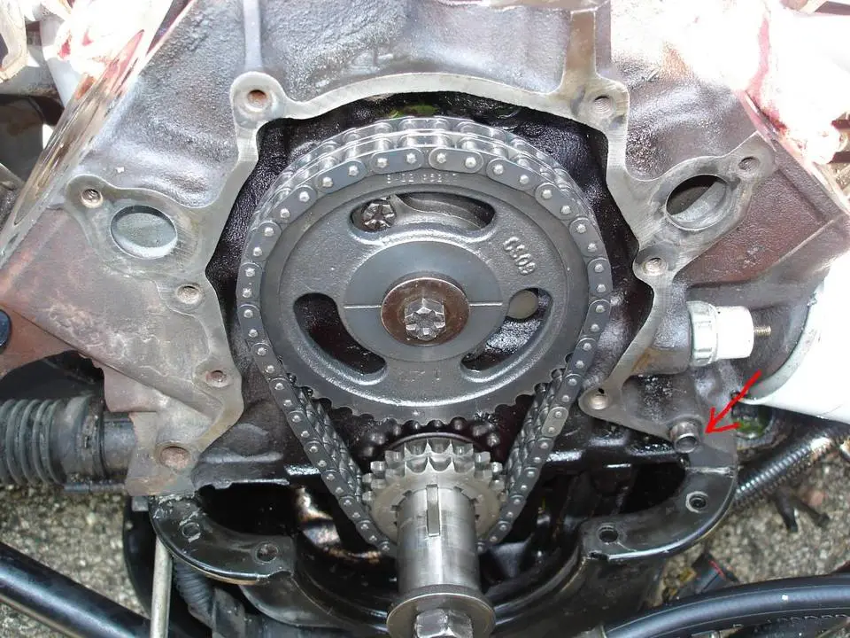

here is a pic of the pin i drop

I think he means one of the dowels for the timing cover, at the bottom corners.
I am pretty sure it's not aluminum, so you should be able to use a magnet to find it. You will need to drain both the front and rear sumps.
Then slide a telescoping magnet around until you hear it tinkling around. Get it to the front sump and remove it from the top.

I think it will work too. But I dont know if the dowel is steel or aluminum. I thought I remember seeing some rust on one of mine, so I would assume it's a normal alloy steel, which will stick to a magnet well. Stainless steel will barely attract a magnet because of the higher chromium content. Good luck.
