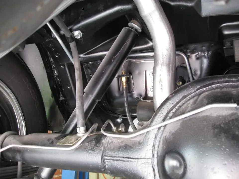

NOTE I SHOULD HAVE SAID EARLIER!
If you convert a 64-66 to dual exhaust, you must alter the rear brake hose/line setup, or the brake hose will rub against the LH tailpipe and kill you. I'm not kidding. You'll need the axle lines, dual type hose, short hose bolt, underbody bracket, and an extension for the brake line, unless you plan on replacing the whole line. Most everybody offers the hose and axle lines, the bracket is a bit tougher to find, and there's only one source for the extension.
