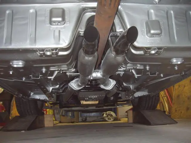

I had dumps on my exhaust before, and just picked up 2 turn down extentions from Advanced, and mounted them on a 45 degree angle so they did not blow up so much dirt on the road, and direct the exhaust towards the sides to reduce chances of it getting into the car.
