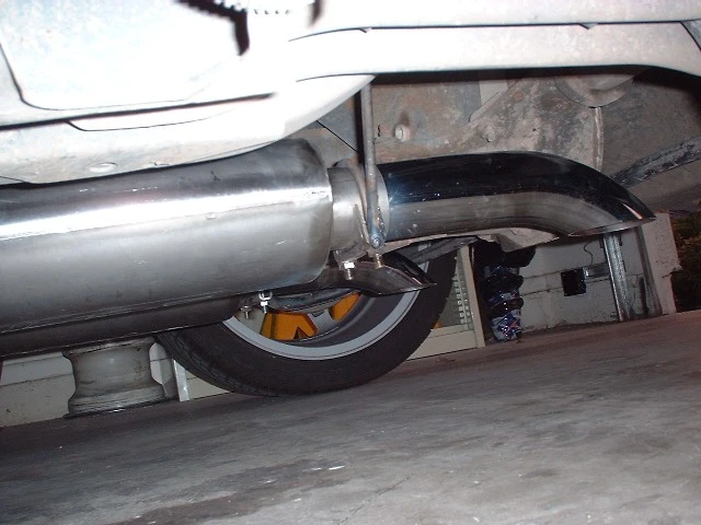

My Mac's are dumped and its an incredibly distinct noise. Doesnt sound like anything else and I like that.
The pipes come directly over the rear axle and dump, plus if I want I can hook the tails back up. It still sounds good, but its not loud enough for me.
Inside:
http://youtube.com/watch?v=0tSnKl4Ccs8
Inside:
Your just missing your tailpipes. Real dumps are dumped before the rear axle.

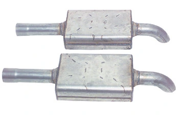

i had the 2-1/2" mac prochamber dumps, and loved them. Then I got a 3" mac catback for a wicked goos deal that I couldnt pass up, so I put that on my car. since then, I have gotten rid of the 2-1/2" dumps.
I MISS THEM SOOOOOOOOOOO MUCH
they sounded so much sicker, but not as loud as the 3" catback. Now Im gonna get rid of this catback, and buy the mac 3" dumps. hopefully they will sound sicker than the 2-1/2" dumps.
and plus, dont deny it, my car's @$$ looks way sexier with no tailpipes.
also, i love the people who thought it was a v6 cuz it had no wing or dual exhaust.
