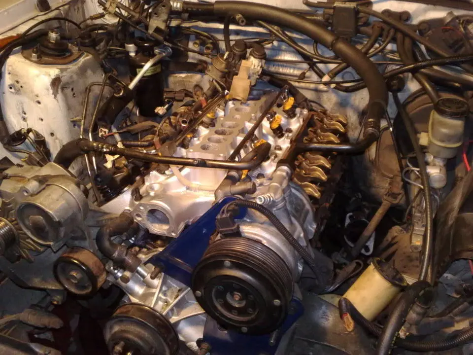

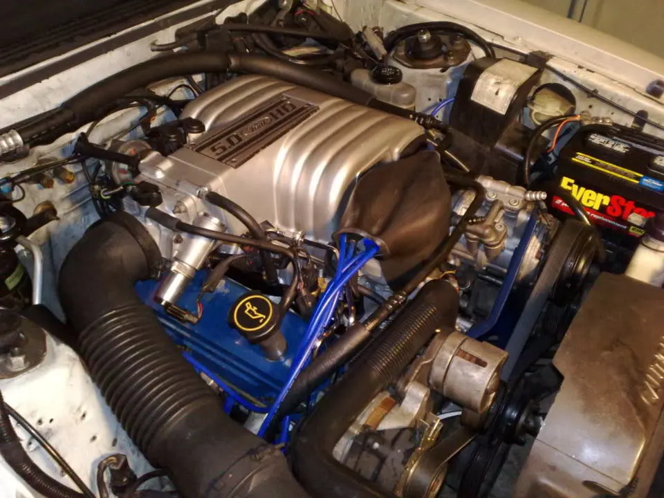

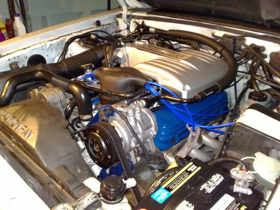

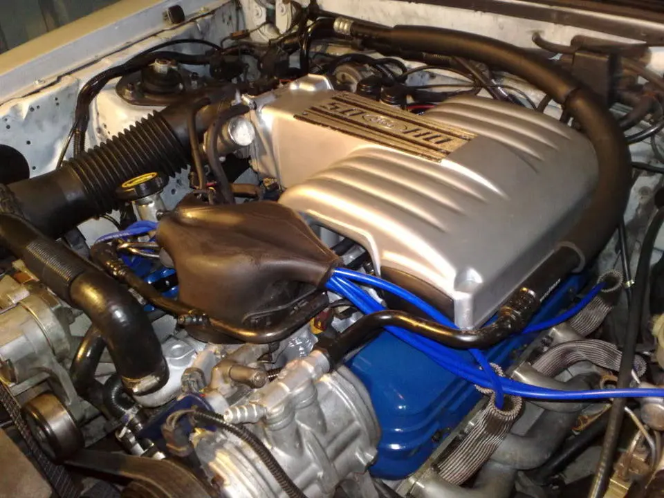

Just an update, got the car mostly back together. Just need to put the valve covers and upper intake on. I was going to try and finish her today, but I forgot to buy valve cover gaskets. :nonono: So, its back to the parts store for the billionth time. :rolleyes:
Update pic.
Complete head swap and porting the intake. The porting guides weren't kidding on how much material you remove to get the factory intake flowing well. If you look at the drivers side header you can see the taylor boot protectors. I also threw in an exhaust video. :)
As far as performance. The car pulls much harder 3.5k+ rpms. It use to fall off around 4000-4500 rpms, and now it pulls hard all the way to 5500 rpms.

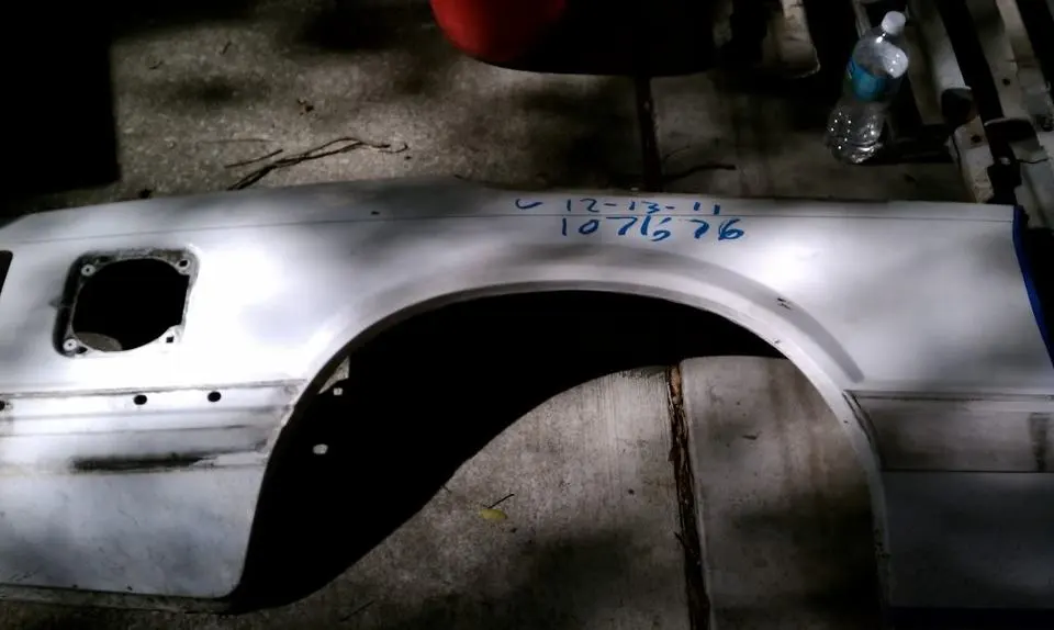

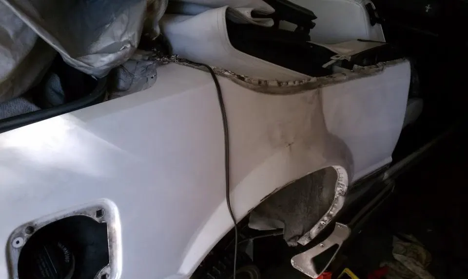

It has been a while since my last update. Finally got around to replacing the rear quarter panel on the fox. Found a match at the local u pull for $34.99. Now I just have to remove the rest of the spot welds from my quarter panel and the replacement. Is it just me or did a blind monkey spot weld these panels on?
Mostly removed Old Panel with Damage :
New Panel:
