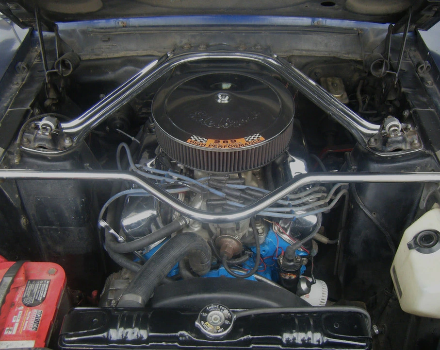

Your setup sounds pretty similar to mine, here's how my engine sits in my 68. I'm using a Performer RPM intake if that makes any difference to you

EP I can place my air cleaner like yours (although I have weiand 2-plane intake).
Yet the cleaner does not clear the hood - your cleaner may be a bit smaller (in heigth) all I need is 1/8"+ of additional space.
