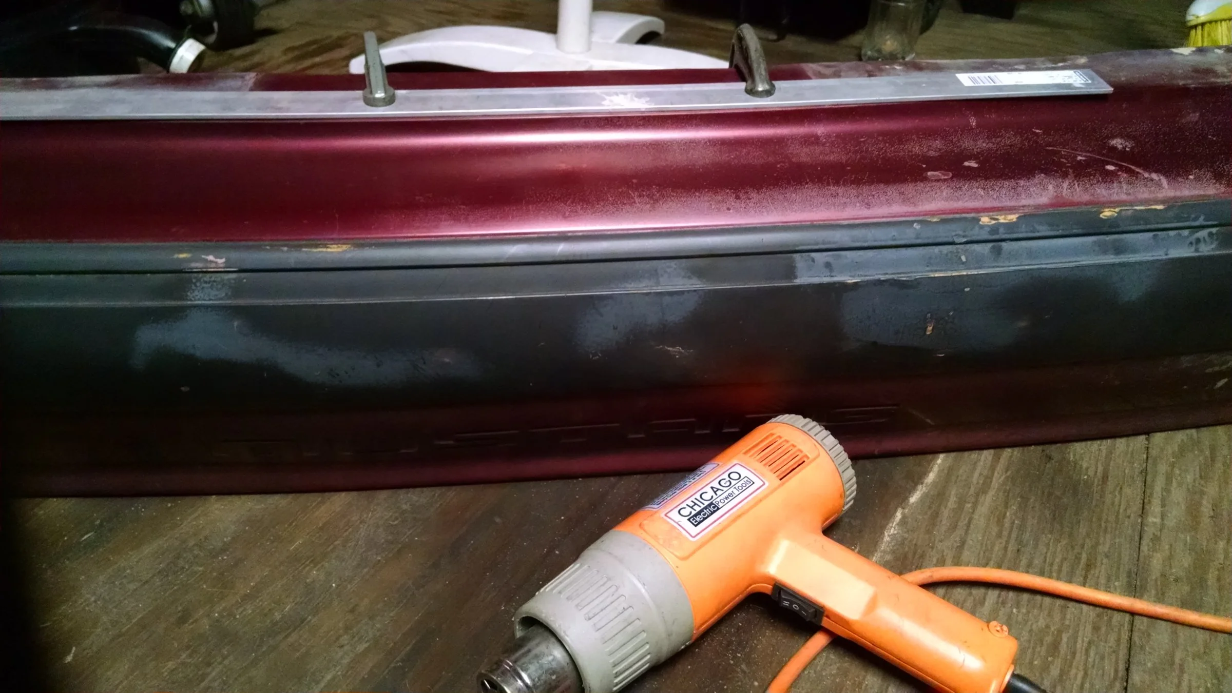

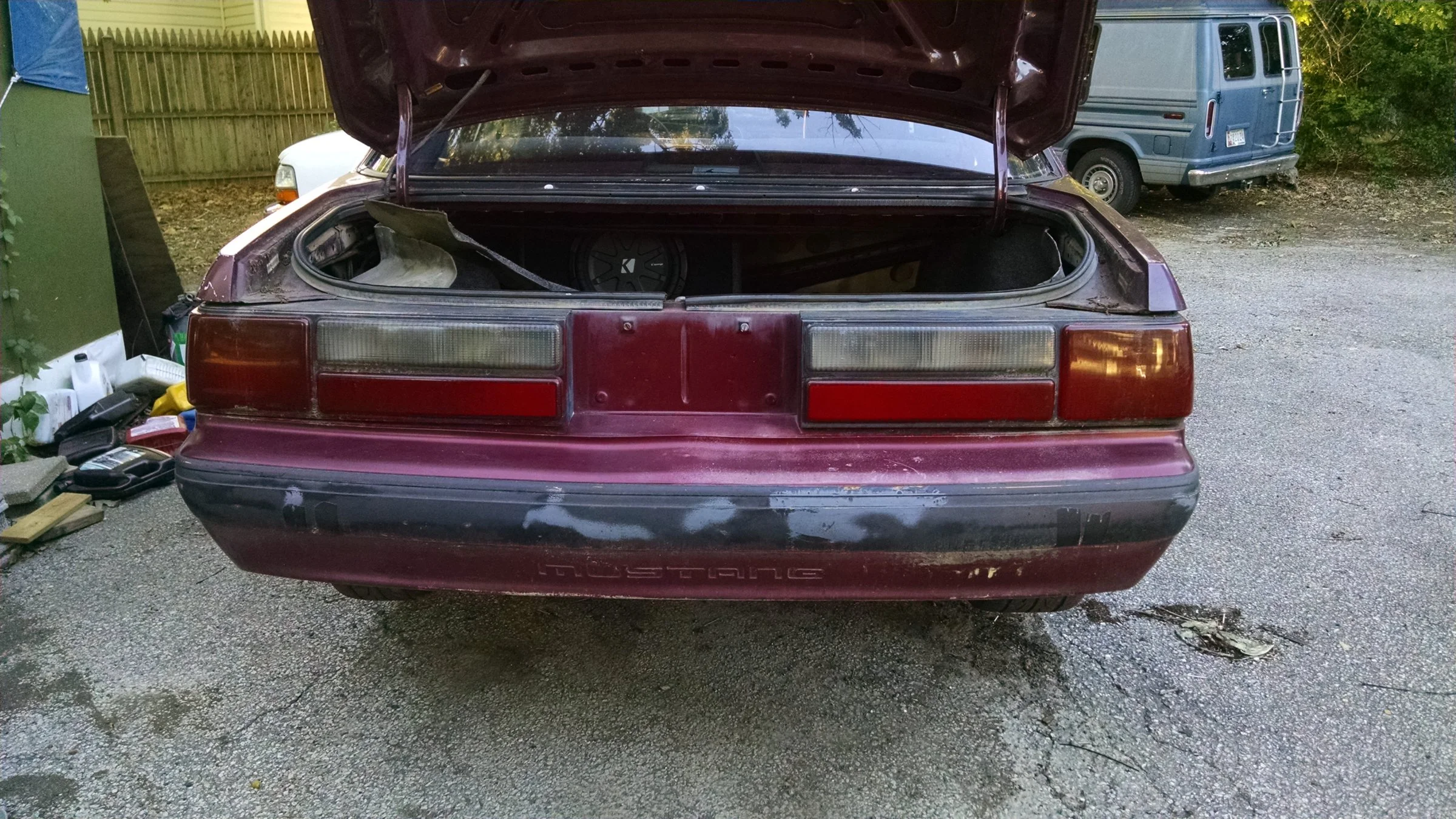

I'm sure you guys can see the waves in my rear bumper below the tag space.
I couldn't live with that so I've contemplated for months on how to fix it.

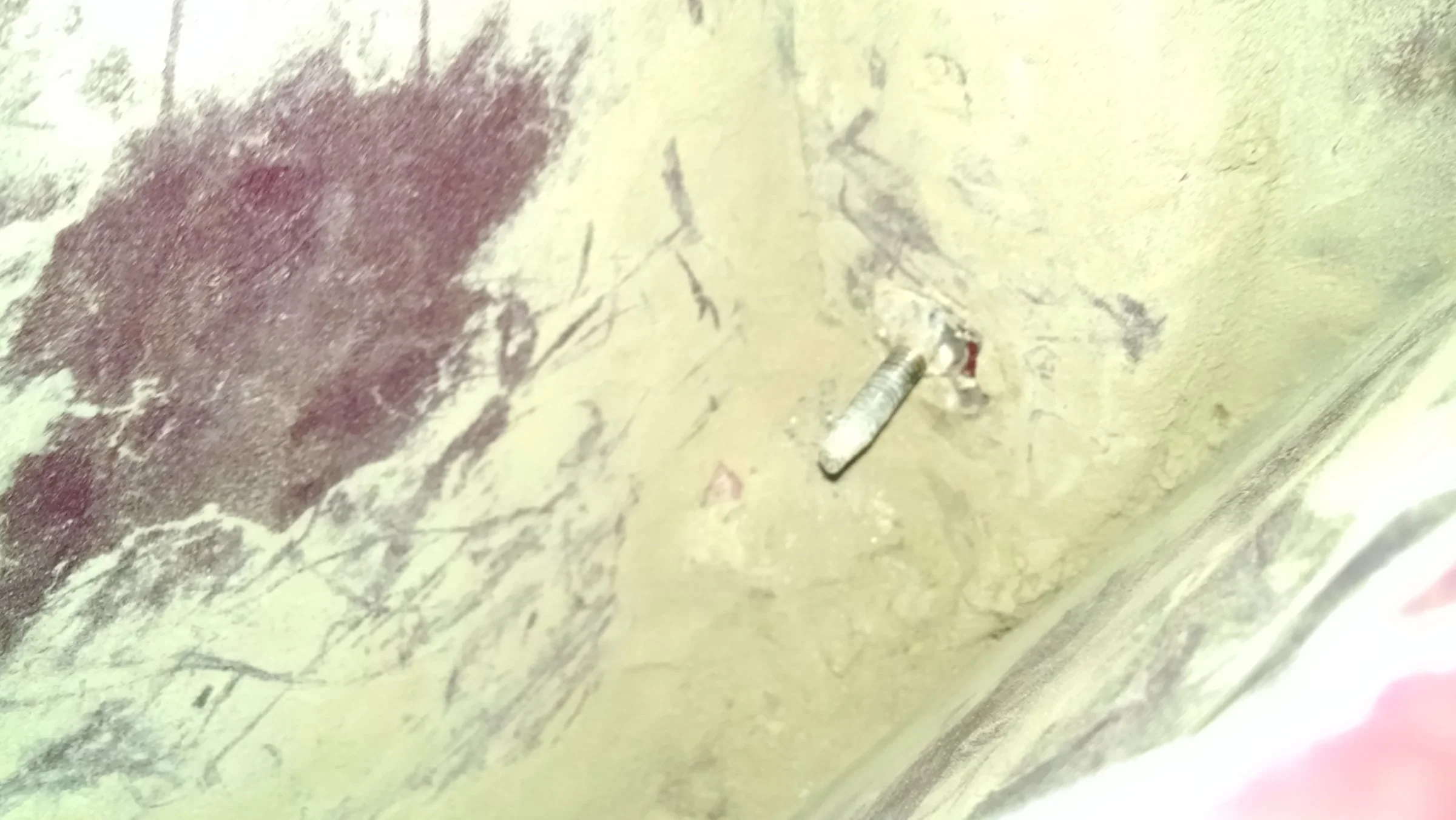

This nut buried in the side of the trunk by the fuel filler neck was a PITA !!!!

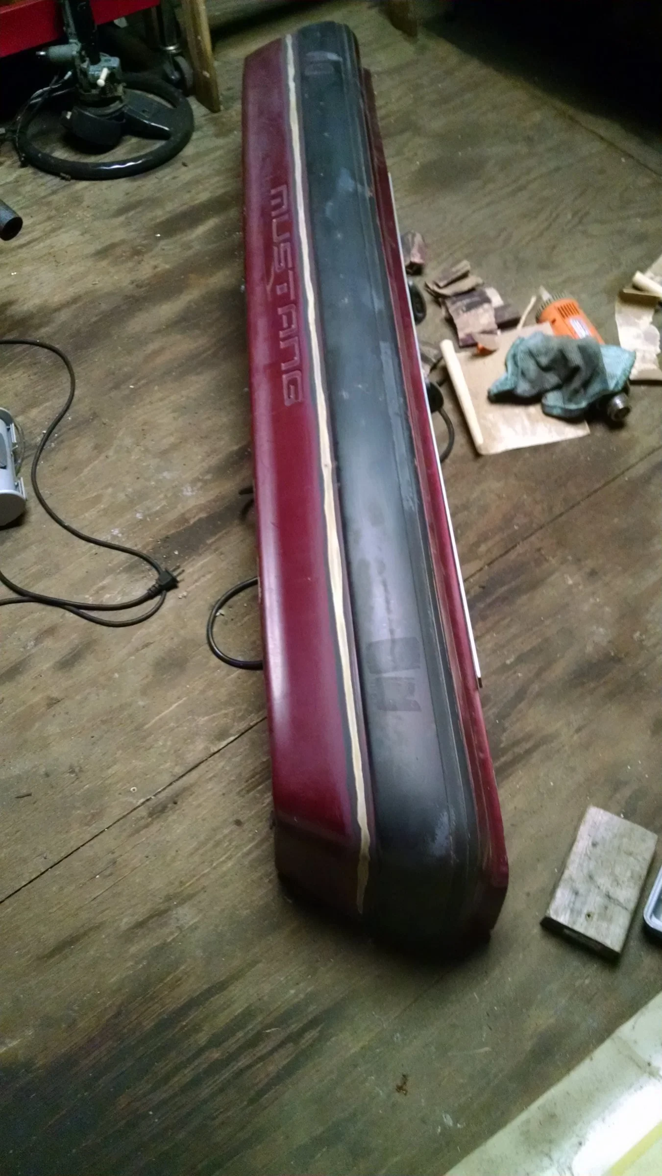

Back to the job at hand.... Straight as an arrow thanks to HF
Still straight when you pull the clamps off then?
I'll have to do a form of this for Robby's rear bumper when I bring it home. It had a tree that grew against it and heavily dimpled the left side.
Reactions: 90sickfox
Yup. There was a small wave the first heat cycle. There's a flat bar underneath, too. I heat cycled it two more times and it was straight, but I'm leaving the clamps on till I get off tomorrow. A little extra time clamped up can't hurt it.
The biggest thing was the huge bulge in the center. Heated the hell out of my knee and my finger tips. Lol
That thing stuck up about 3/8 an inch. Glad its gone.

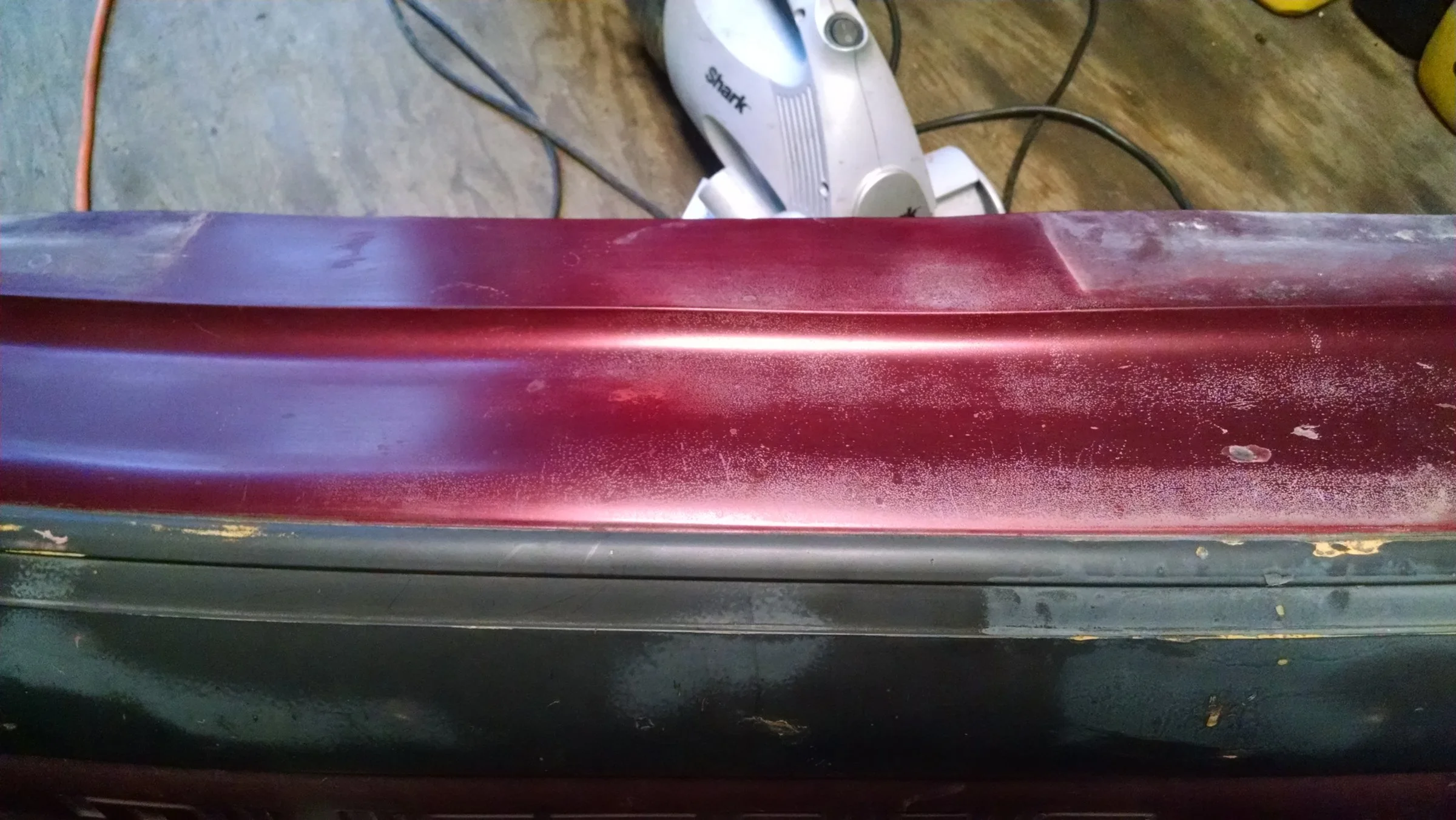

Started sanding the edge of the bumper....still had a very small wave so I've got a little more heat forming to do.

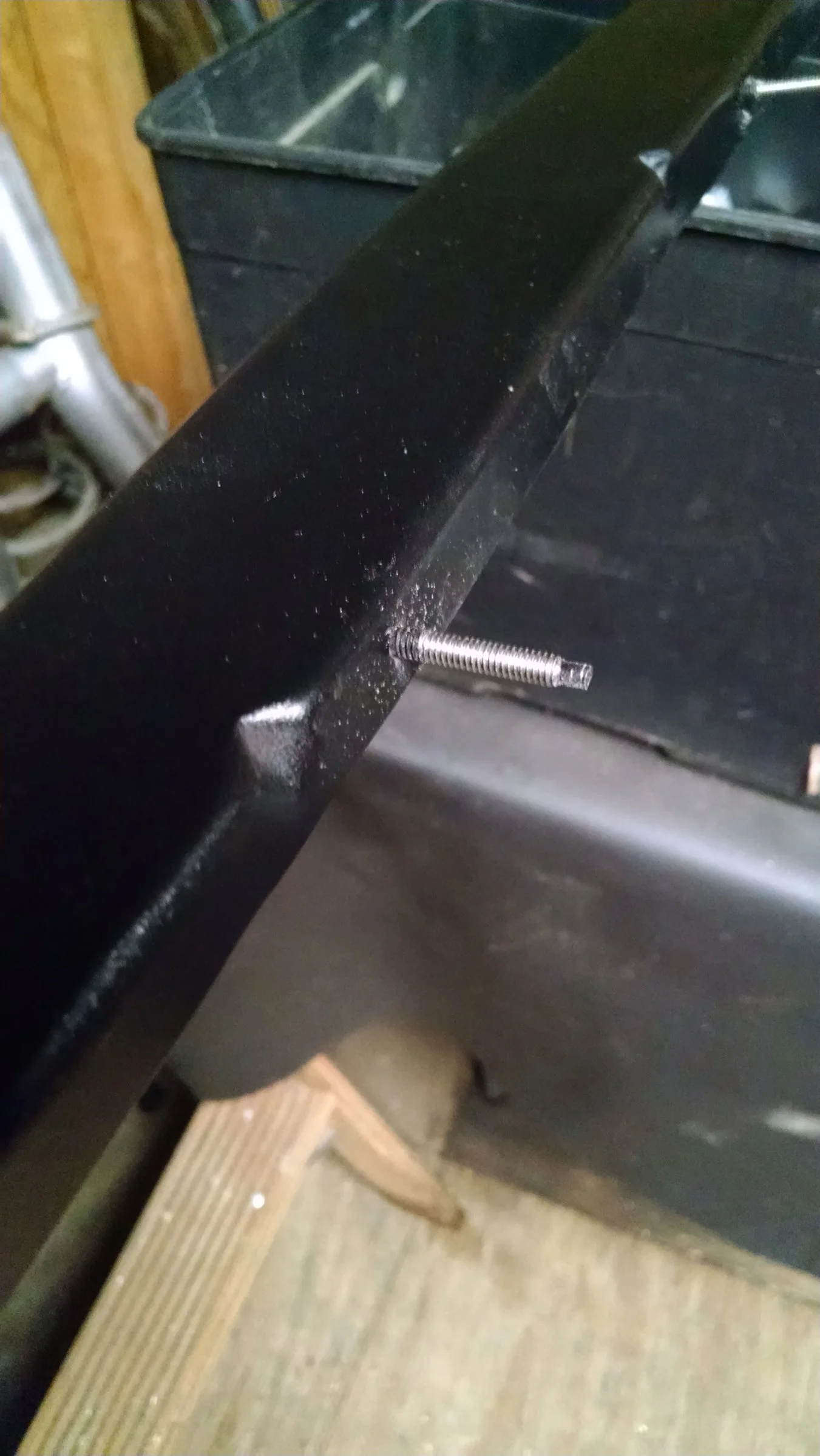

Ran a tap through the nuts and chased the threads on the brackets.

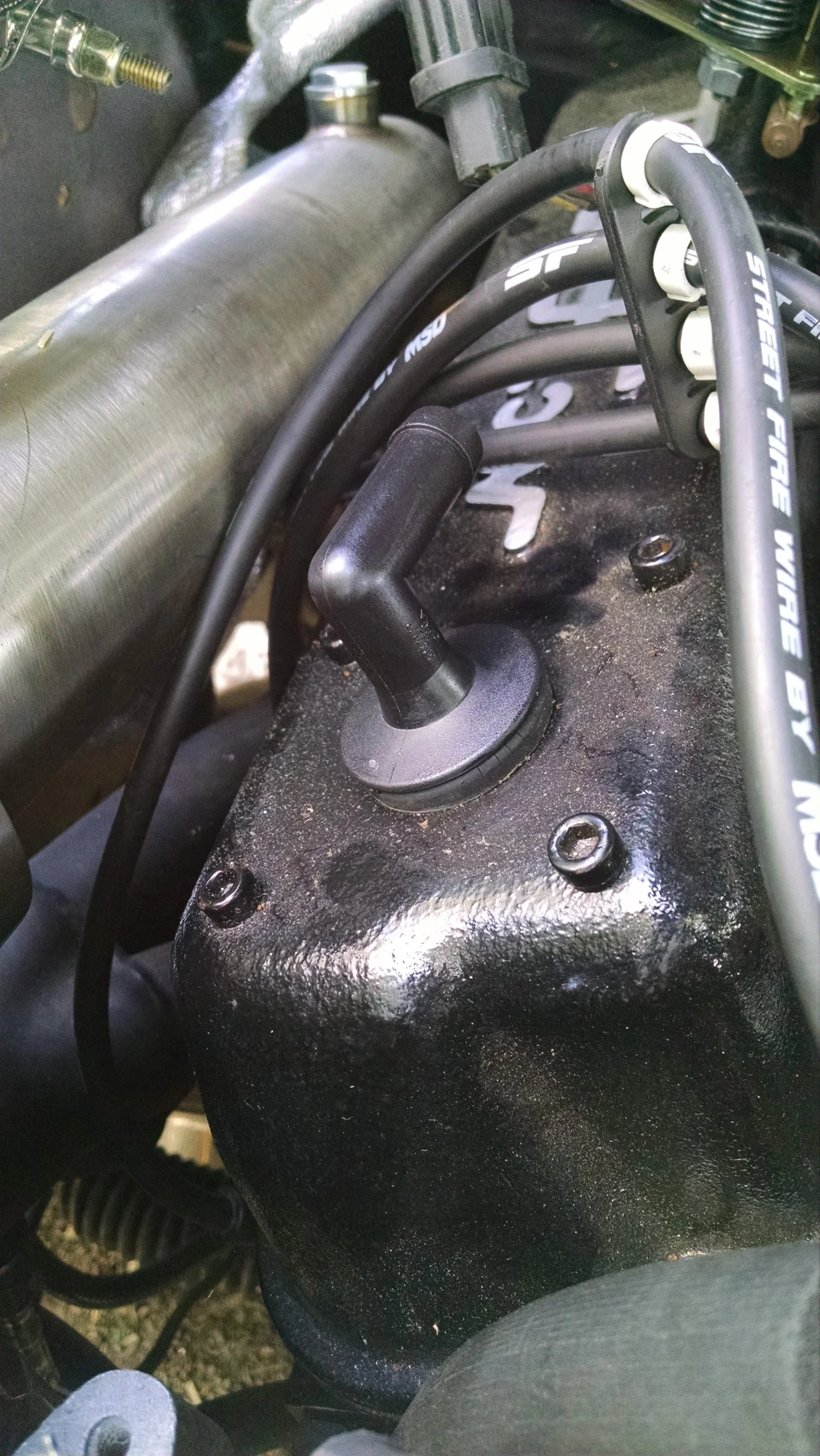

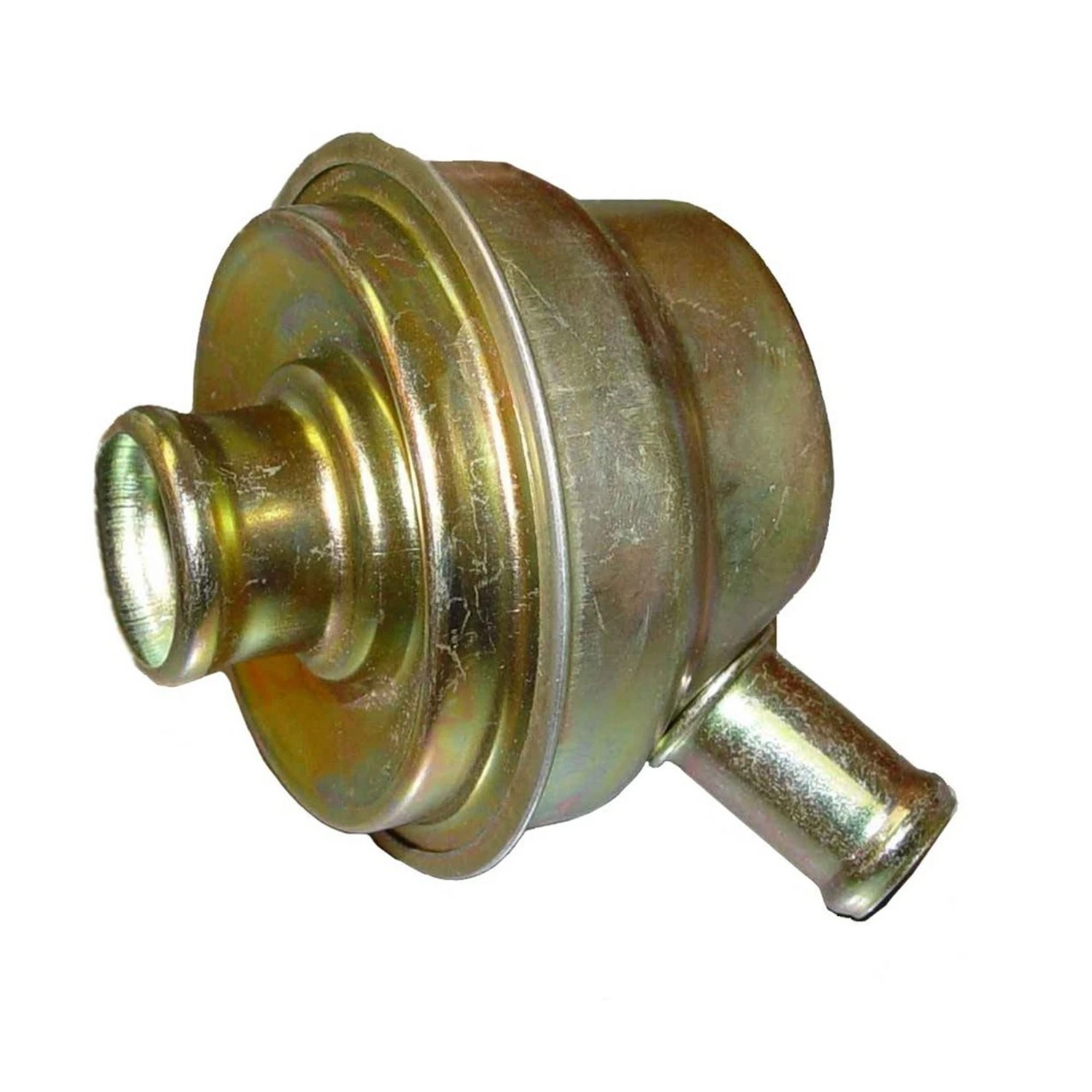

So....taking much needed advice I searched the junk yard for a dodge or jeep 5.2 to get a breather. The only one I found was completely clogged with carbon. It looked like this.....
I went to advance auto and found a plastic elbow but they don't carry the metal breather....any objections to using this plastic POS ?

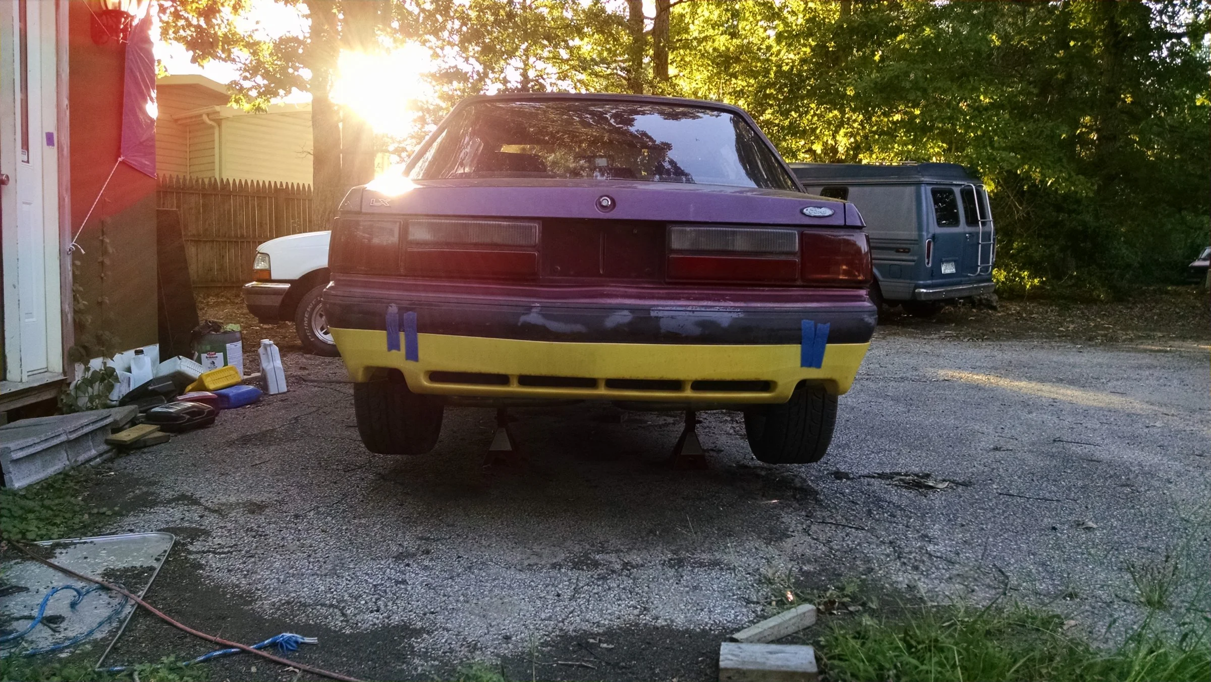

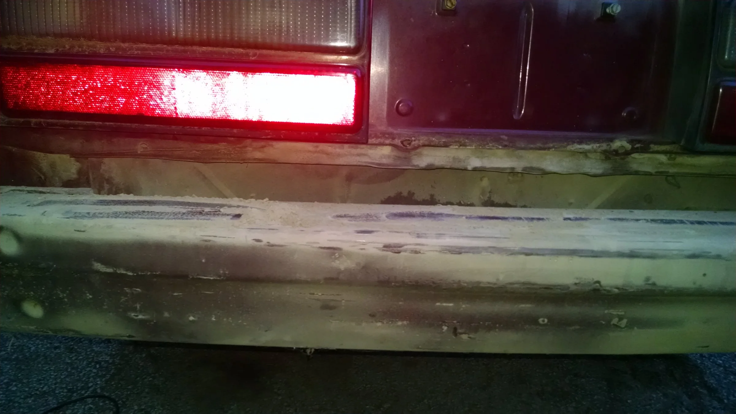

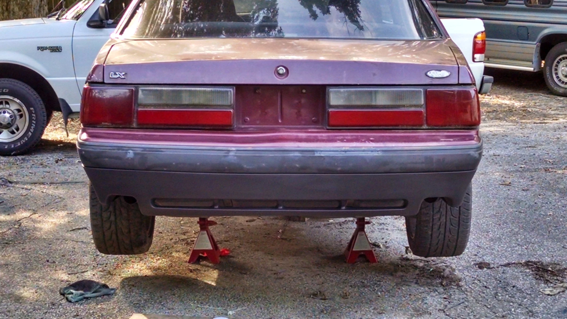

The back bumper is on....but I have bad news. The sun was beating on the back bumper an the wave and hump came back. All the time I spent heating and massaging this thing are for naught.

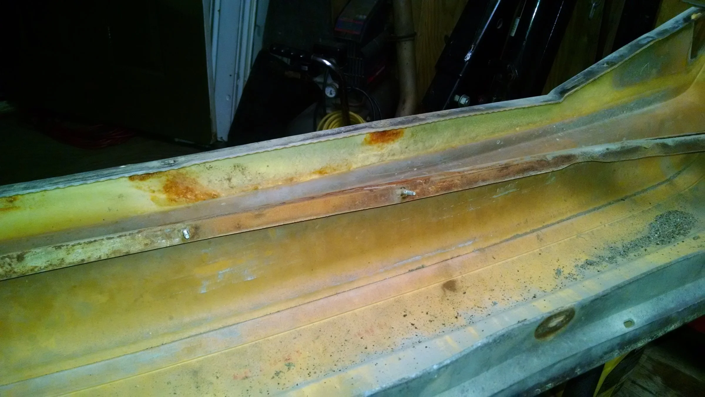

I used the epoxy and 1/2 3m tape. A little sanding, prep solvent, adhision promoter, black primer, and BAM !!! An imperfect bumper for a imperfect car.
I'll figure out something to do with the bumper at a later date. Too much stuff to do....so....its on the back burner for now. Smh

Just for the the record....the heat on bumper thing has worked for me many times in the past. I think the problem here is that its been out of shape for so long that the plastic has memory to that shape. Usually, a plastic will automatically want to return to its original shape.
Who knows how long this bumper has been f'd up. I've got an idea for it. Just has to wait.....for now. Unless @Davedacarpainter has any ideas.
Reactions: Davedacarpainter
Here's what I see, the bumper almost returned to the exact same shape it had before you heated it.
What would cause this? It's the plastic memory of the piece. At some point when the original warping took place, either some heat helped to shape it in the stretched position, and/or the bumper sat for a long, long time in that stretched position. I'm betting the second. The plastic has had enough time, over the years to have the molecular state to relax into that position.
You have tried to cause the plastic to reshape through heat into what was the factory position. As you have found, it returned to the stretched shape.
What you need to do to change this is similar to stretched metal. You need to shrink it. Just like metal, the molecules need to be reshrunk (you need to beat on it while you have your bar underneath it and are using heat.).
You'll actually be beating the plastic molecules into an original tighter formation by doing this. Once you have done the shrinking routine, let it set for a week with the clamps still on it. This should take care of it.
You understand what I'm saying though, right? Just like taffy, it has been stretched beyond it's original formed shape. So much so that it has formed into a new shape. Once the plastic molecules have had time to relax into that new position, they'll try to return there unless they have been beat into a new shape forcing their molecules closer together again.
So, it's takes more than just heat and supports on old plastic. It takes a type of forging, so to speak.
