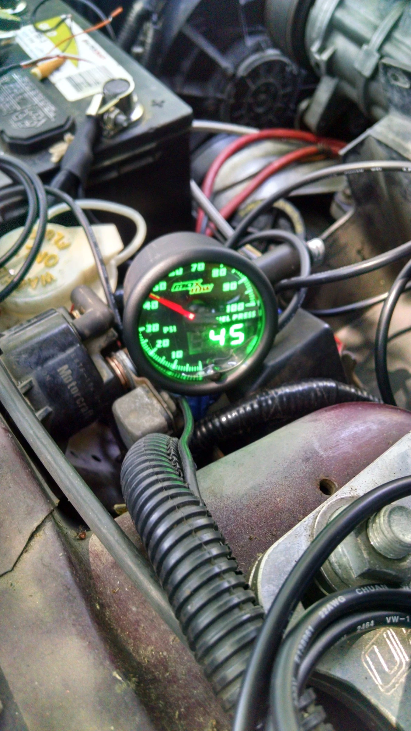

My max tow electronic fuel pressure gauge arrived today.
I didn't mean to order it but... wtf...guess I'll use it for now.

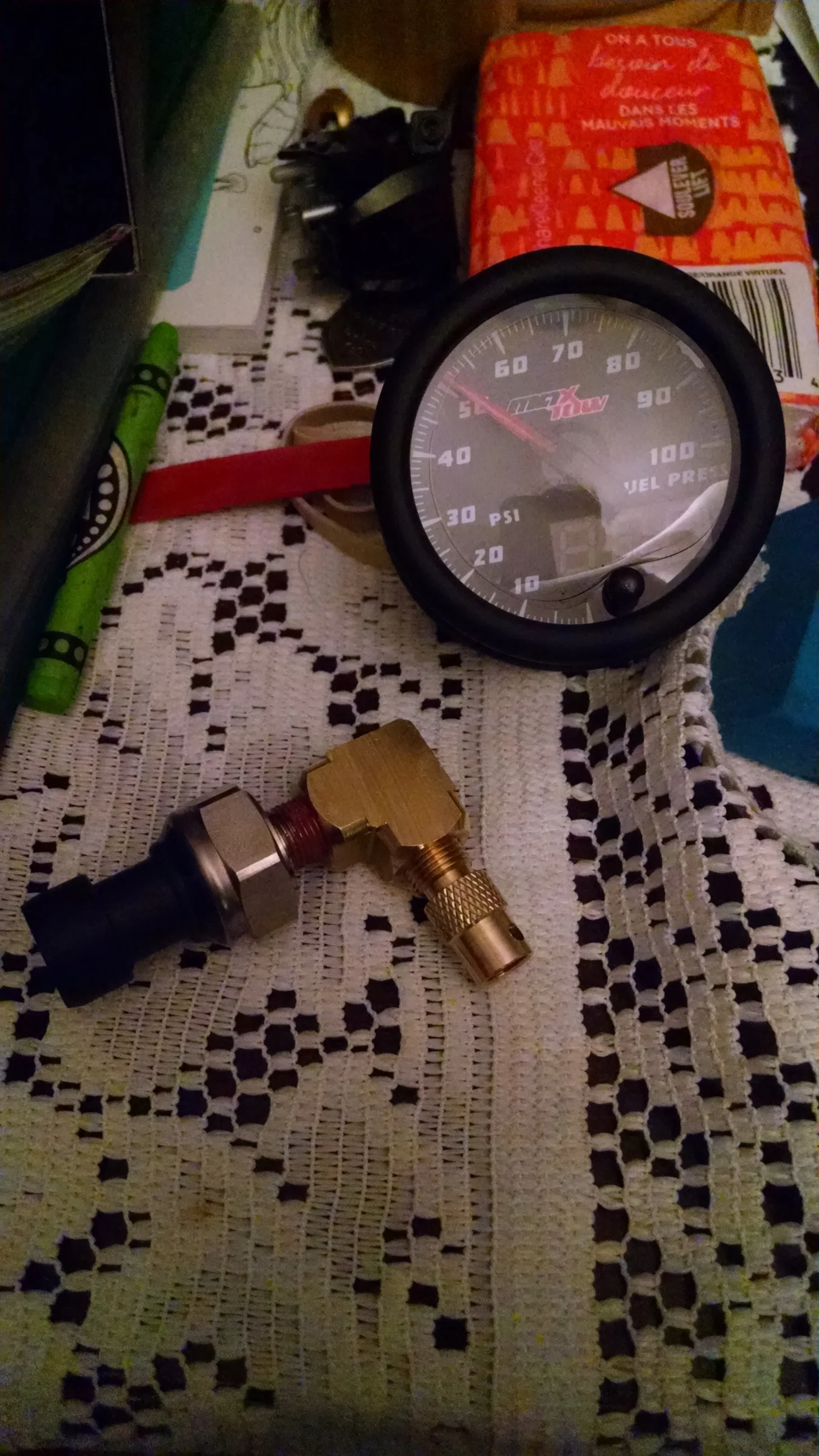

It won't be too bad. Had to make a mad dash to Lowes for fittings. The sensor is 1/8 pipe thread. I got a female 90 degree street elbow and ran over to the air tool section and found the right adapter for the schrader valve in a blow gun kit.
In comparison to that crayon-that gauge looks huge.... lol, but I really like it. How many dollars is that little fellah?
Also- genius on the air tool fittings

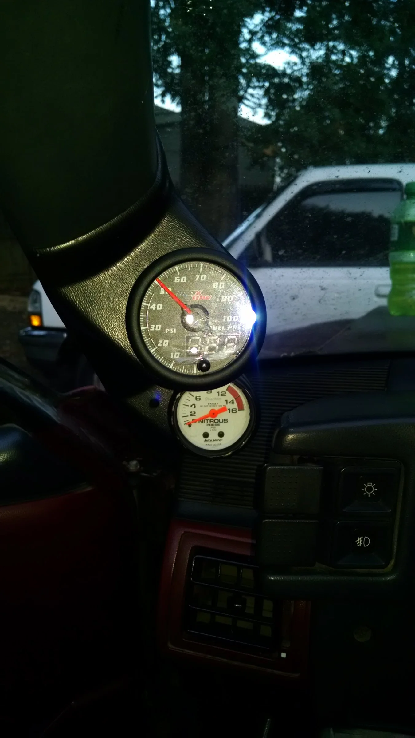

It was 96 bucks shipped by Amazon. Its a 2 1/16 gauge so its not big at all. It'll fit nicely in my A pillar gauge pod....over my nitrous pressure gauge. Or maybe I'll break out my center vent pod but I think its made for 2 5/8.
I don't know....it'll go somewhere.

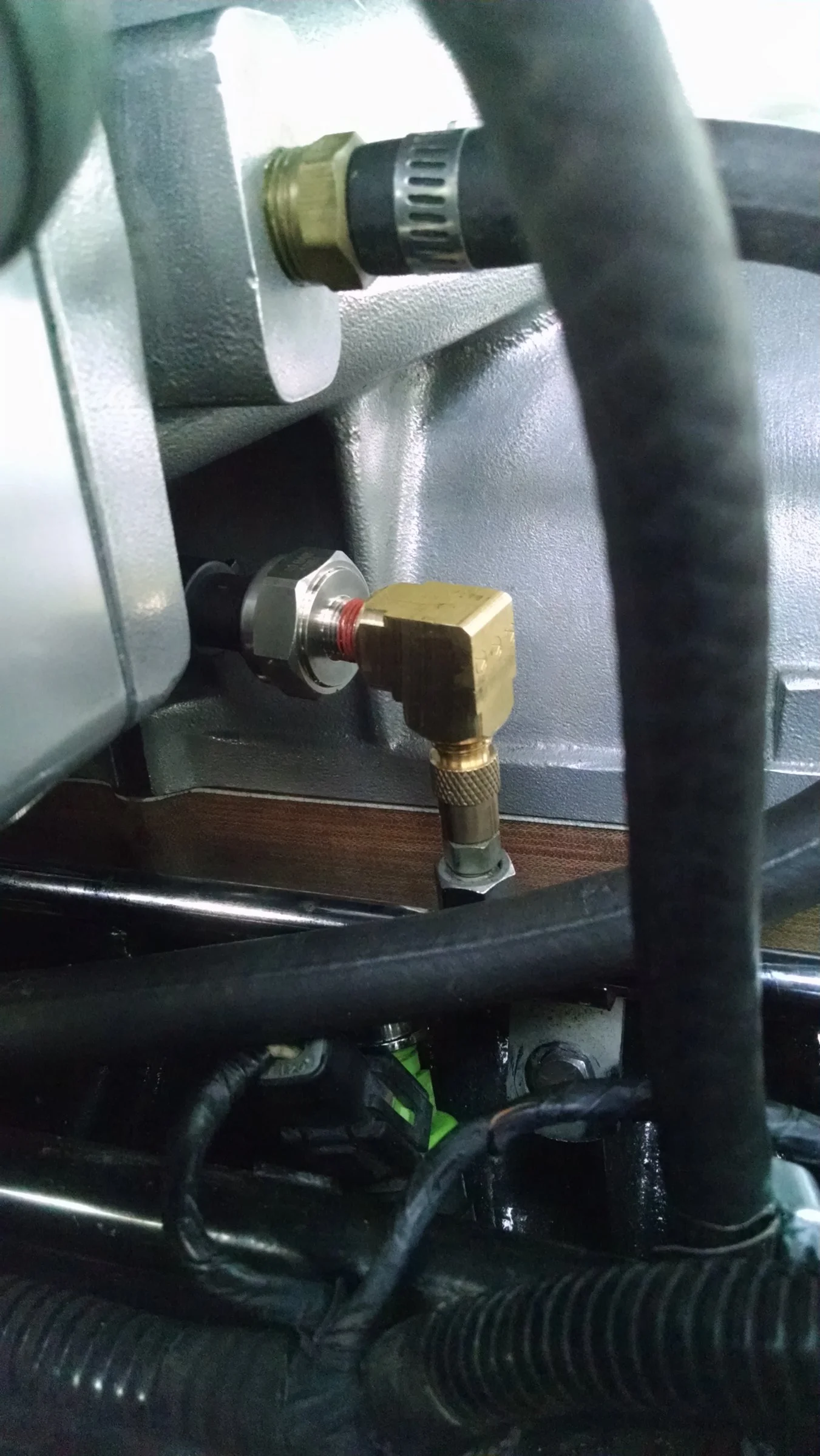

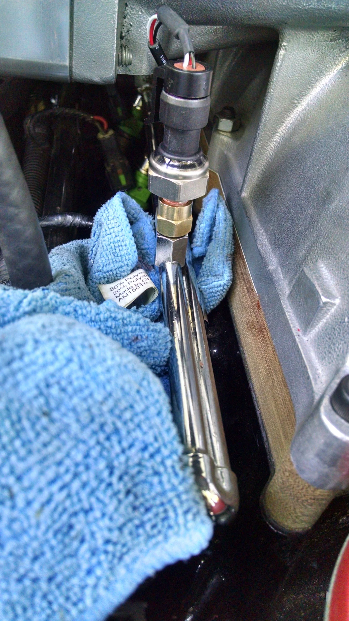

I sealed the fuel pressure gauge fittings and found a leak on the flared lines. FPR came set to 10psi.... So I pull the line off and tighten the holy hell of o it. Hook up my pressure gauge and cylcle key on....10psi...adjust.....18psi....adjust.....25psi...no leaks....adjust...32...no leaks...adjust...cycle key....ppppsssssstttttt. The fitting that I was called a genius for was spraying fuel all over the damn place. Gotta rethink this fitting thing.
I'm going to try jbweld on this fitting....I've used it to fix a lot of fuel related things. Seems like it just pushes anything else out of the threads. The threads have felt a little loose in the adapter ( just a little ) . under 40psi its enough to push the fuel around the threads. We'll see how this works.
Reactions: RaggedGT
It didn't work....those fuel gremlins are pissed the hell off now though.
I ended up using a piece from my oil pressure kit....the end that the compression ring goes on kinda fit.....a little elbow grease and at least it doesn't leak.
Lesson today is don't go out buying fittings....over thinking everything and ending up pissed off. Go in the shed....dig through ish....and make it work.
No one makes an adapter to fit locally....so I spent 20 bucks just to find out I had what it needed in the shed.
