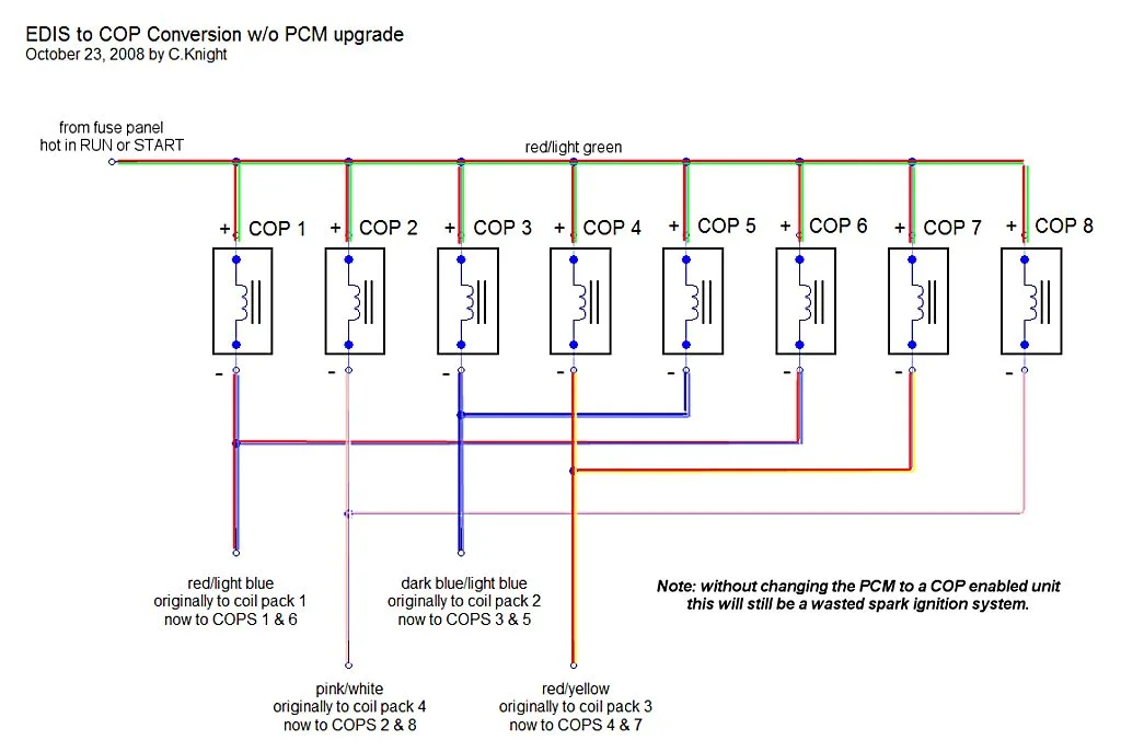

I found this little bit of COP info...
Yeah but that's not true coil on plug,....It's just EDIS wasted spark spread out all over the valve covers. If it was COP, each coil pack fires it's own independent signal i think.
You are correct... I don't think coil on plug would fit my application, but its interesting none the less.
Its a lot easier to find a way to mount 8 individual coils vs. 2 big blocks that call themselves coils.
My coils will have to go somewhere low...either frame rails or beside the pan...that makes me a little nervous if I get caught in the rain ( like mustang week 2012 on rt.17 ). Kinda like the ECUs on newer mustang being below the kmember. WTF.
Edis is wasted spark I believe.......:shrug:
It's wasted spark...COP would be to mount them in a different area. The box coils are bulky and look like they belong on a Ranger.
The coils can be wired in wasted spark configuration. They would still fire each time the piston pasts TDC.

So...COPs can be CNPs if you put a spark plug wire between it and the plugs. What if they're in the trunk ? Are they still CNPs ?
Wasted spark fires two cylinders at the same time...but one is just teetering TDC on the weee hair into the power stroke...the other cylinder is just crossing over from the exhaust stroke into the intake stroke. Therefore, wasting a spark on that cylinder.
Electronic Distributorless Ignition System = DIS ie; tomato- tomatah. Lol
The same wiring for COP is the same wiring for CNP. They are both coils...and many are the same type internally.
Direct Coil Control is big moolah...I'll leave that to the street outlaws.
EDIS8 is an easy mod for more precise timing control.

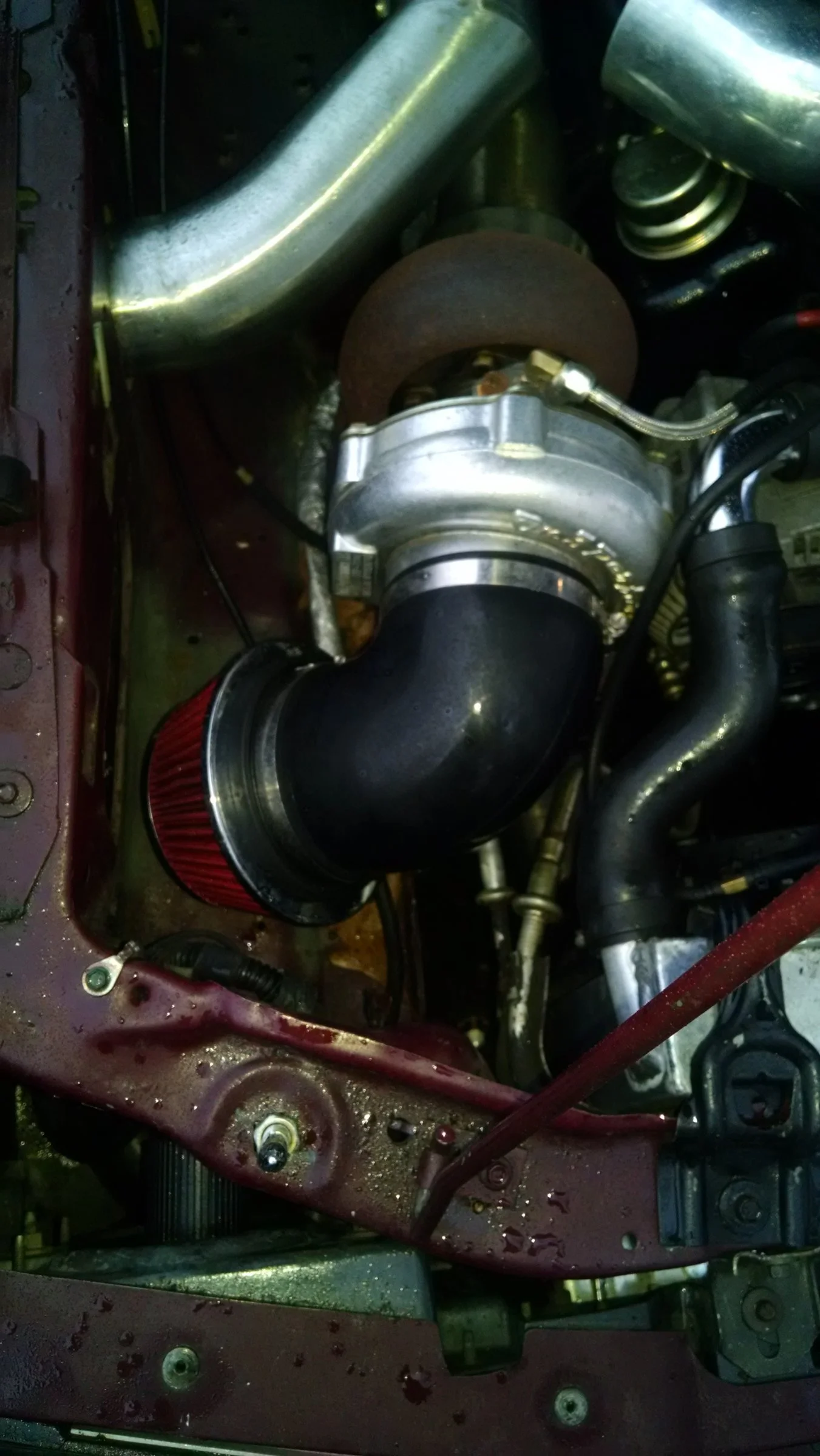

1. I replaced my broken dipstick- The replacement is a little shorter and is full at the add line ( I can live with that )
2. The air filter got replaced with a shorter filter. I searched and searched for a suitable K&N but came up short. I ended up buying a Spectra short filter. These
things don't play well with turbos. Apparently, the issue is with the metal cup in the center being epoxied on from the inside. When the heat from the turbo
softens the glue separates from the cap causing metal to fly into the impellers. The way I plan to fix this is by drilling a hole in the cap, fabricating a bridge,
running a long bolt through it, and lock nutting it onto the filter. The bolt should hold the cup in the filter .....unless the nuts come loose...then my turbo will eat a
bolt....or... I could always tack weld the nuts on the bolt.

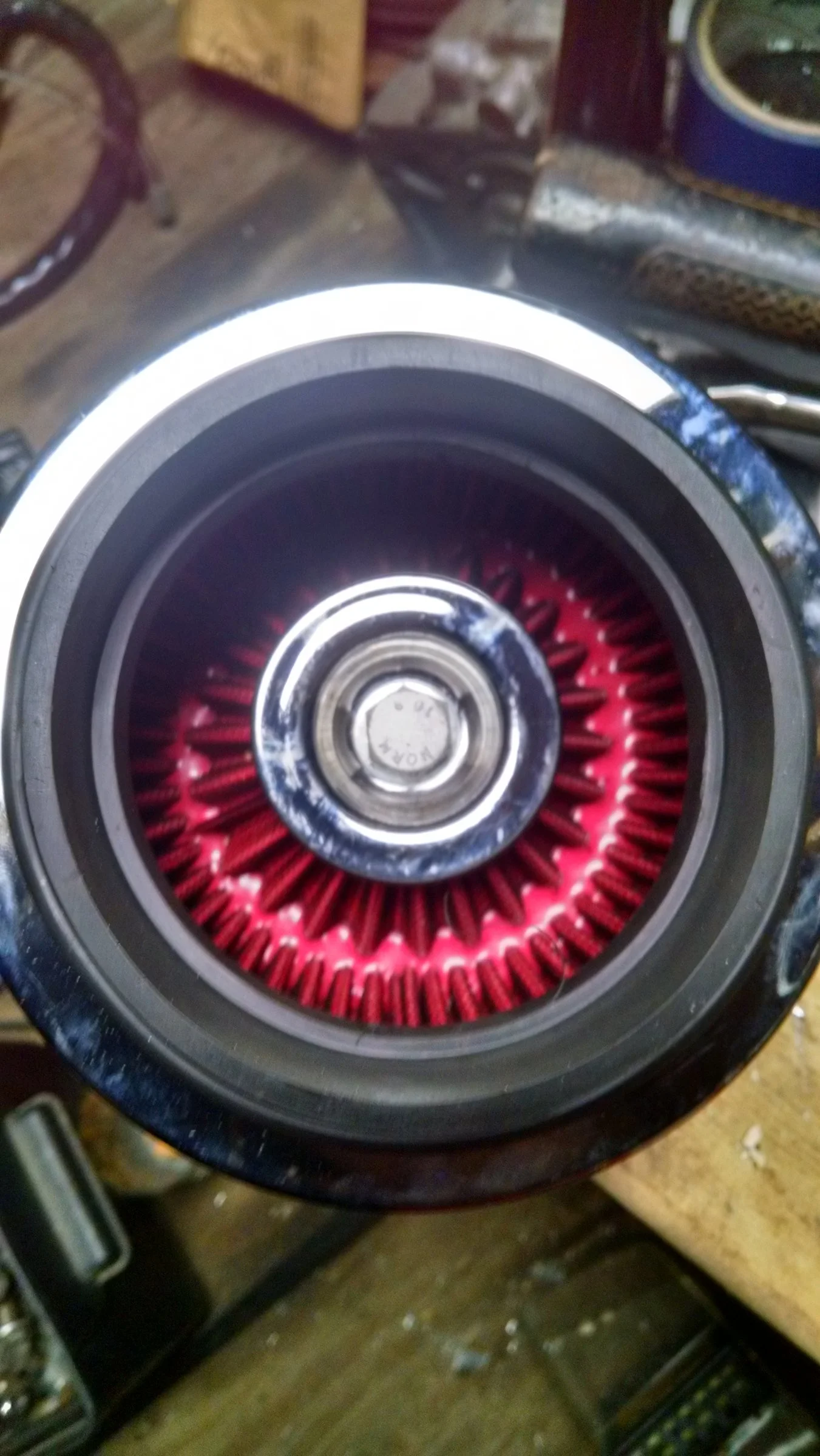

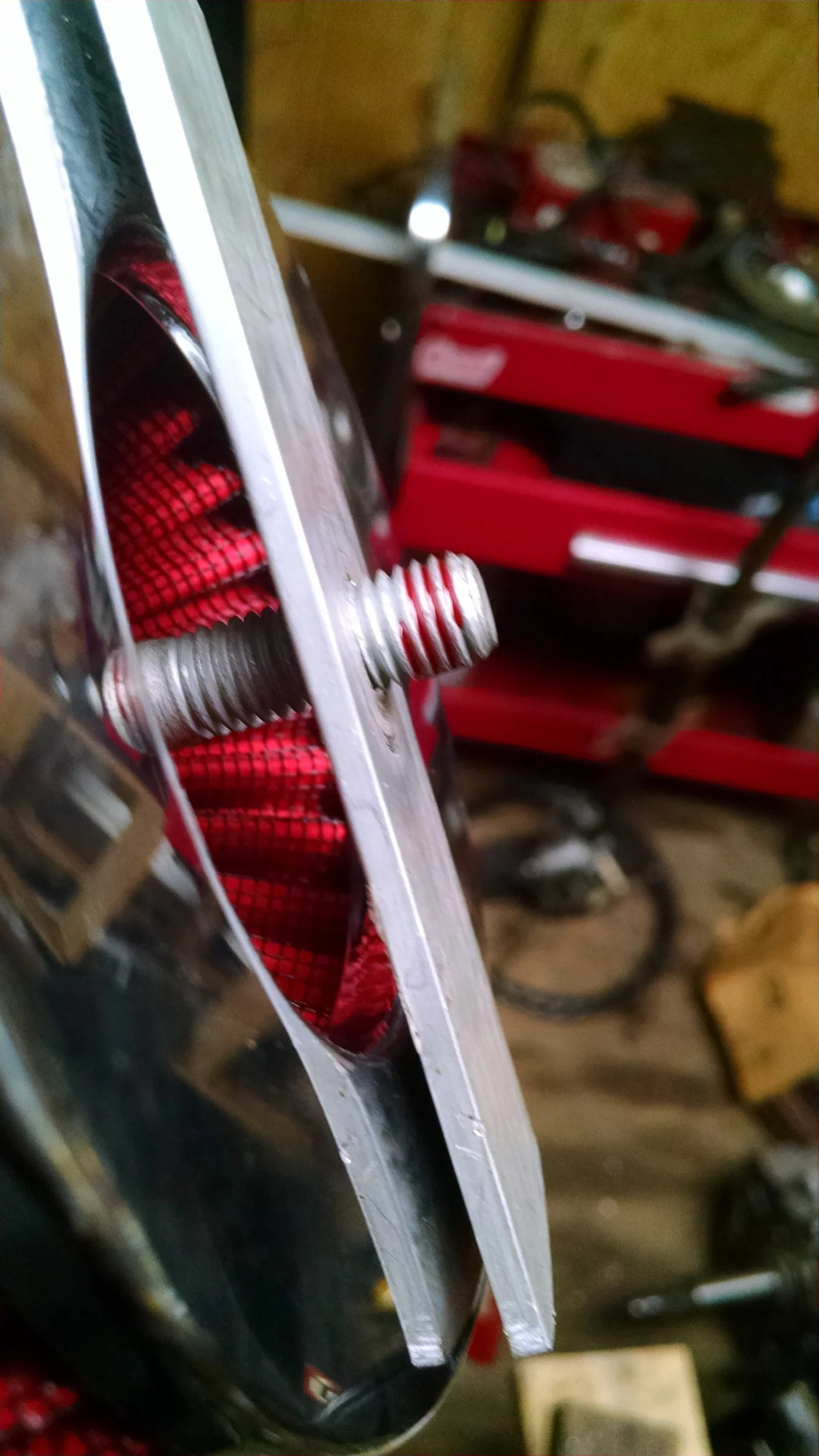

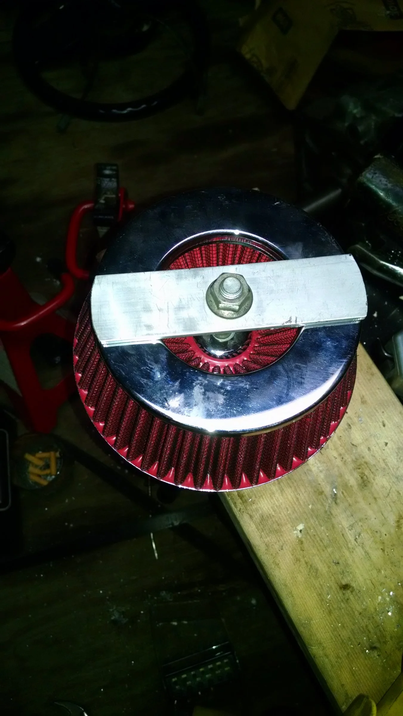

The filter issue with Dusty has been mocked up a different way. It will probably stay this way until I notice issues. The filter still will get a bridge to hold the metal button but that'll come at a later date.
Figured I'd show this little modification. Maybe it'll save my turbo....or maybe Dusty will be eating a bolt.
I drilled through the notorious metal cap and ran a bolt through it to a bridge over the front of the filter. The nut is red loctited to the bolt ( I may tack weld it on later ).

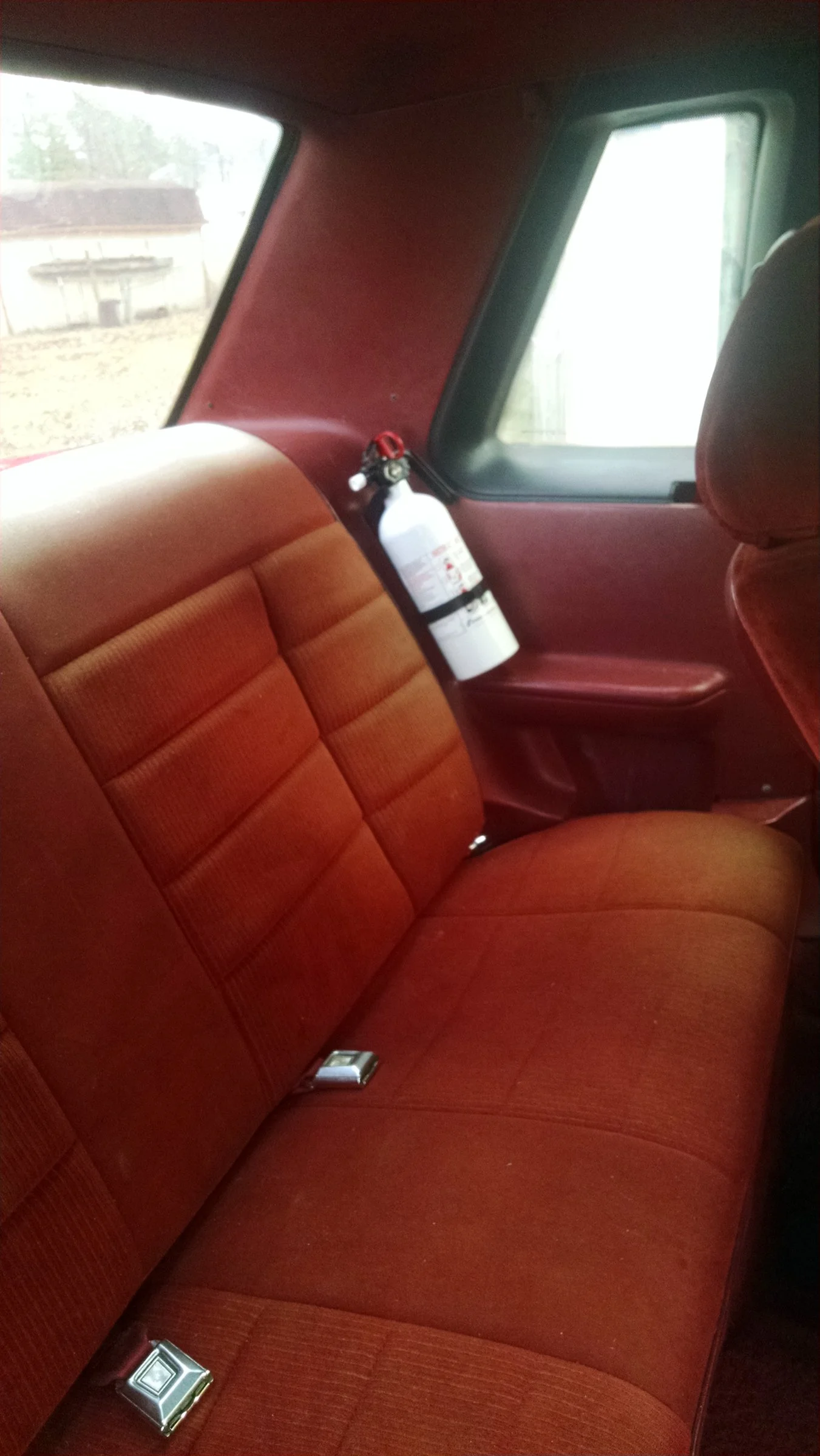

I'm not a bug fan of fire extinguishers in vehicles. In the past I had an incident where one came in handy. Without one my car would've burned to the ground. With that being said....I'm a big fan of safety.
No holes made in the panel....just some 3m tape so the panel isn't damaged. I don't plan on removing it....but its nice to know I can.
