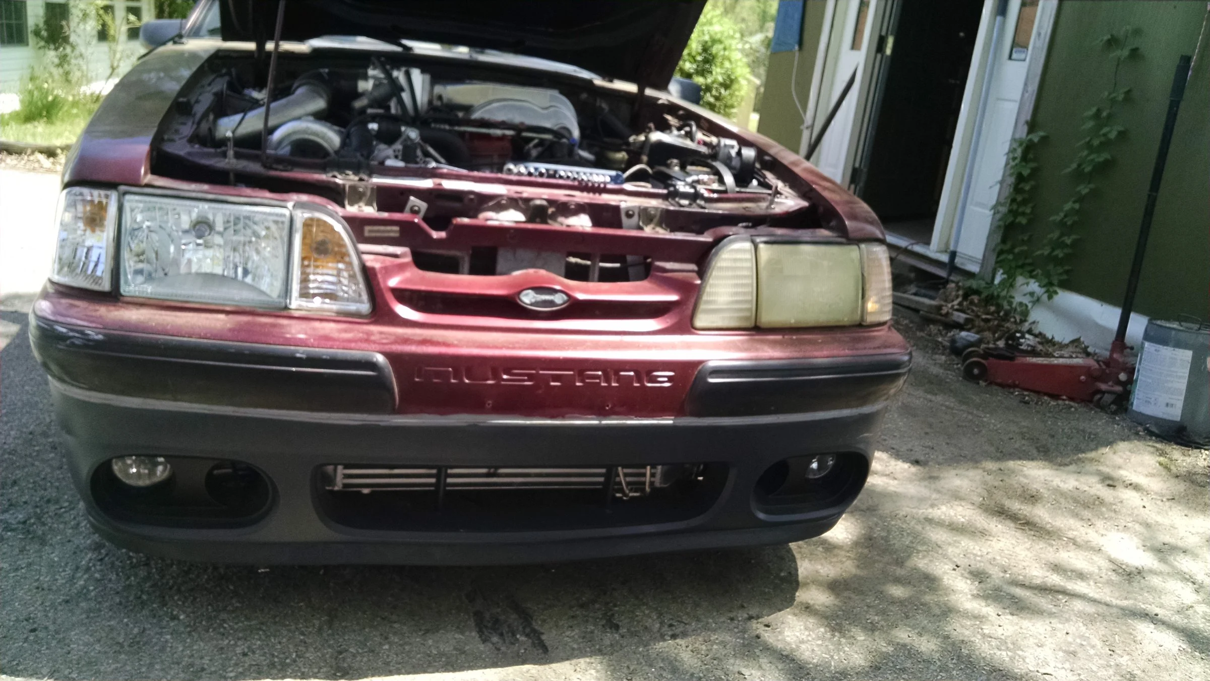

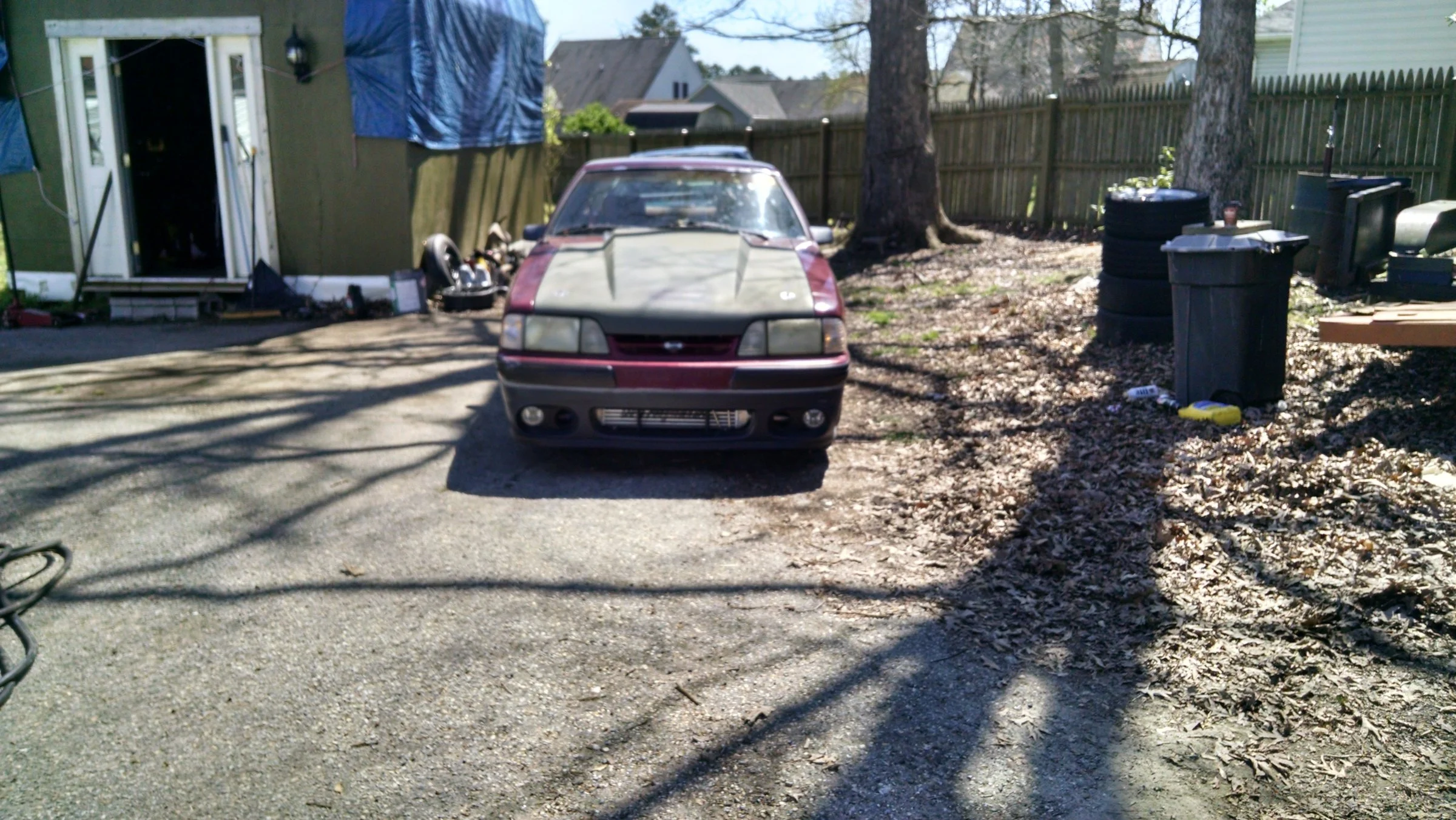

Here's a pic of the car driven into a different spot..... I can't wait to really drive this thing.

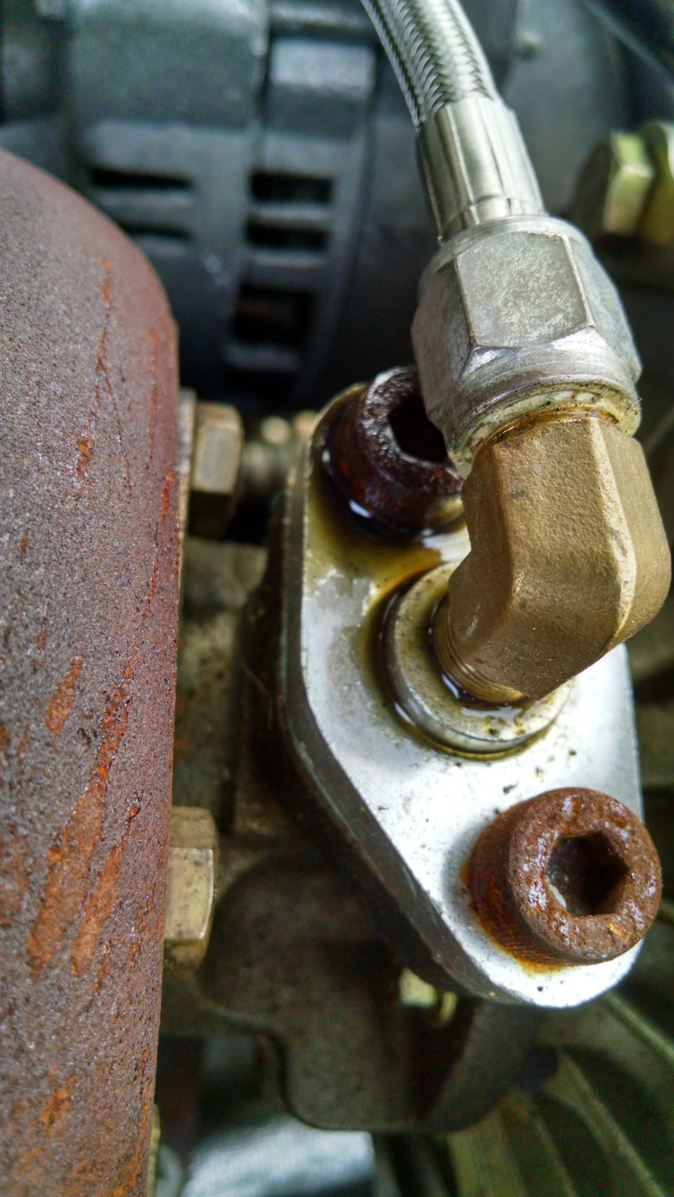

But I found this....
I've been running and starting this car for a while and never had even a little leak from this fitting. A few turns of the brass fitting and no mo leaky leaky.

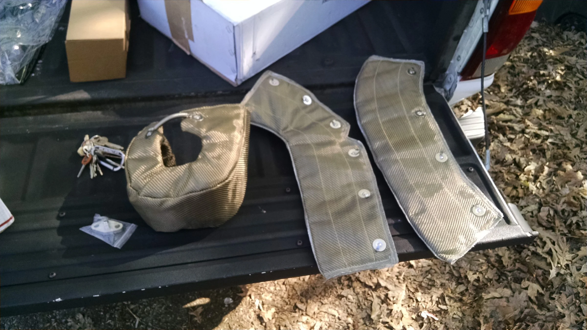

On3 got some more money from me, finally. I just ordered the turbo blanket, down pipe sleeve, and an oil feed restrictor.
Also, checked out some spark plug heat shielding and some cool titanium spark plug wire sleeving.

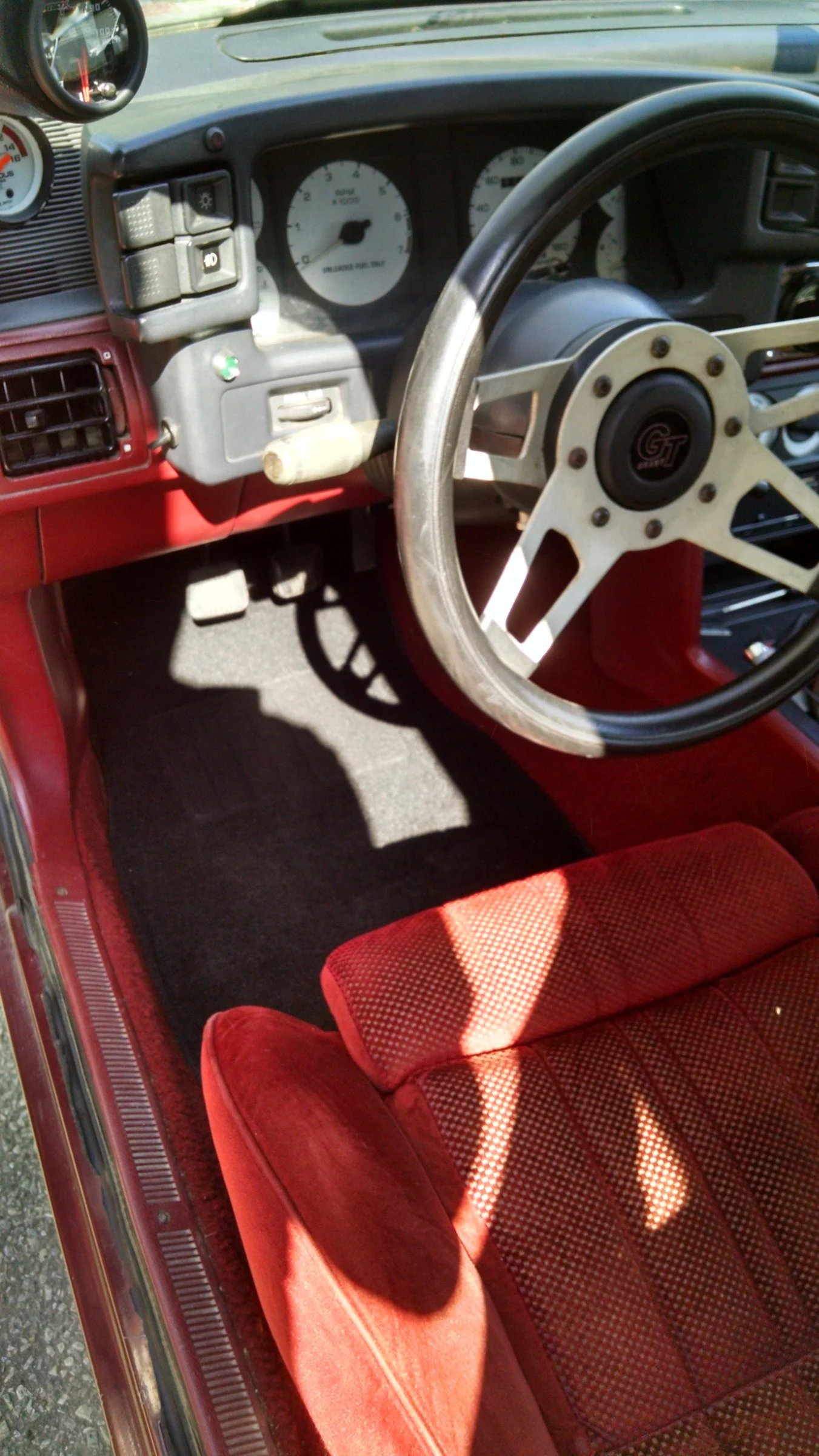

Your interior looks like its in really good shape.. What are the switches for?
The switches are for my line lock...and nitrous arm and purge. Probably won't use nitrous...but its there if I need it.
The interior is in decent shape...but the dust in this car is unbelievable. The interior has been out 3 times already and I'm still fighting dust. It has to be embedded in the carpet fibers. That's OK because that'll be changed shortly....along with my door to body weatherstrip.

There's only one switch in the picture. The green and red spots are indicator lights. That switch is to arm my line lock... The other switches can't be seen in any pictures. Lol

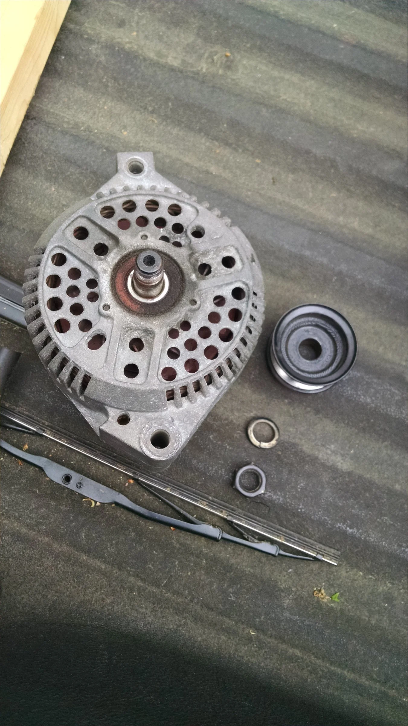

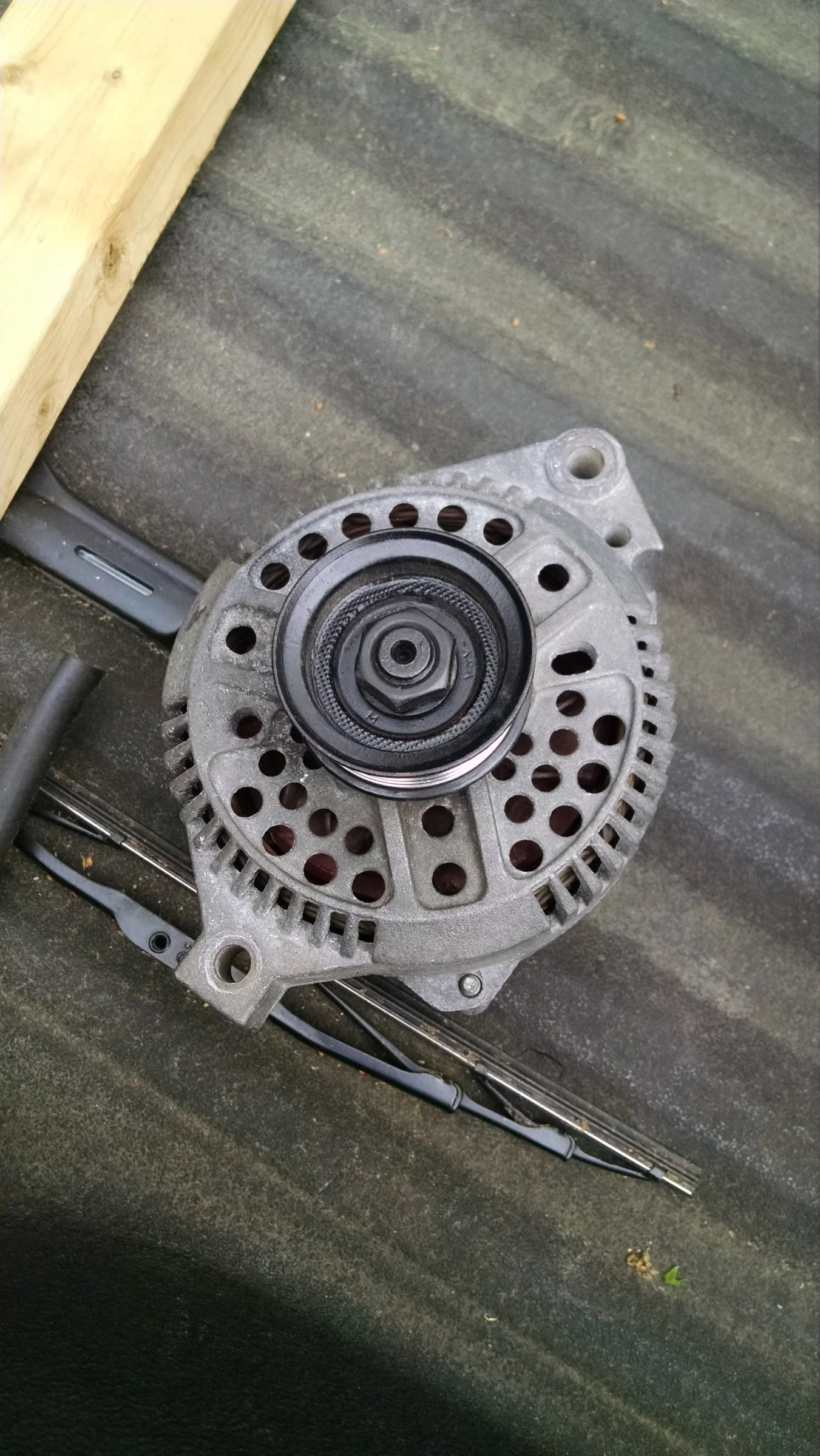

When I first got into doing a 130amp alternator upgrade there was no internet support ( that was about 15 years ago ). Back then we had to scrounge junkyards for things that would work.
I found this 130 amp alternator from a 1995 Taurus LE 3.8L in 2002.
I found out that the normal size pulley ( that came on the Taurus ) was too big and didn't spin fast enough at low rpms. So, I found an alternator pulley from a 1996 Escort.

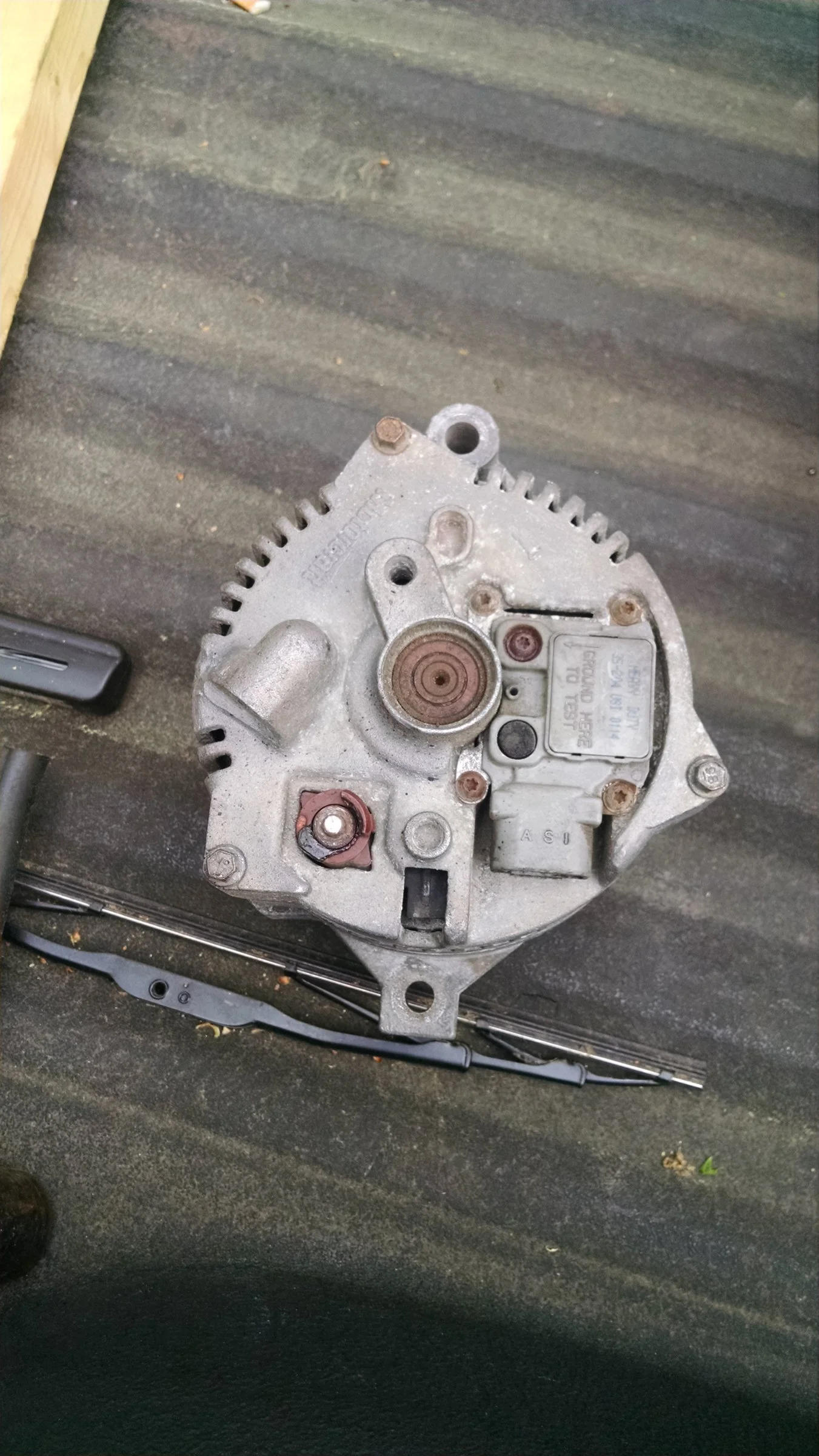

This combo has served me well... But all good things come yo an end. This thing has been working flawlessly for 15yrs for me...22 years all together. This alternator owes me absolutely nothing.

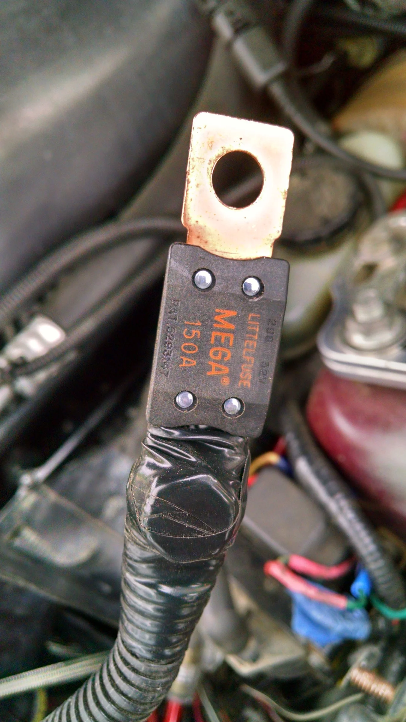

This shows the importance of a 150amp fuse in the power line. The alternator internally shorted, melting the wire stud.
RIP loyal Ford alternator...you will be missed. :cry:

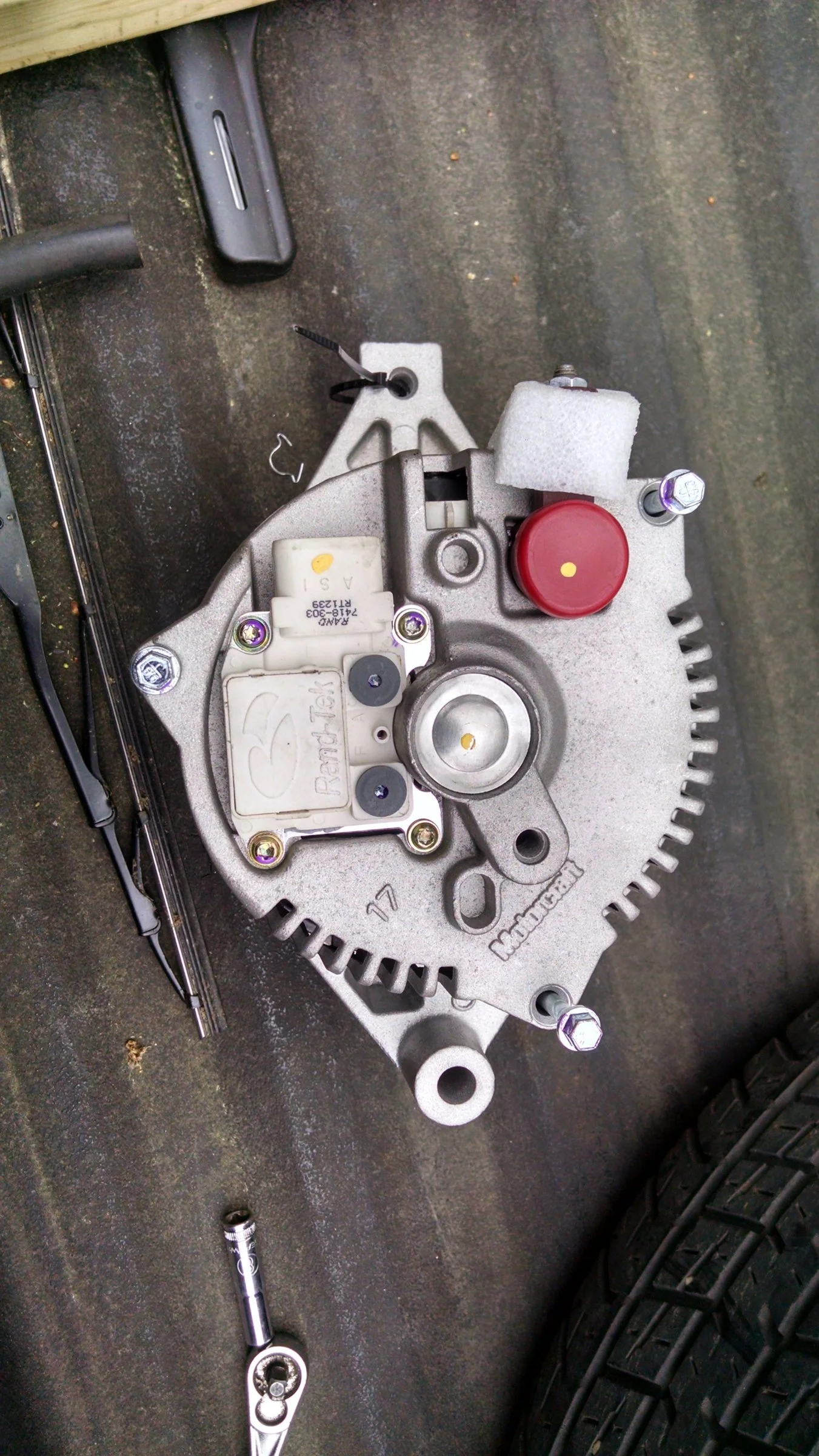

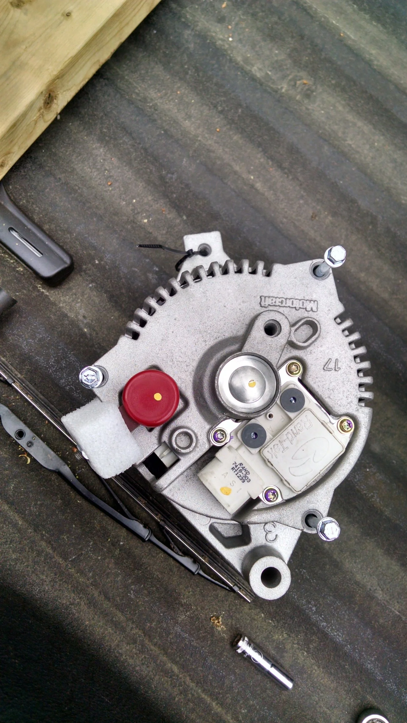

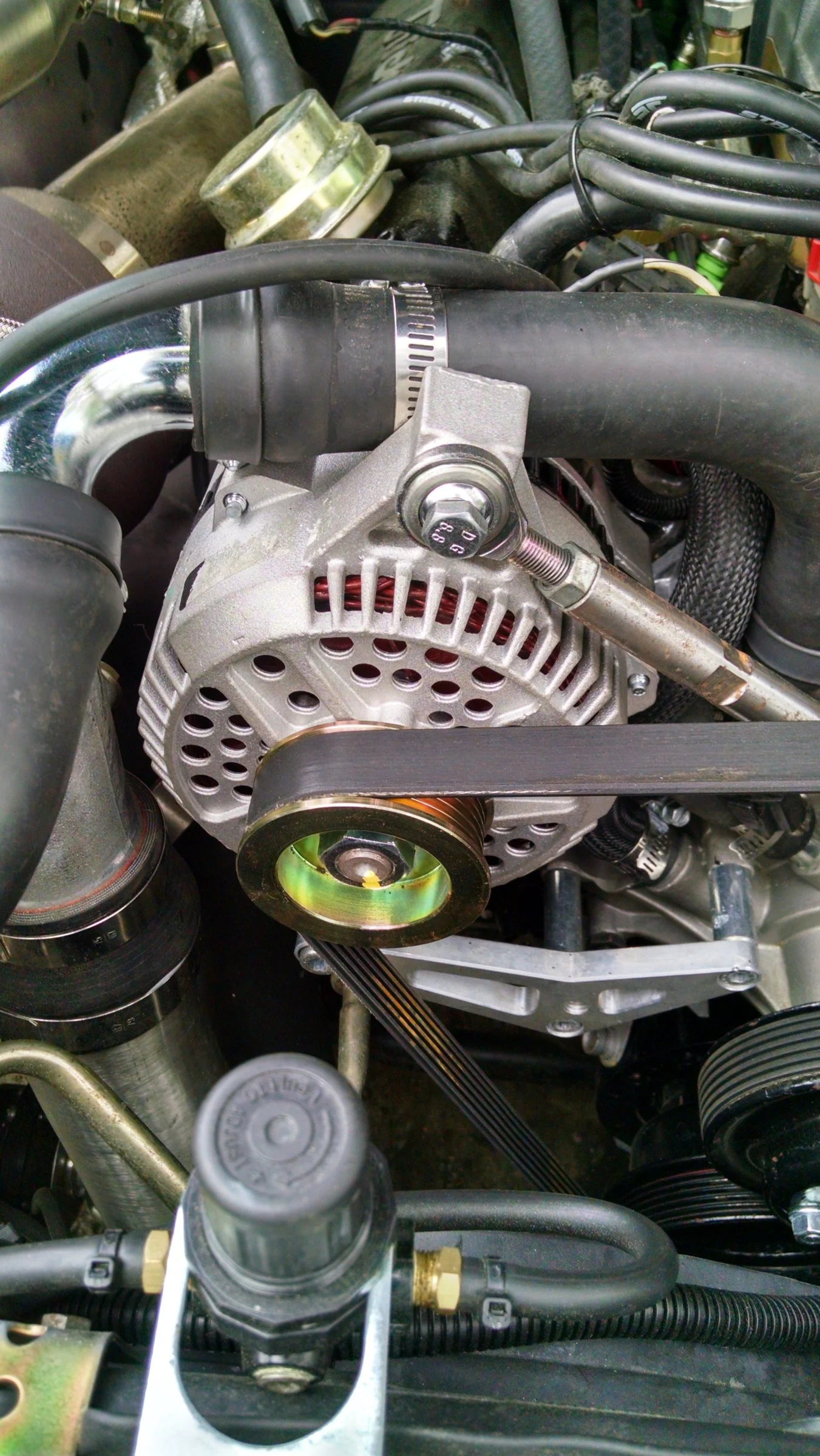

Alternator came in...it was bigger than my previous one. The power post was clocked to a different position as well.
On a regular mustang bracket it won't work but it fit perfect for me.
To clock an alternator just loosen the three 8mm bolts and spin the case.
With the bigger pulleyvit gave me a tighter belt and more room between the turbo and the alternator.
Here's a pic of my 150amp fuse.

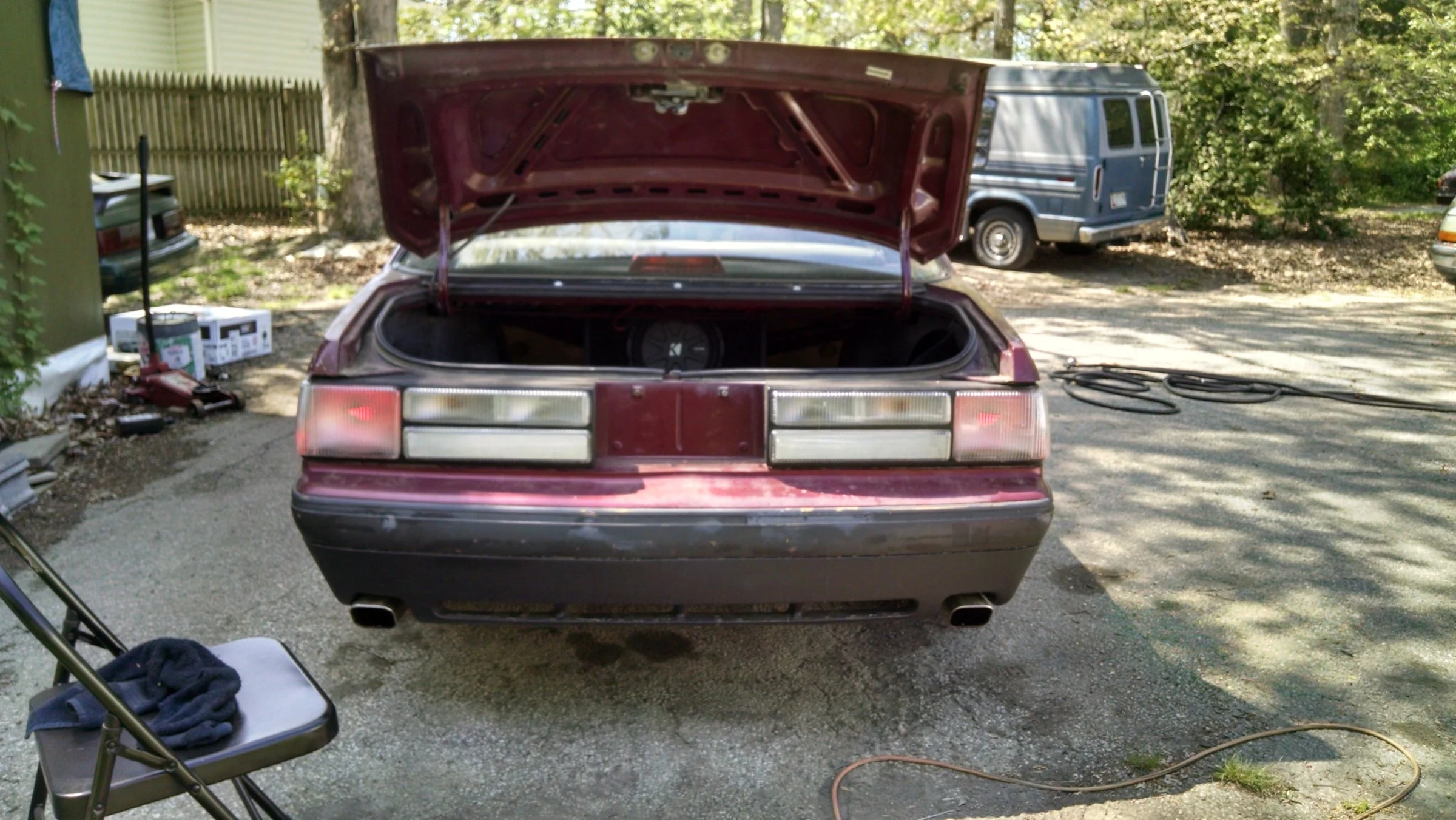

The tail light kit came in today. The black sticky crap that all over my tail lights is a PITA. I've got the hang of it though with the help of a flat head screw driver, razor blade, and PB Blaster.

lx or gt taillights?
gots several of each if needed.

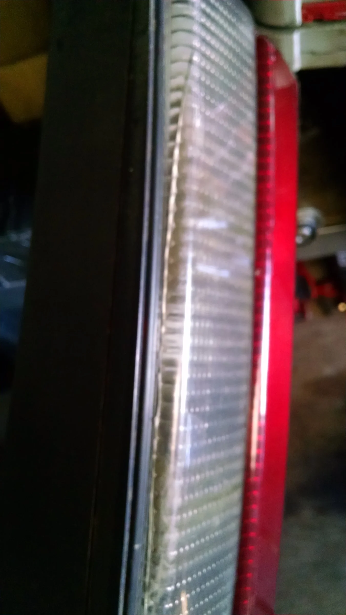

I've got Lx tails but the drivers side is cracked pretty bad
It came from a guy helping my push my convertible. I had a fiberglass wing and trunk lid so I guess he chose to push on the cheapest part. Lol...I was mad as hell.:fuss:

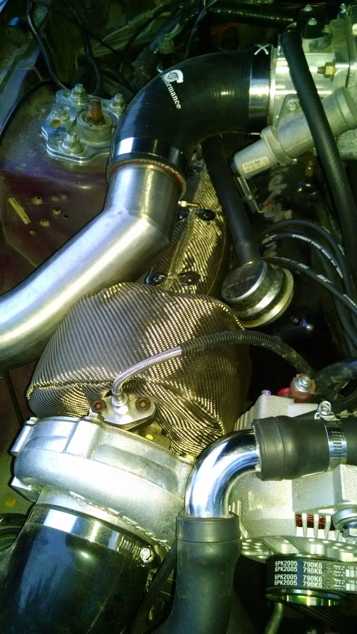

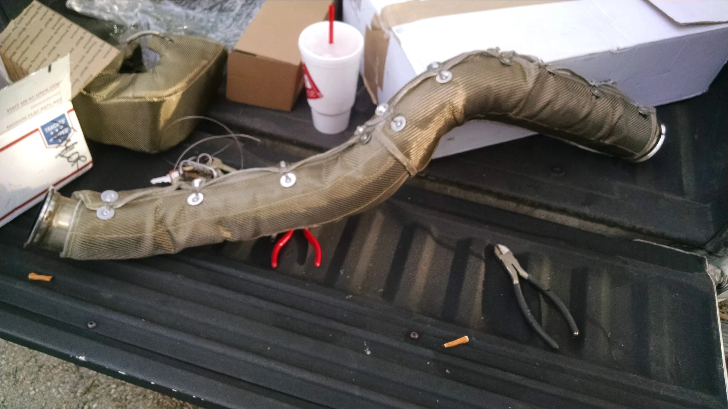

Got another surprise today...
It fit on the down pipe like a glove...
It also all fit back in the car like a glove...actually it took a little bit of twistingand turning to get it in there. Nothing dramatic though. :nice:
And...I still can reach the number 4 plug without pulling anything.:eek::banana:
Now, just the plug boot and wire heat shields...and tags before tuning.

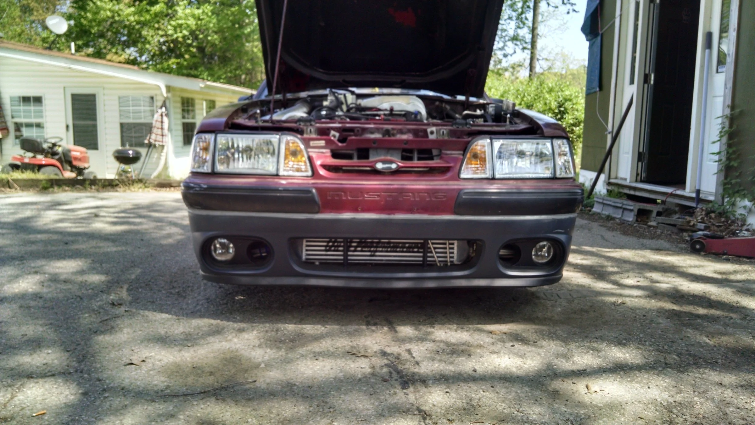

The bumper still needs to get finished...but I'm on cloud 9 today. Feels like old times.

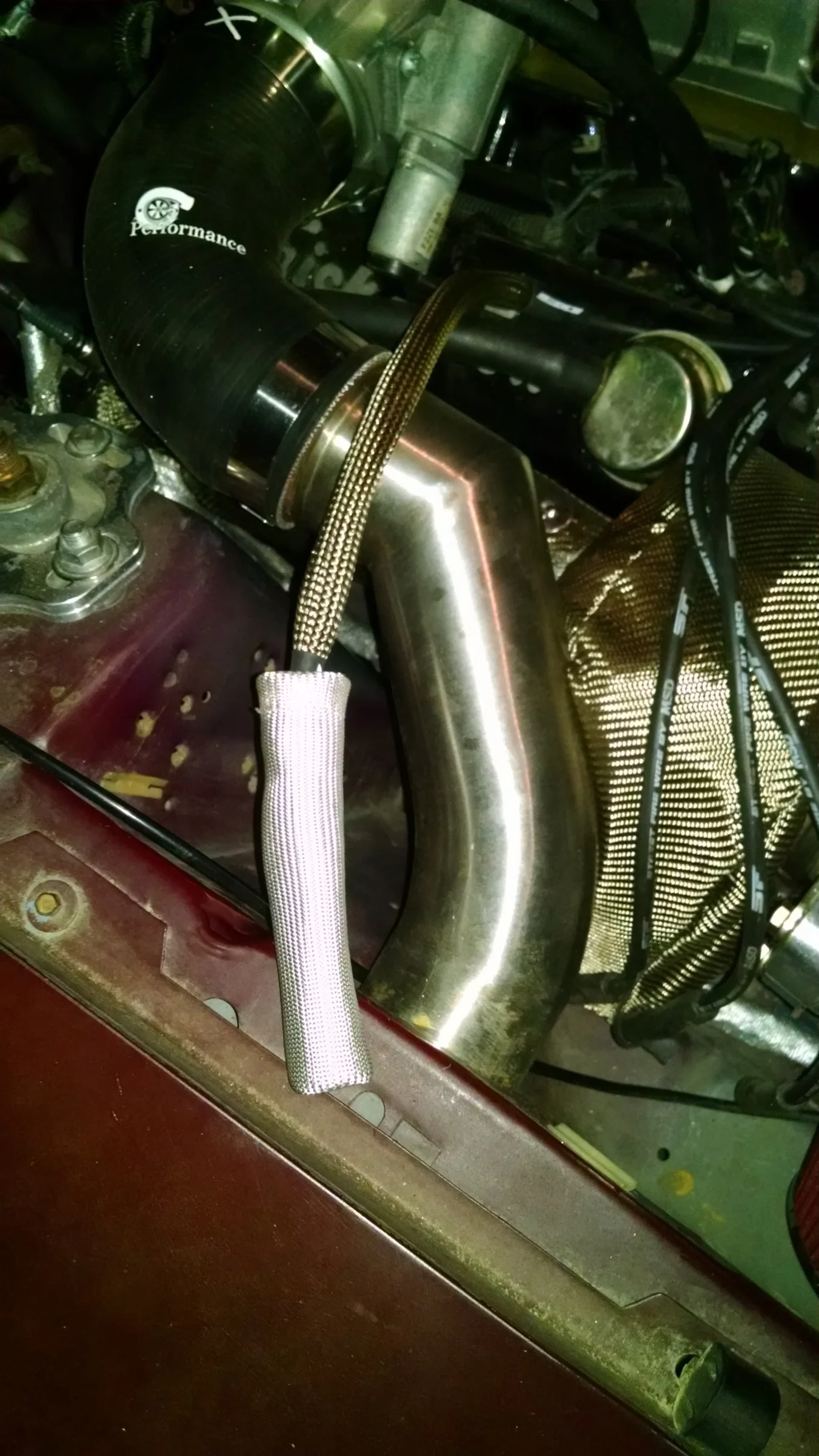

Got one wire sleeve and spark plug boot protector one before the rain...
And I scored this little bugger at the parts store...

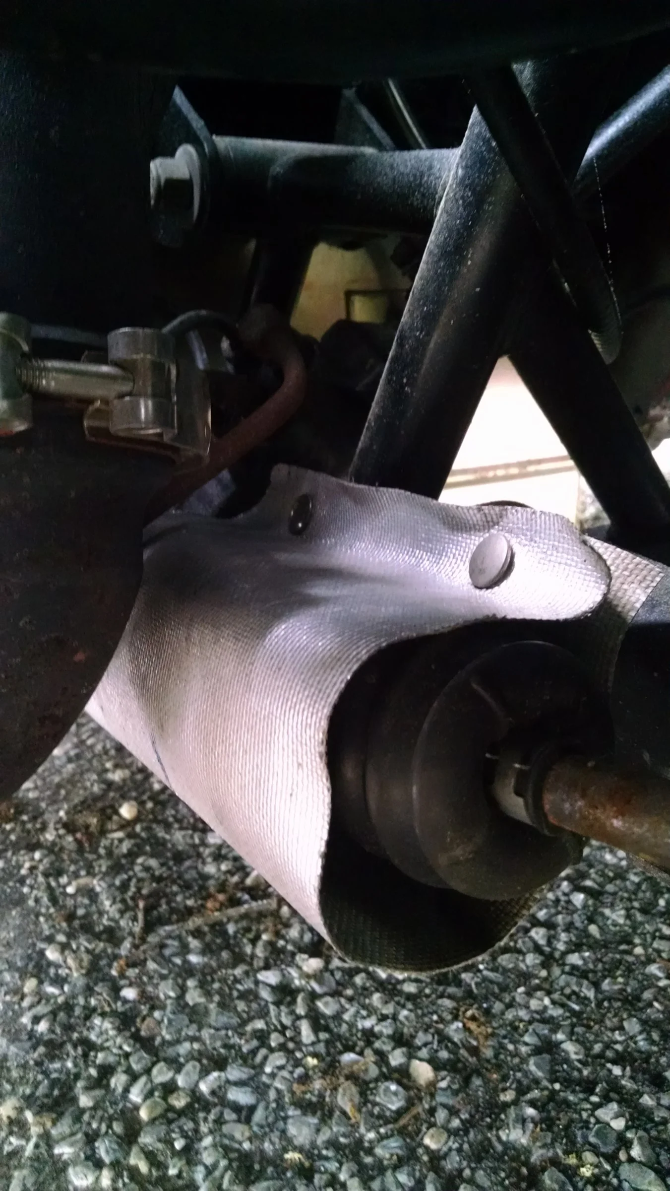

I put a heat shield on the drivers side rack boot. Its a salvaged heat wrap that comes factory on the old Malibu rack and pinions. Conveniently, it has stainless snaps on it to make installation easier.

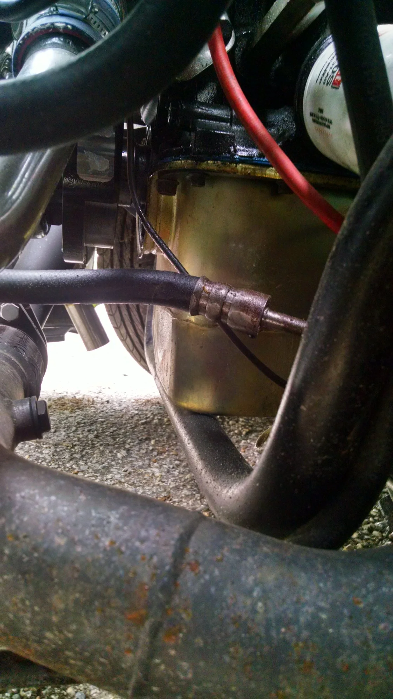

While I was under there I realized I have another issue.
My sway bar is laying on my oil pan. I've got 3 options...I can raise the motor with spacers at the motor mount brackets, lower the sway bar with spacers at the sway bar mount brackets, or I could shorten the spacers between my sway bar end links.
I've got to think about this...need alcohol. :cheers:
When raised the sway bar isn't touching the oil pan at all. So...in theory if I shorten the end link spacers the sway bar should move off the pan. There's not a lot of room between the sway bar and the crossover pipe....raising the engine may cause issues with the intake pipe and the hood...only a little bit of clearance left.
Glad the little bit of driving I've done didn't ruin my pan. :doh:
Also, I found my power steering return line literally lays on the crossover pipe....don't know how in the hell I missed that. :bang:
