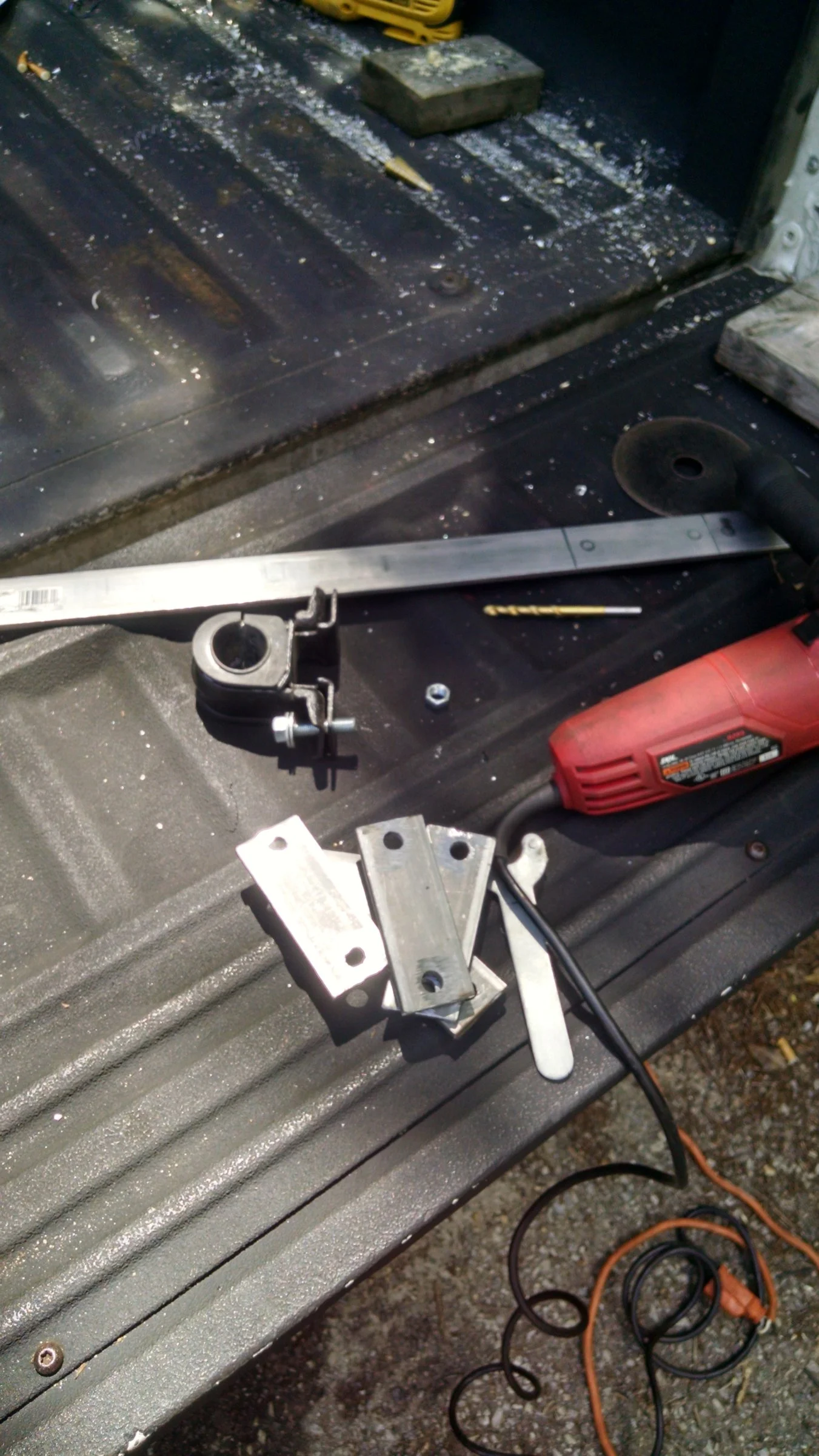

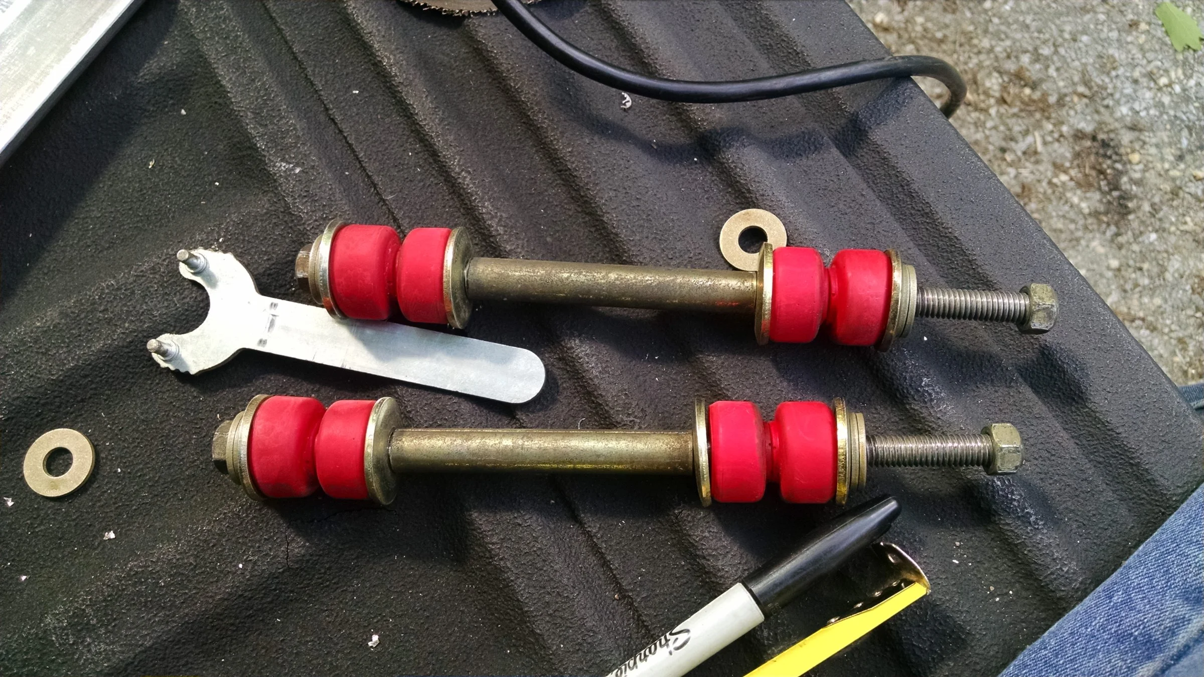

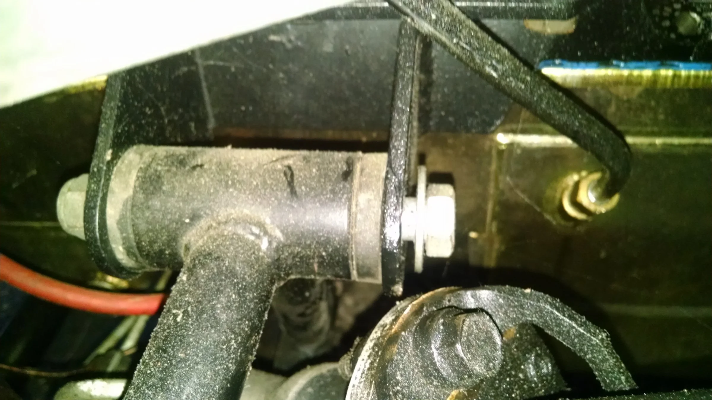

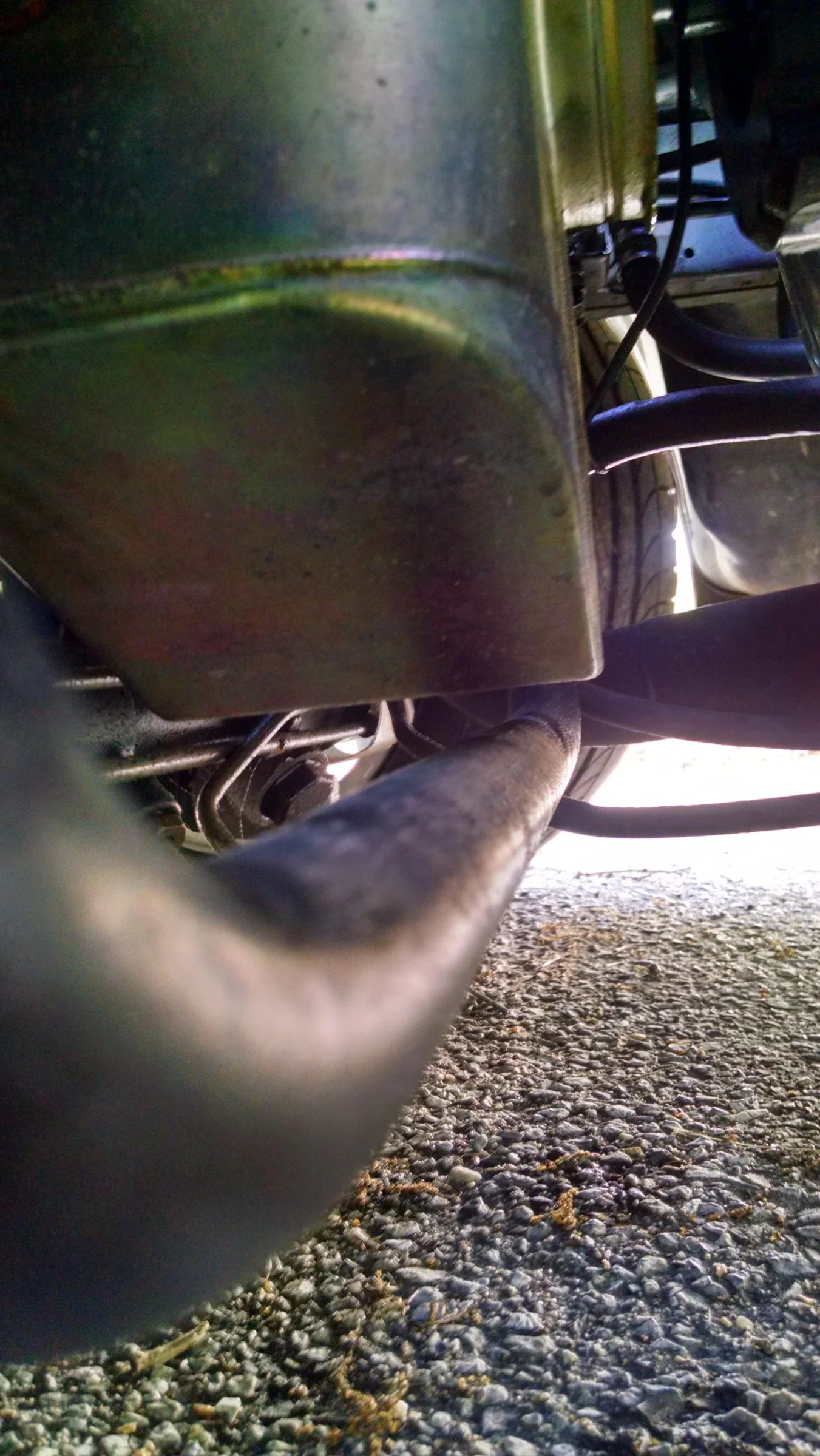

OK...after much thought and removing the end links I've found out....

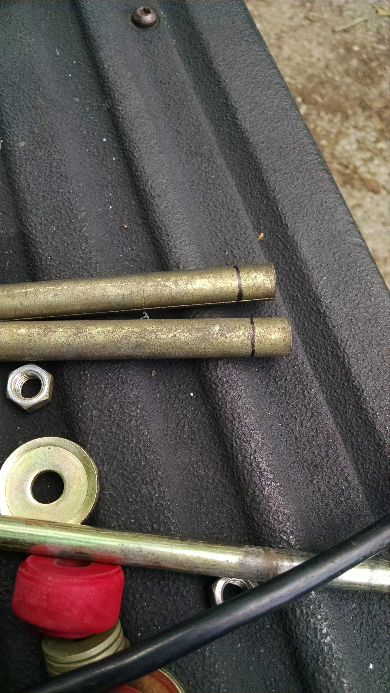

A) Shortening the end links will not help me.
B) I did reuse my v8 sway bar brackets.

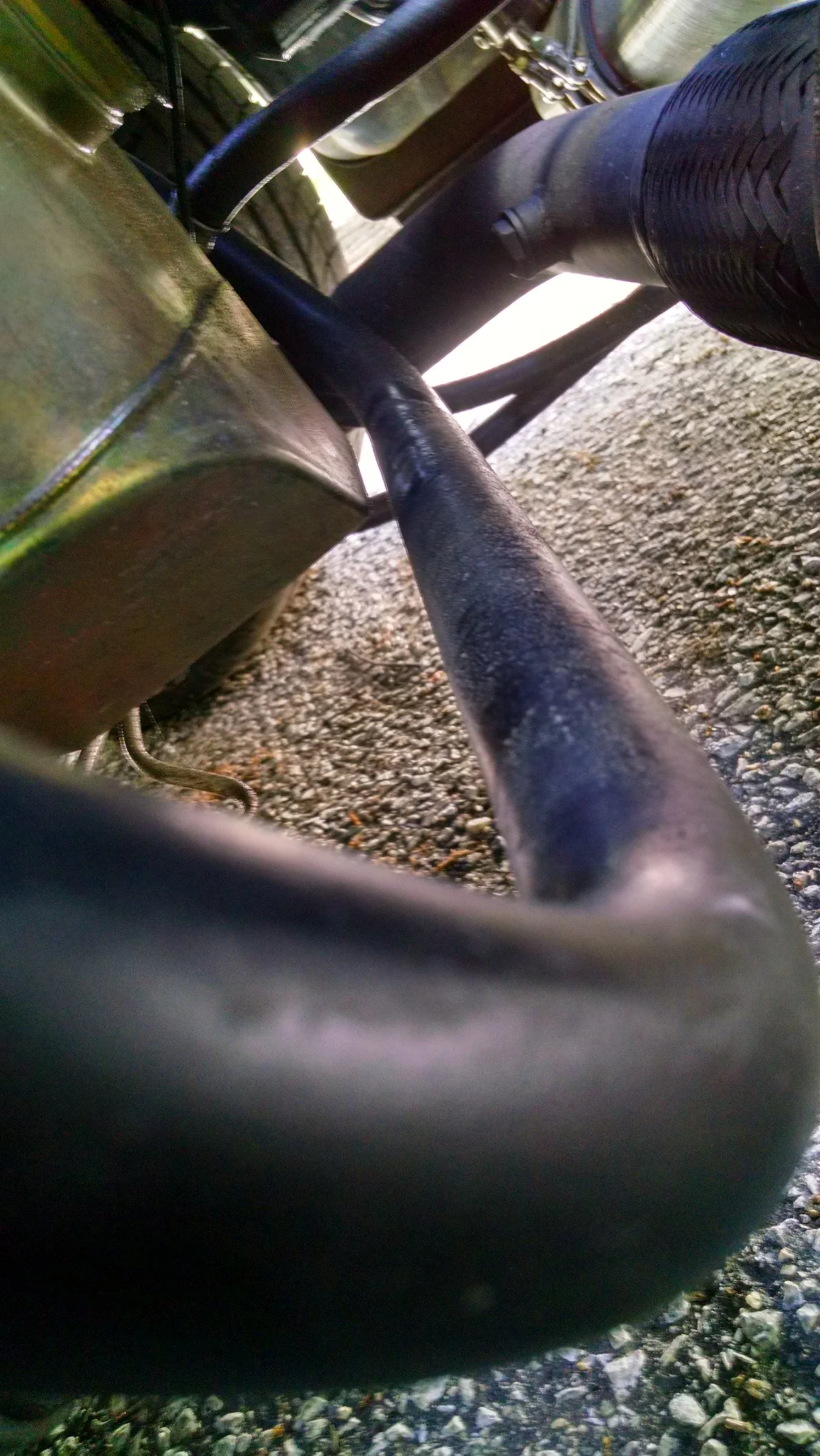

C) The sway bar hits the corner of the pan when swung up and down.
D) I'm going to make spacers to lower the bar about 3/4 inch...then adjust the end links for correct geometry.
With all the info on the web about 7 quart race pans not clearing the sway bar you'd think someone would make a spacer. MM makes a relocation kit but it also moves the bar forward about 1 inch...no room for that...and 60 bucks...pppfffttt. I'll figure out something cheaper.
