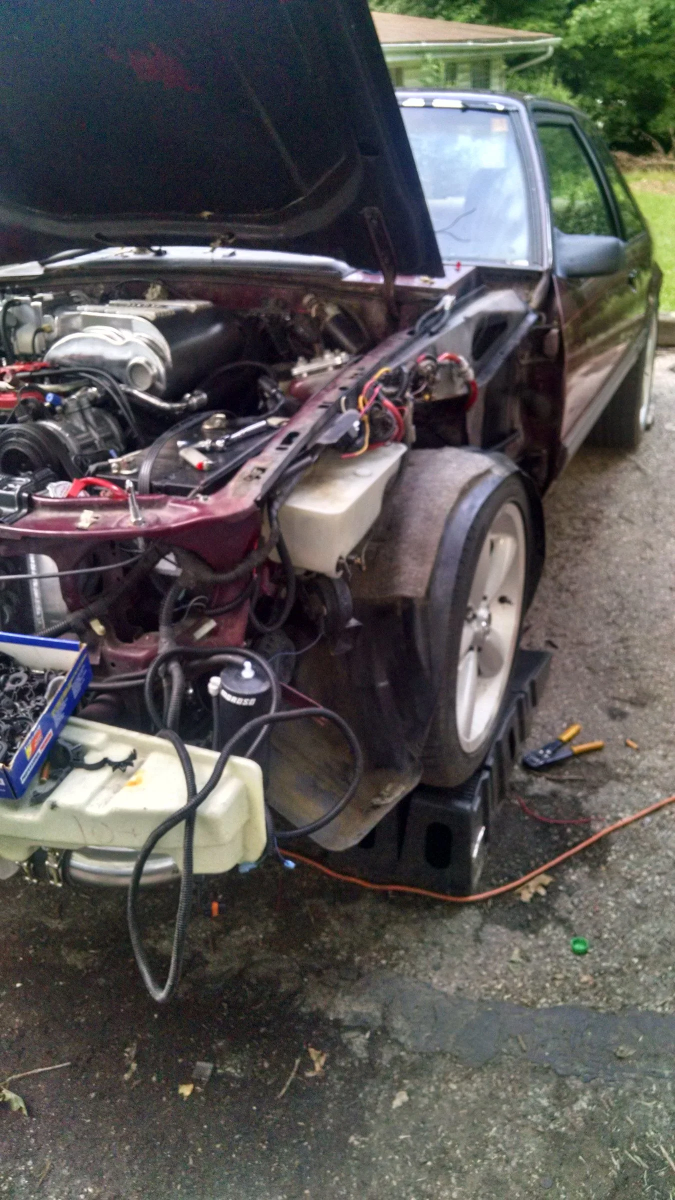

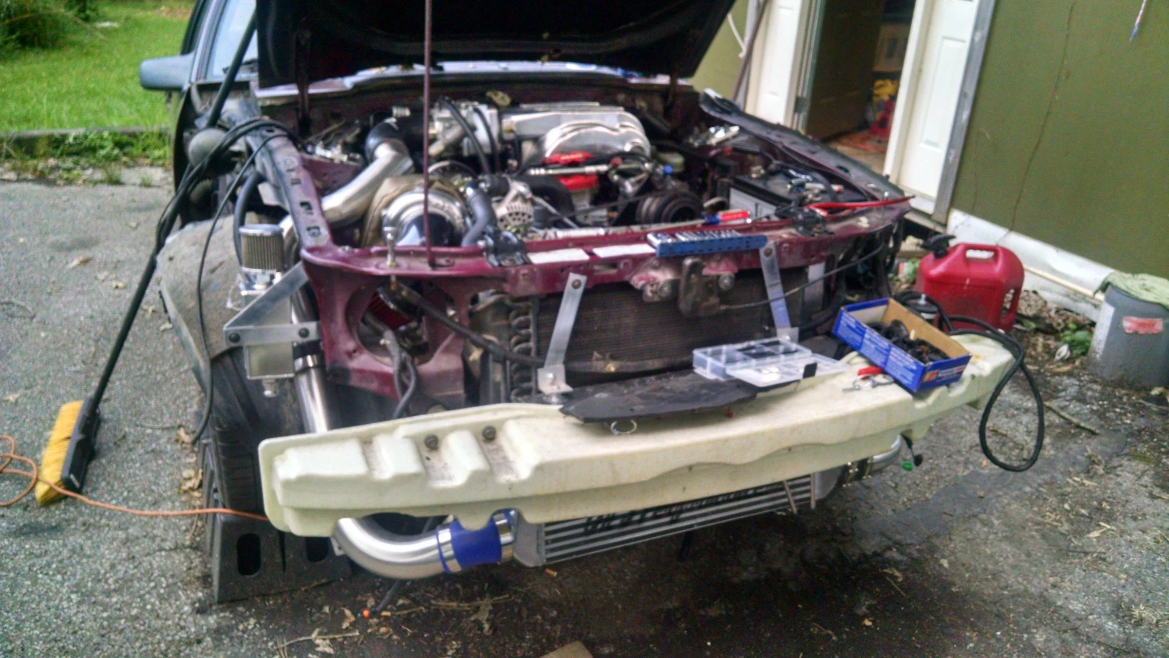

The wires are tucked. Car actually started and everything still works. Lol.

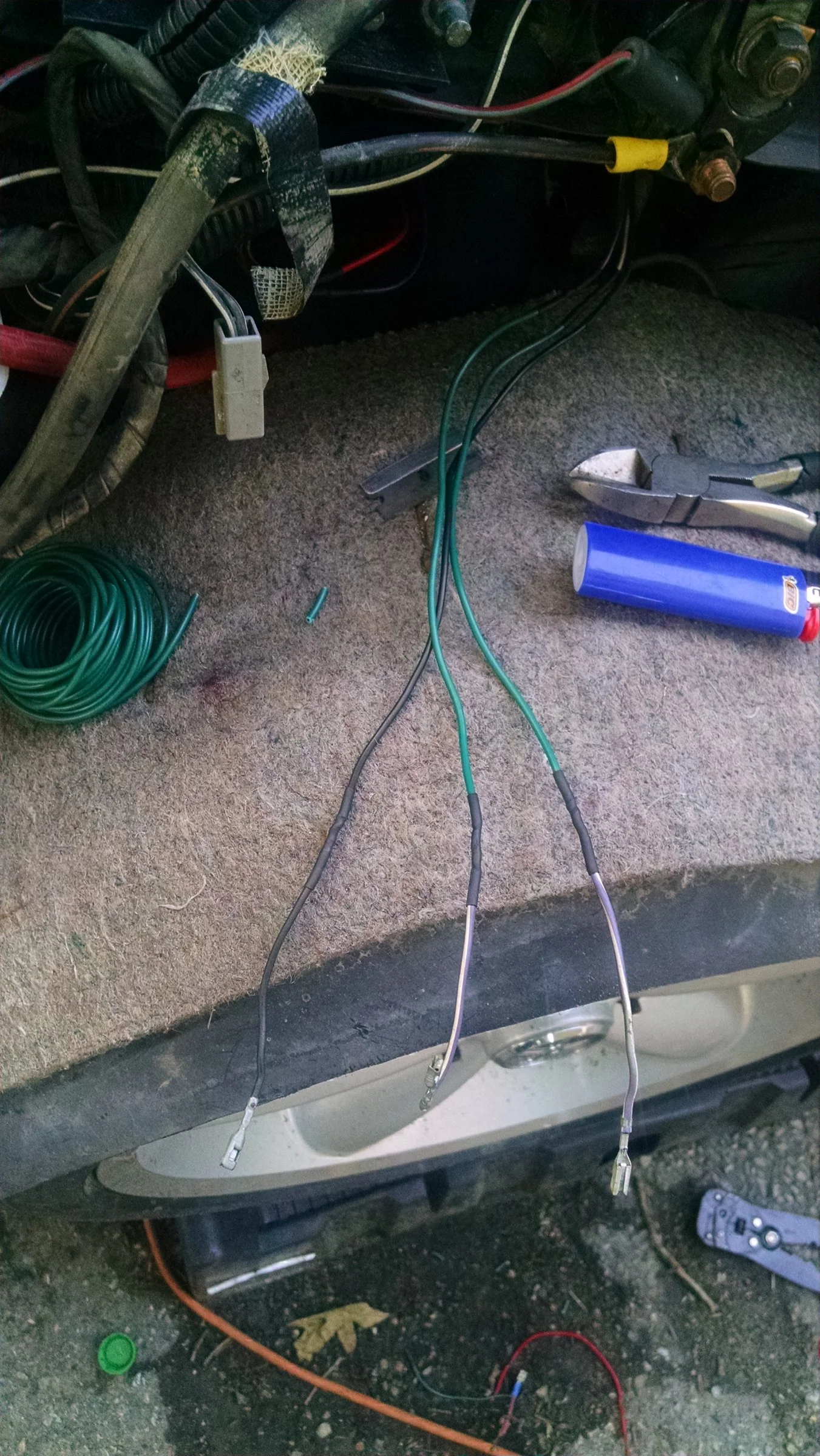

I have extended my brake switch wiring. Those were the only wires I needed to extend. The only reason is because I did not unwrap my factory wiring. All the harnesses and plugs fit through the hole with out modifying anything.
Here are the wires I extended and some pics of the car. I'm so glad that crap is out if my engine bay.
Now I get to wrap eeverything, map out some wire hangers, and clean and paint the inner fenders.

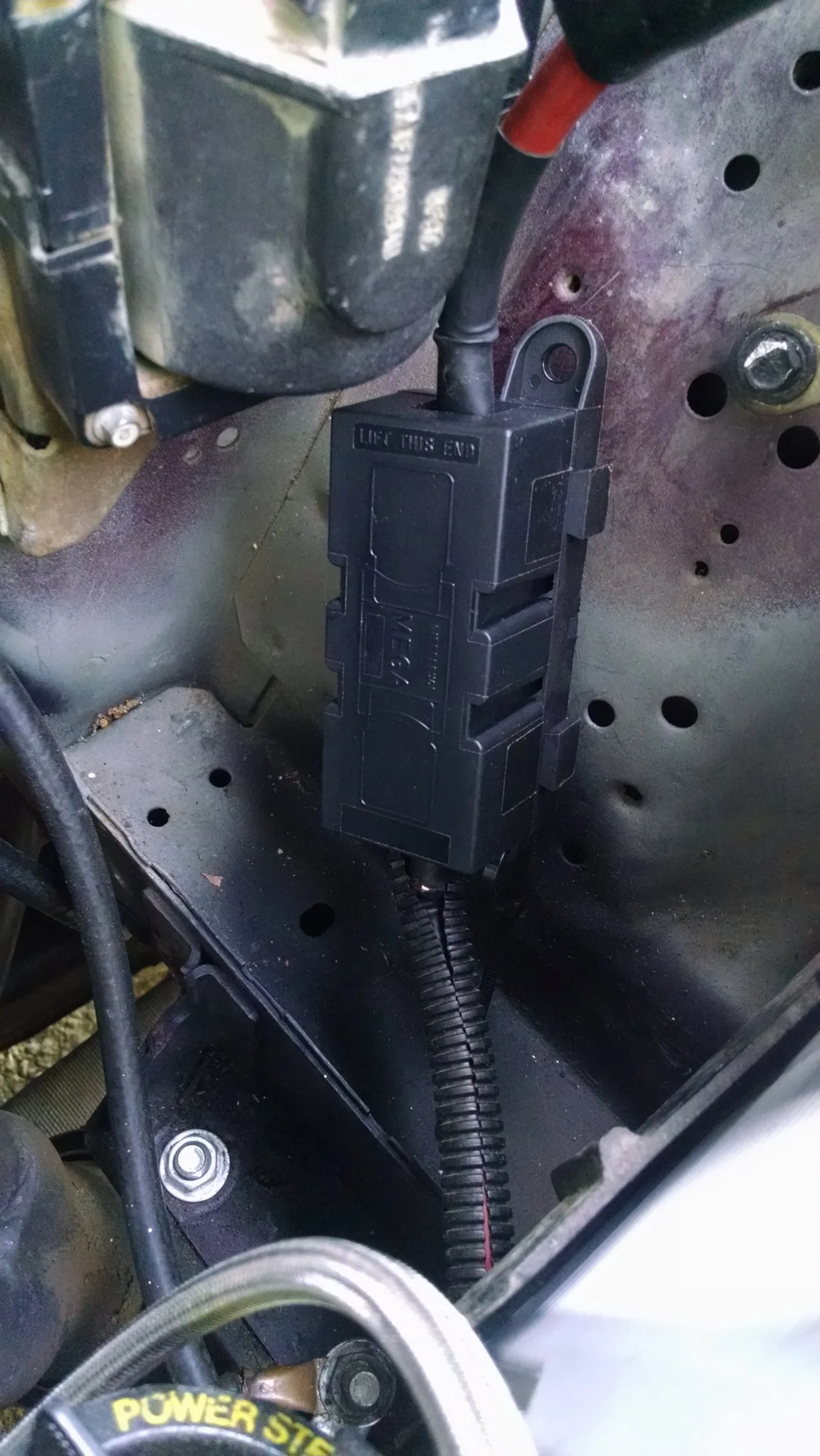

Finally, I got my free mega fuse holder. Its installed looking for a place to get bolted to the inner fender.:nice:
I'll post pics later.

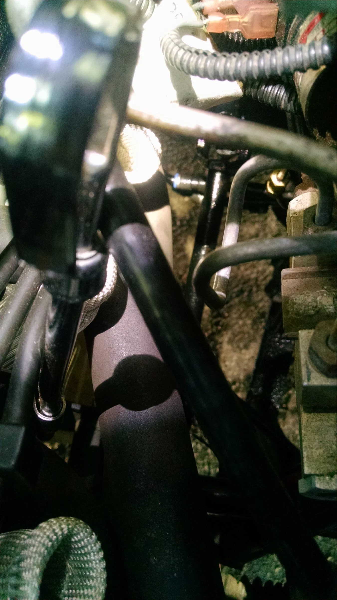

Got it in its home base parking spot....still running. I pulled the hood pins and I see it.... My fuel line is spraying an injector like pattern right on my drivers side manifold. This thing was spraying so fine you couldn't even hardly see it. Smh
Luckily the car didn't burn to the ground...
That's my cheap **s fuel line coupler hiding back there...the black thing with the blue end. Needless to say, I'm ordering AN fittings and braided line to resolve this issue. Sometimes it doesn't pay to be cheap.:bang:
Here's a pic of my free fuse holder....
Its still not screwed down... :nonono:

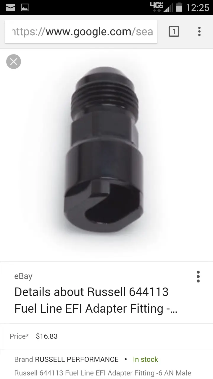

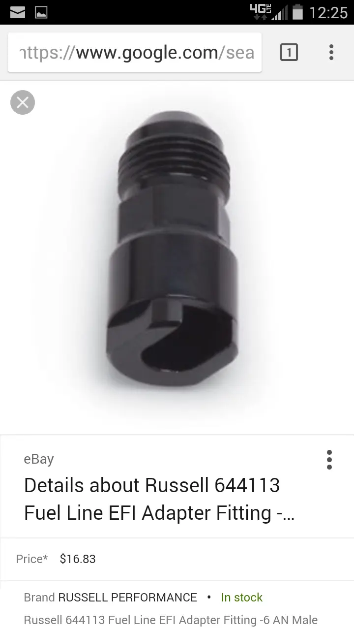

I wanted to buy individual fittings but I'm stuck buying this...plus 2 fittings for the 1/4 and 5/16 quick connect fittings. I believe the kit is -6AN
Reactions: RaggedGT

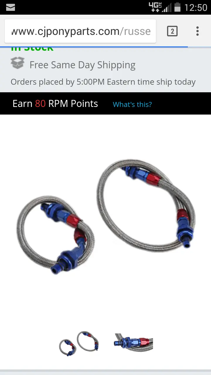

I figured out this whole AN fitting thing. Its way cheaper for me to buy all the fittings from JEGS. It'll end up being less than $120. I need to go online and check stock and availability.
I snapped some pics of some of what's needed.
And of coarse the spring lock fittings for the rails and the straight and 45 degree -06 fittings and nylon braided hose.

.... looks expensive .......
Looks can be deceiving. The hoses between the stock mustang fuel rail to the spring lock connectors behind the smog pump area costs about 80 bucks alone.
My car burning to the ground would be way more expensive. I'm not 100% sure the nylon braided hose will hold up to the fuel pressure. ( I assume so ) Definitely need to do a little more research before I order.
Do you know a cheaper place to get AN fittings from ?

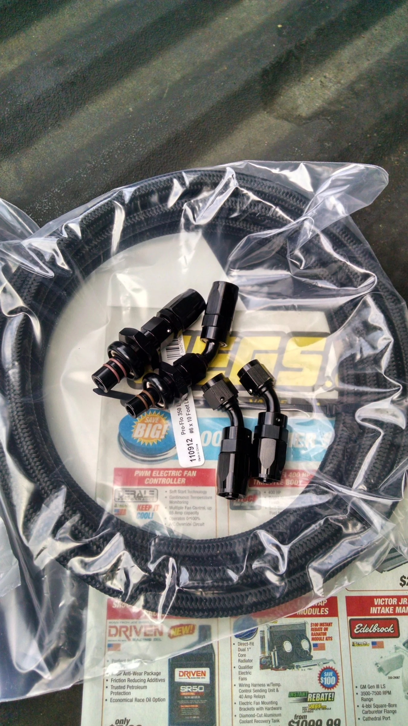

The parts came today for the fuel lines....
But....I forgot to order the adapters for my hard lines...dangit !!!!
I was trying to get it done before I'm back on a plane...I've got to go halfway across the country to New Mexico. This screws my plans...oh well...life goes on. They'll be in the mail.
