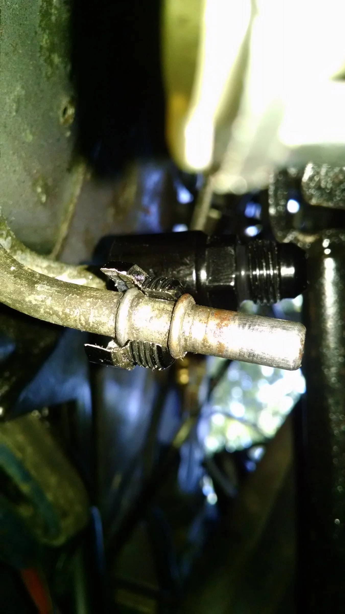

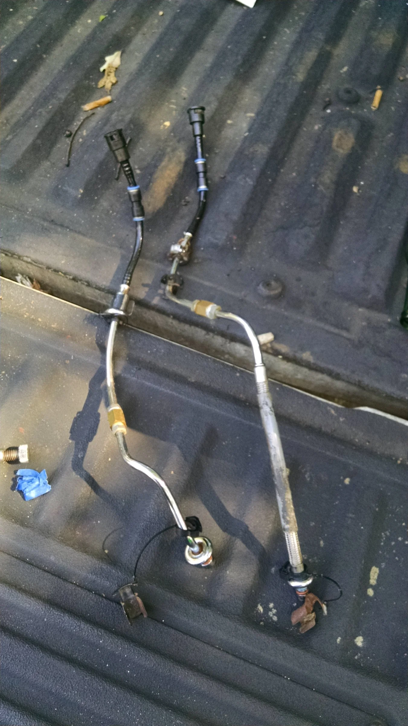

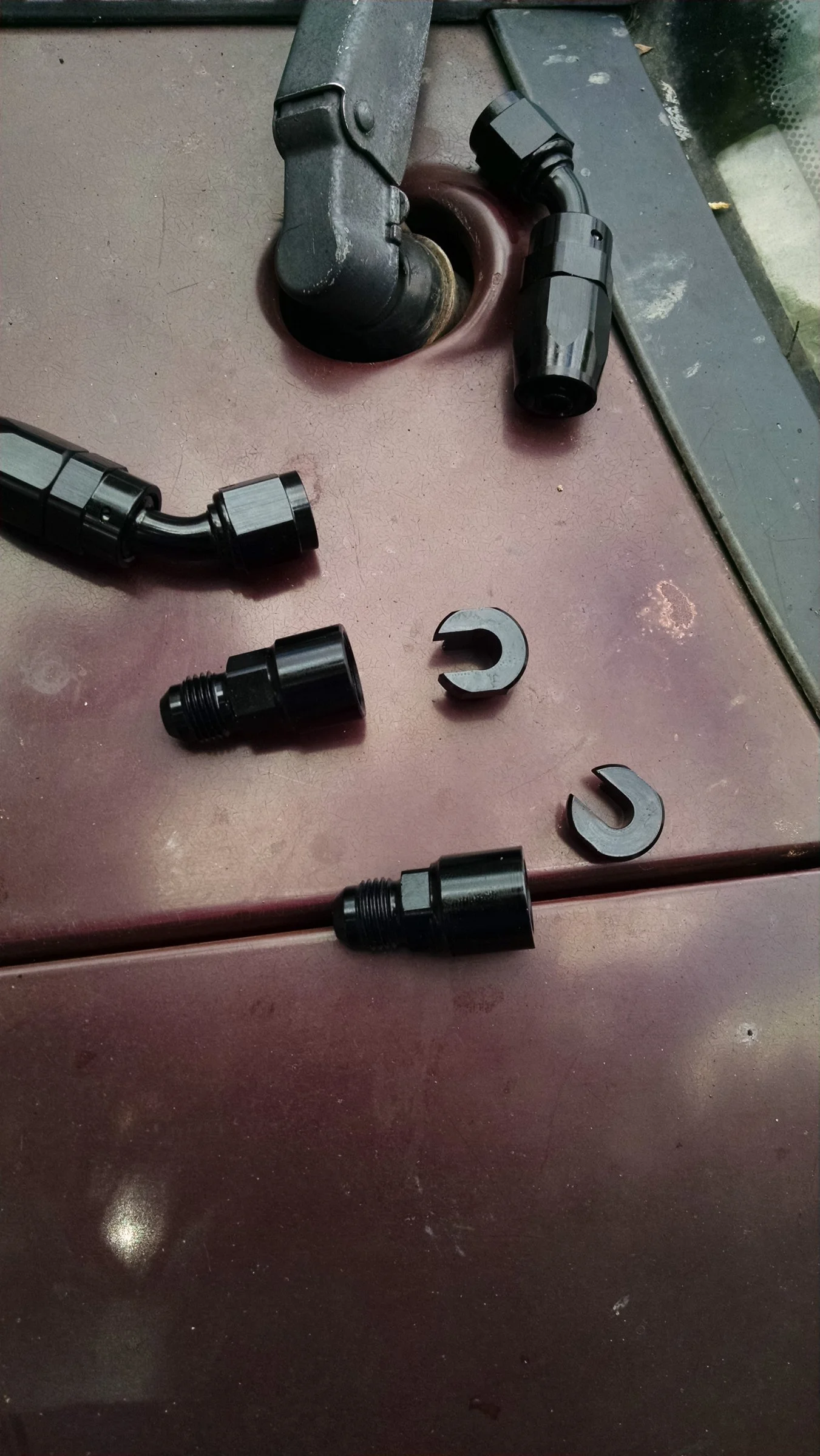

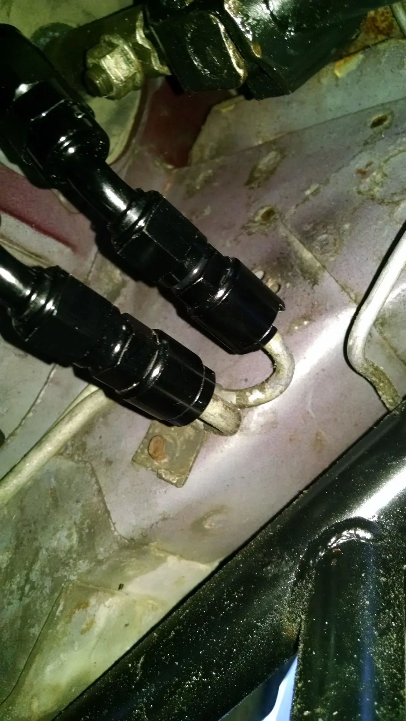

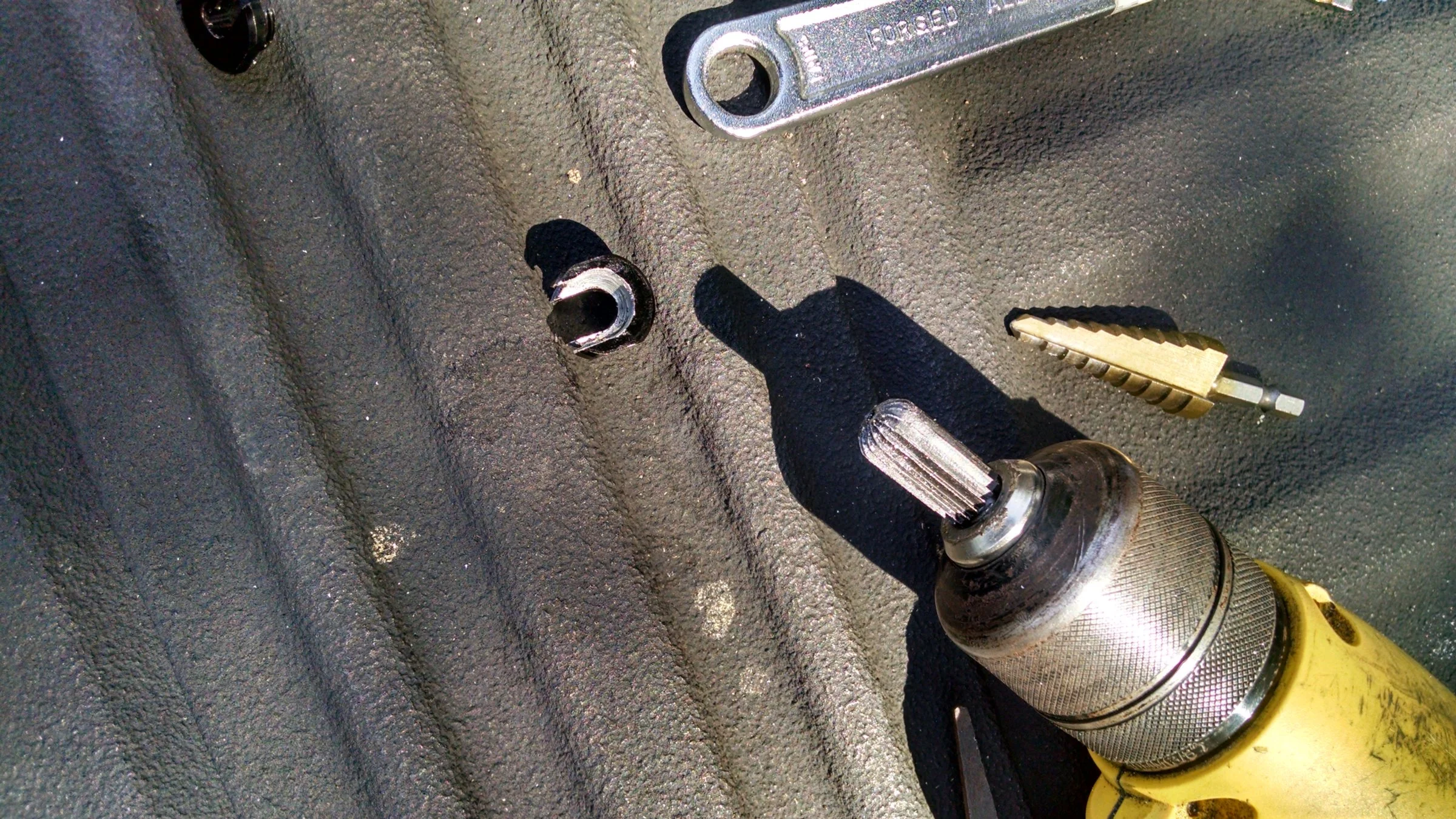

My parts came this morning. Everything was great until I found out that the 5/16 adapter was too big to fit between the two notches on the hard line.
I had to use my drill and open up the back of the fitting. At this point I was mad as hell... and determined.
Fired it up and no more leaks. Thank god !!!

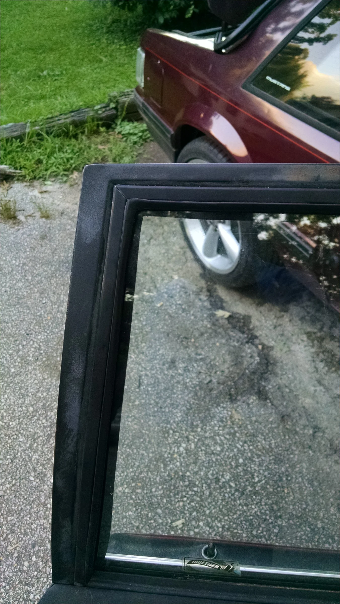

Now on to the window belt weatherstrip.

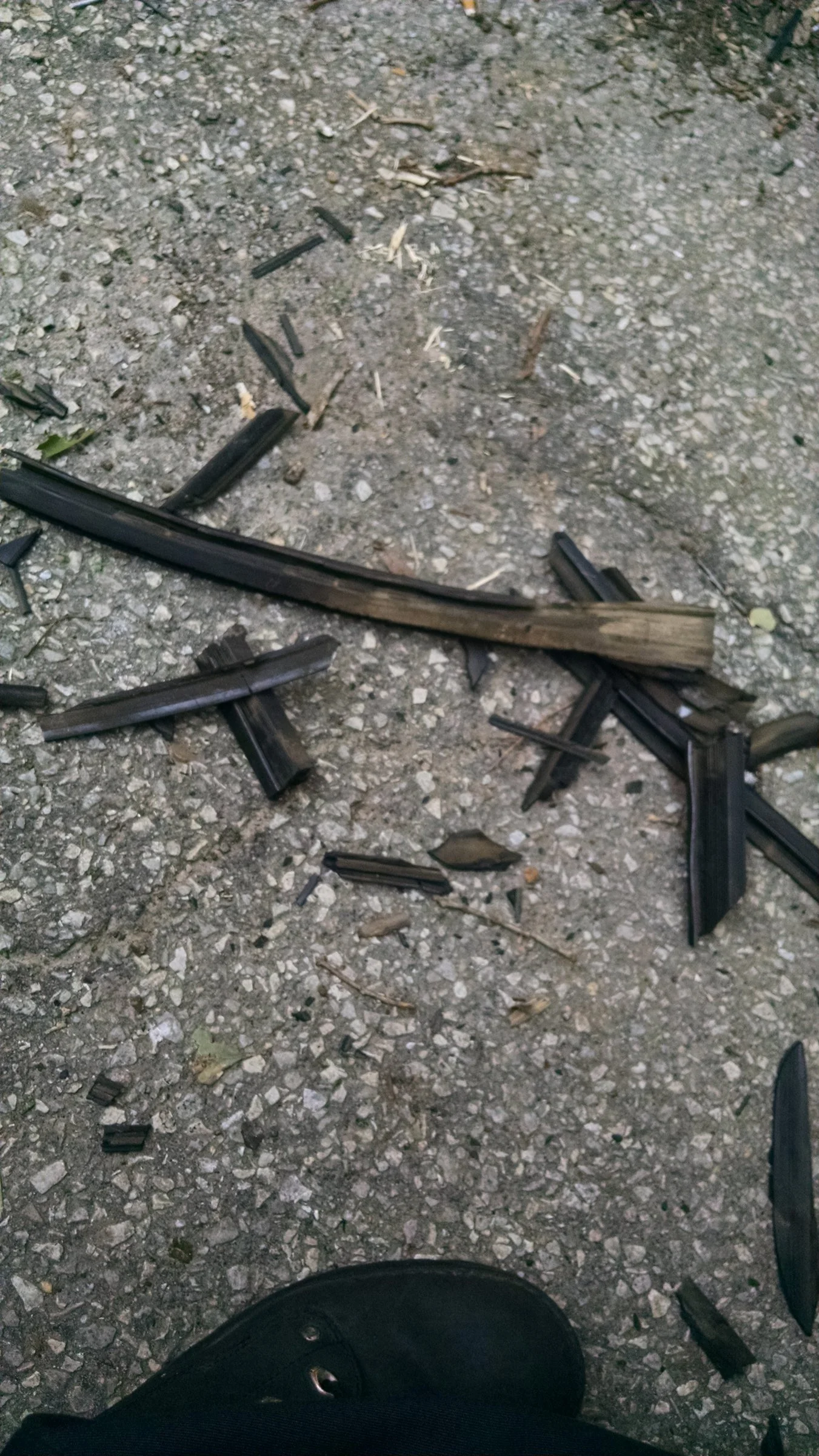

Passenger side done. Wasn't too bad...
That crap was so hard that I had to break it out. Its all worth it though...

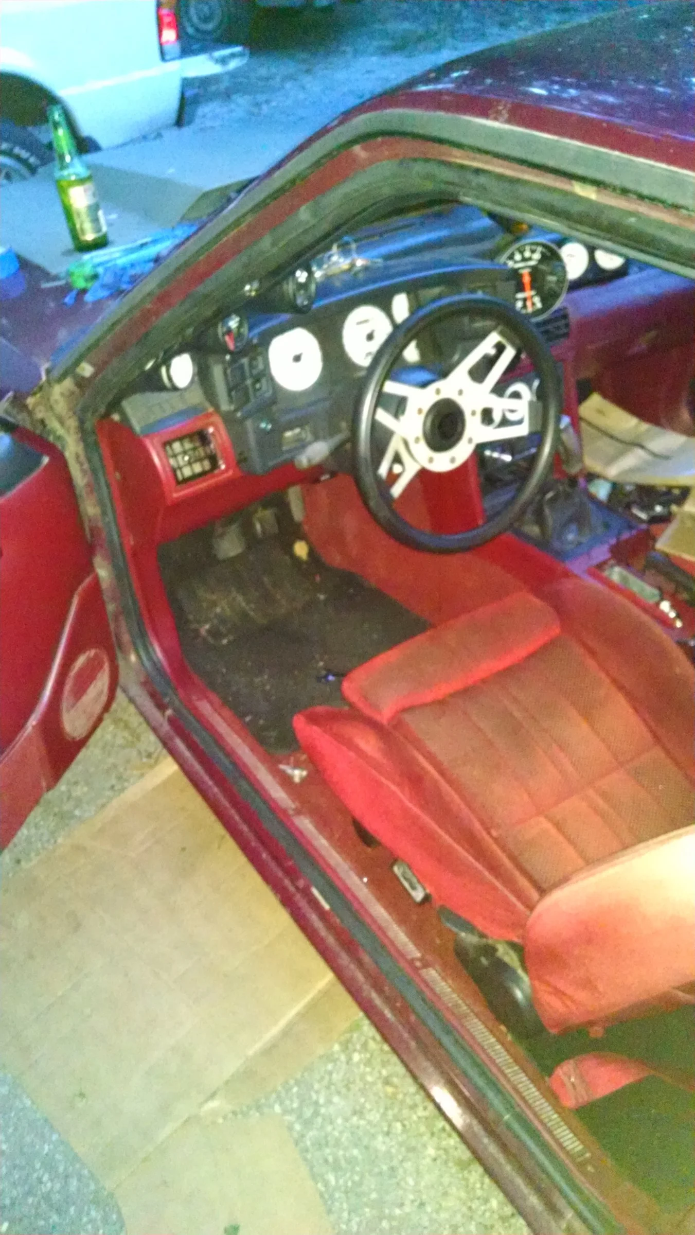

The guy I bought the weatherstrip from lied a little. He said the weatherstrip was for the hatch or trunk....that was a lie. It was the door weatherstrip...so...my drivers side door now has fresh weatherstrip. Due to the sun going down and 5 Dos Equis that was all I got done.
The flash on my phone makes Dusty look dustier than he is.:nonono:

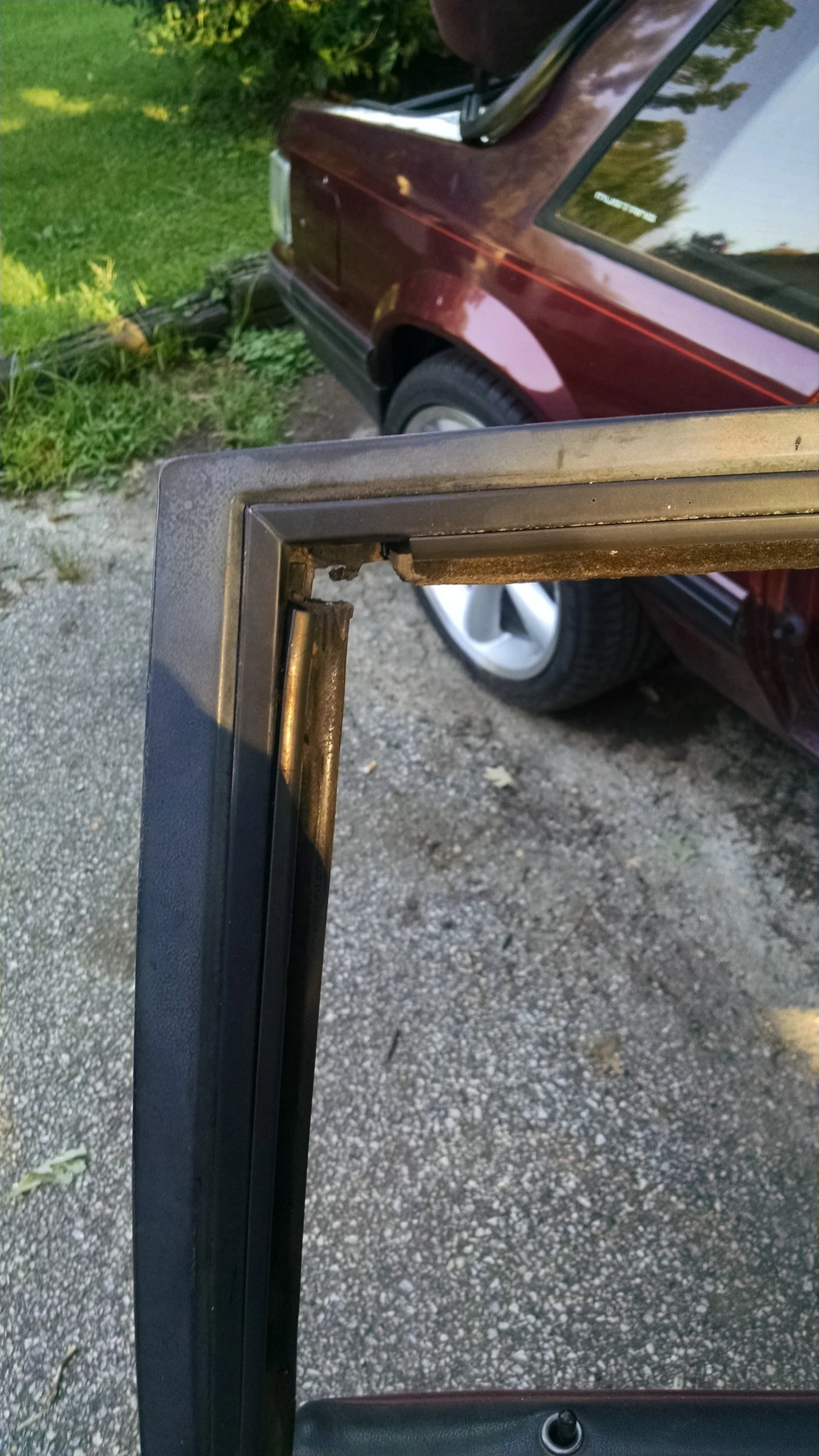

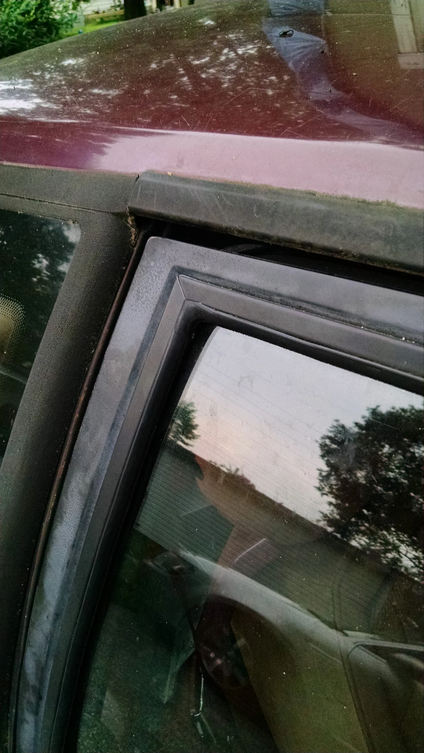

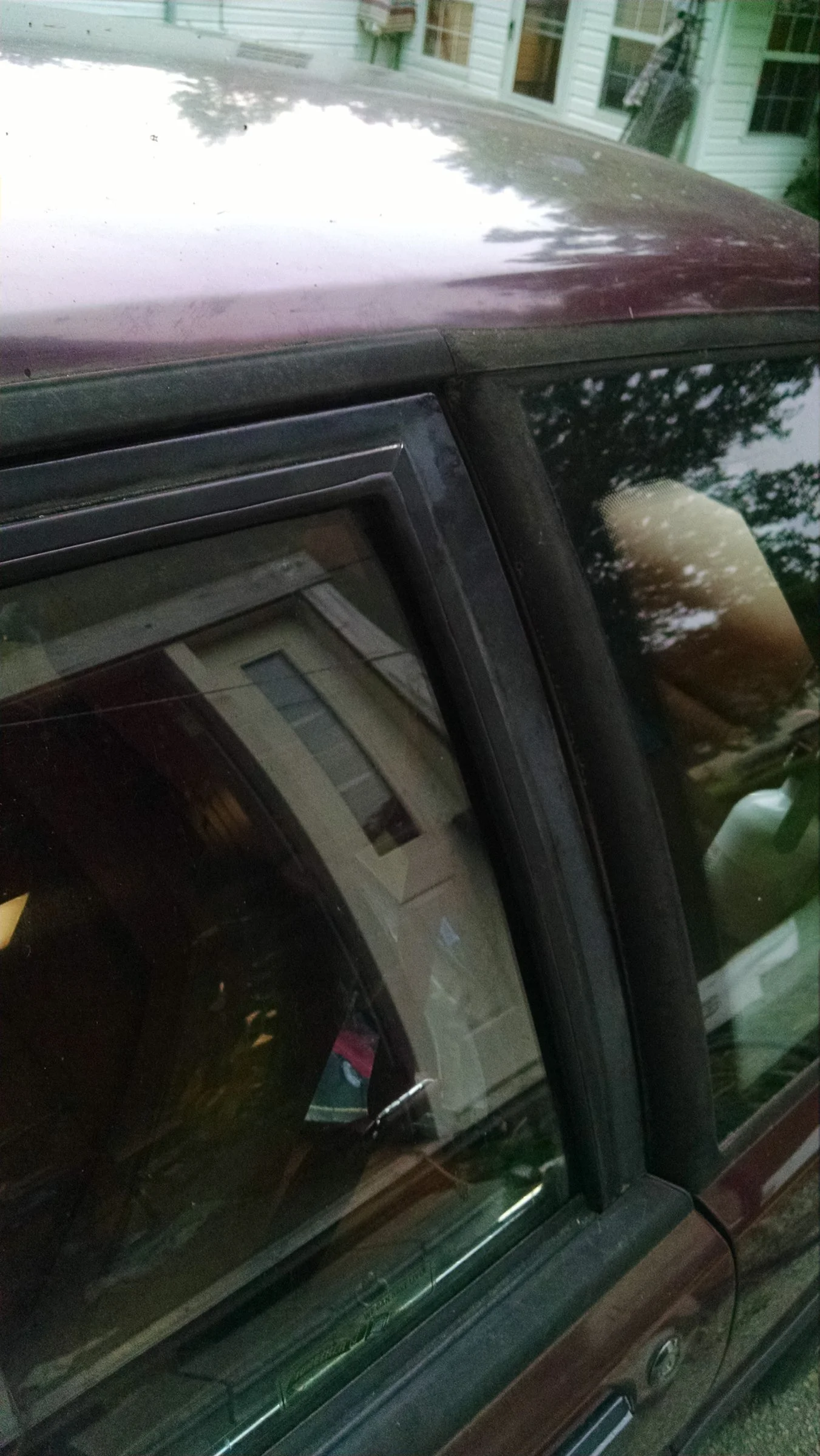

Got the driver side belt molding done. Indiana must be hard on rubber because this stuff literally crumbled.
When I did the drivers side door pins I aligned the door pretty good. The passenger door is too low and the gap between the quarter and the door is a hair too big. In these pics you can see the difference in the two gaps above the doors.

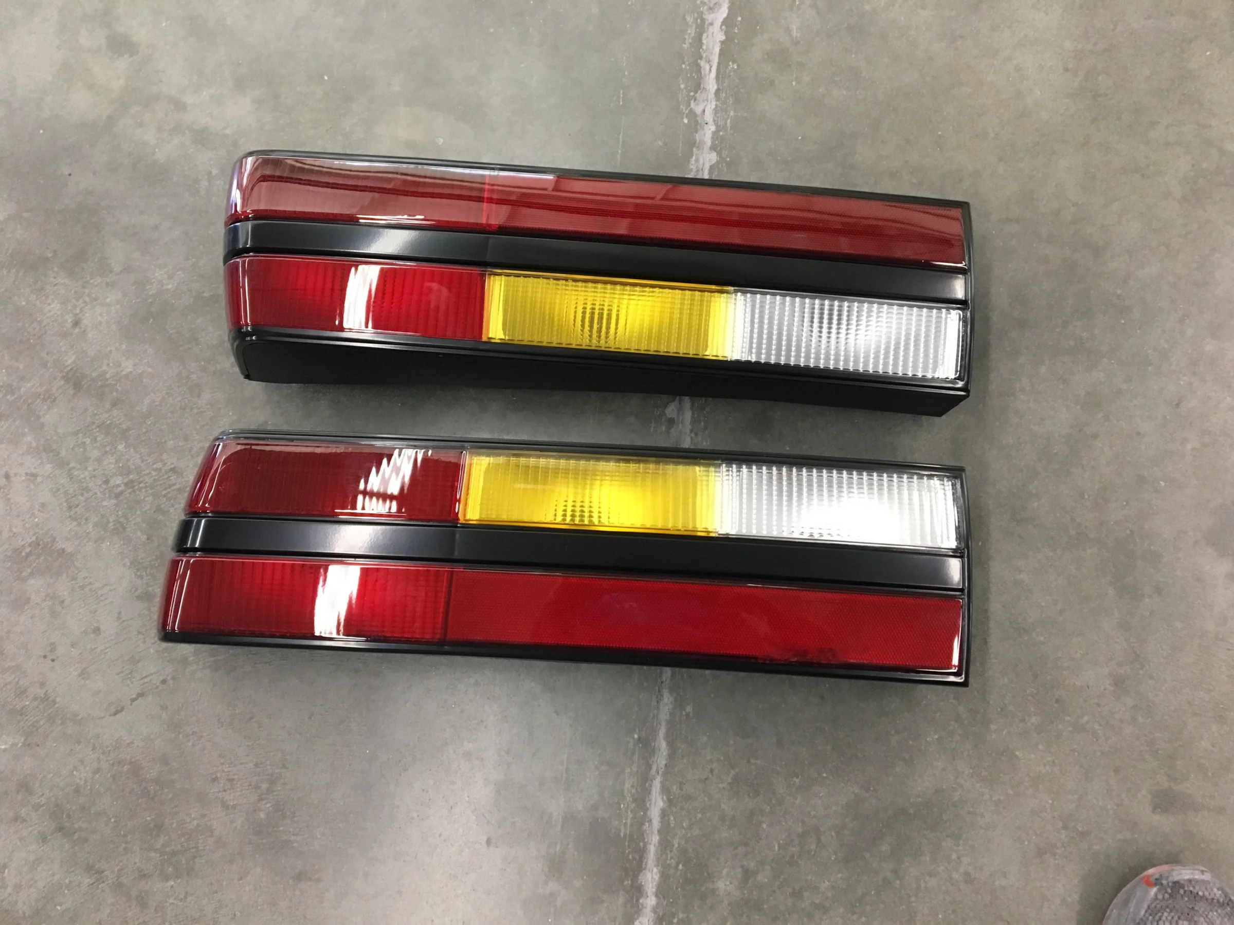

@karthief Do you still have a drivers side LX tail light laying around ? The more I look at these clear tail lights the more I hate them. :bang:
Mine is cracked and I'd rather just replace it than to fix it.
Go with the '83-'86 style Scott. They're the nicest looking ones.:nice:
Why yes, yes I do. Pm me I think it's lonely and needs a home.
