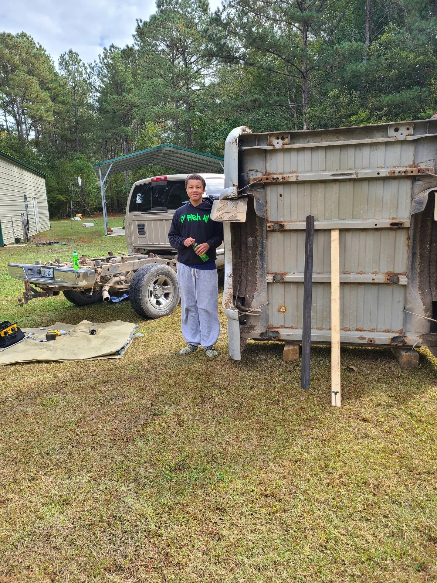

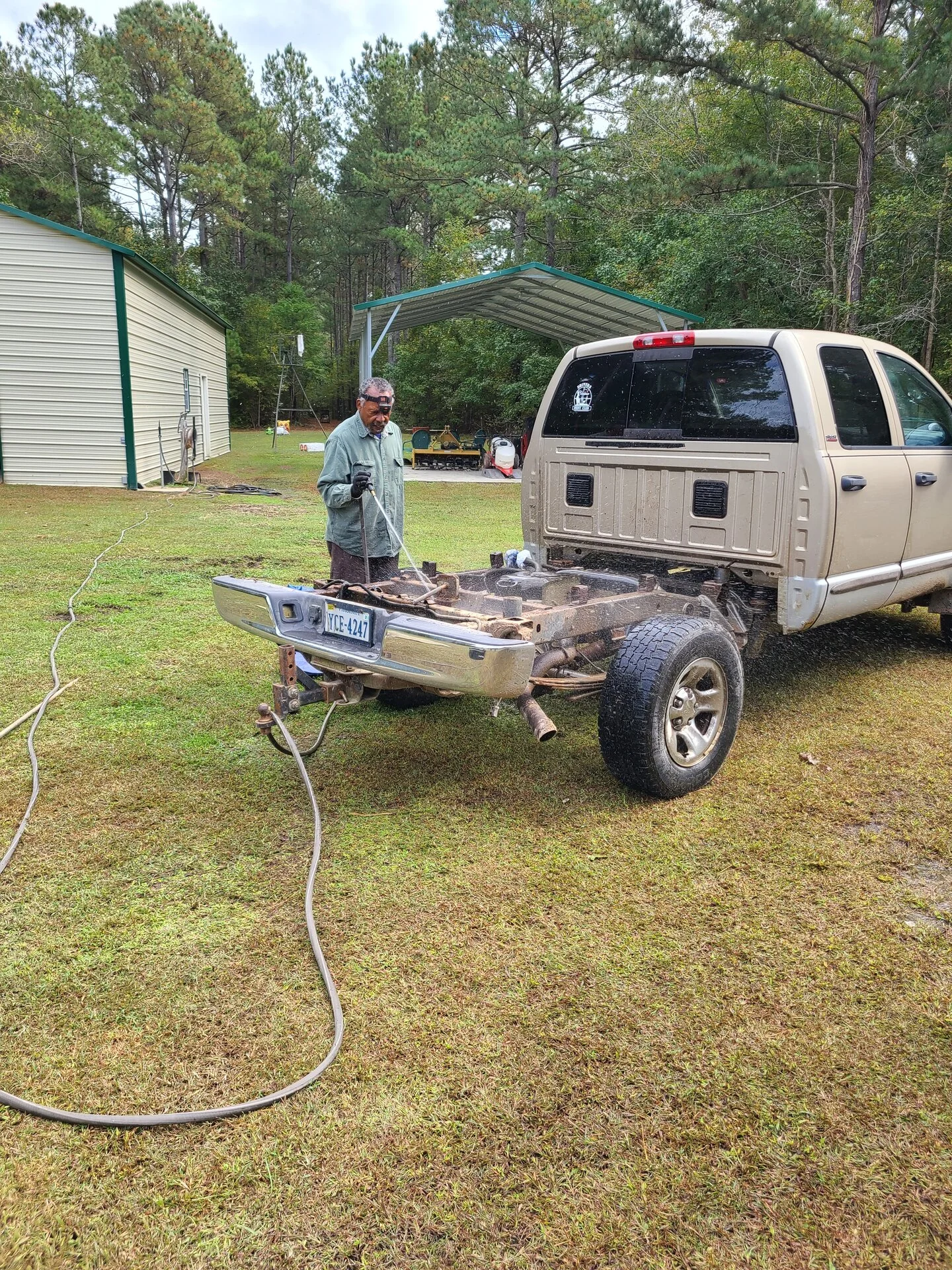

Just got back from my farm...this is what I spent all day doing on my fathers 02 Dodge.
Thats my Dad and one of my sons.
His bed is as collapsing and major rust around wheel wells. He's going to clean and por 15 the frame...and I'm going to go back and cut the rust out of the bed and do the body work.
We got angle iron to weld on the braces but the bottom rail needs 3x3 angle. He had a guy fix some rust on the sides years ago but the idiot put spray foam as a backer for the bondo. I'll fix it so he gets another 5 years out of it. Its too far gone for more than that. It'll get a stake body at that point.

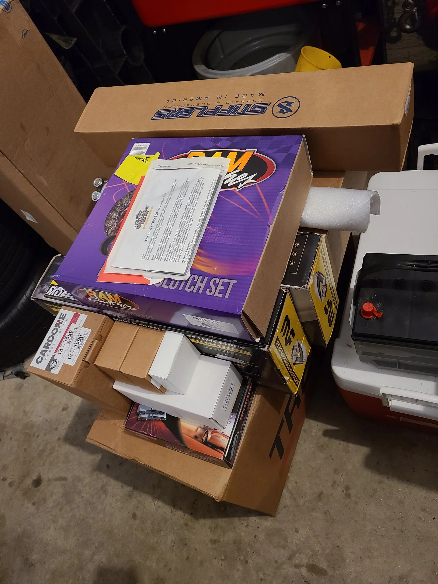

I wonder what I'm going to do with the other complete set up. All I need is a flywheel and a carburetor and I'll have a complete engine and transmission sitting in the corner with long tubes.

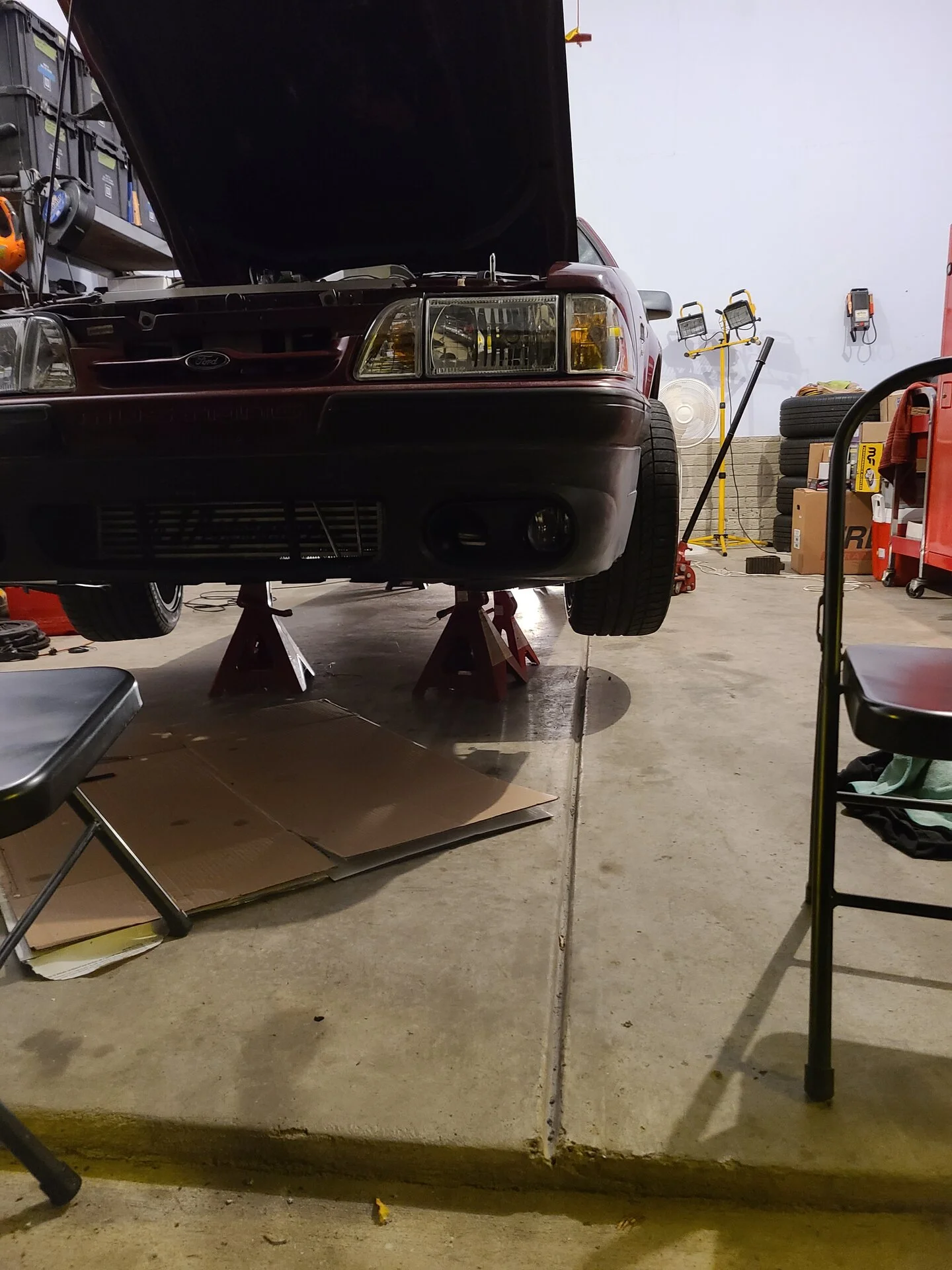

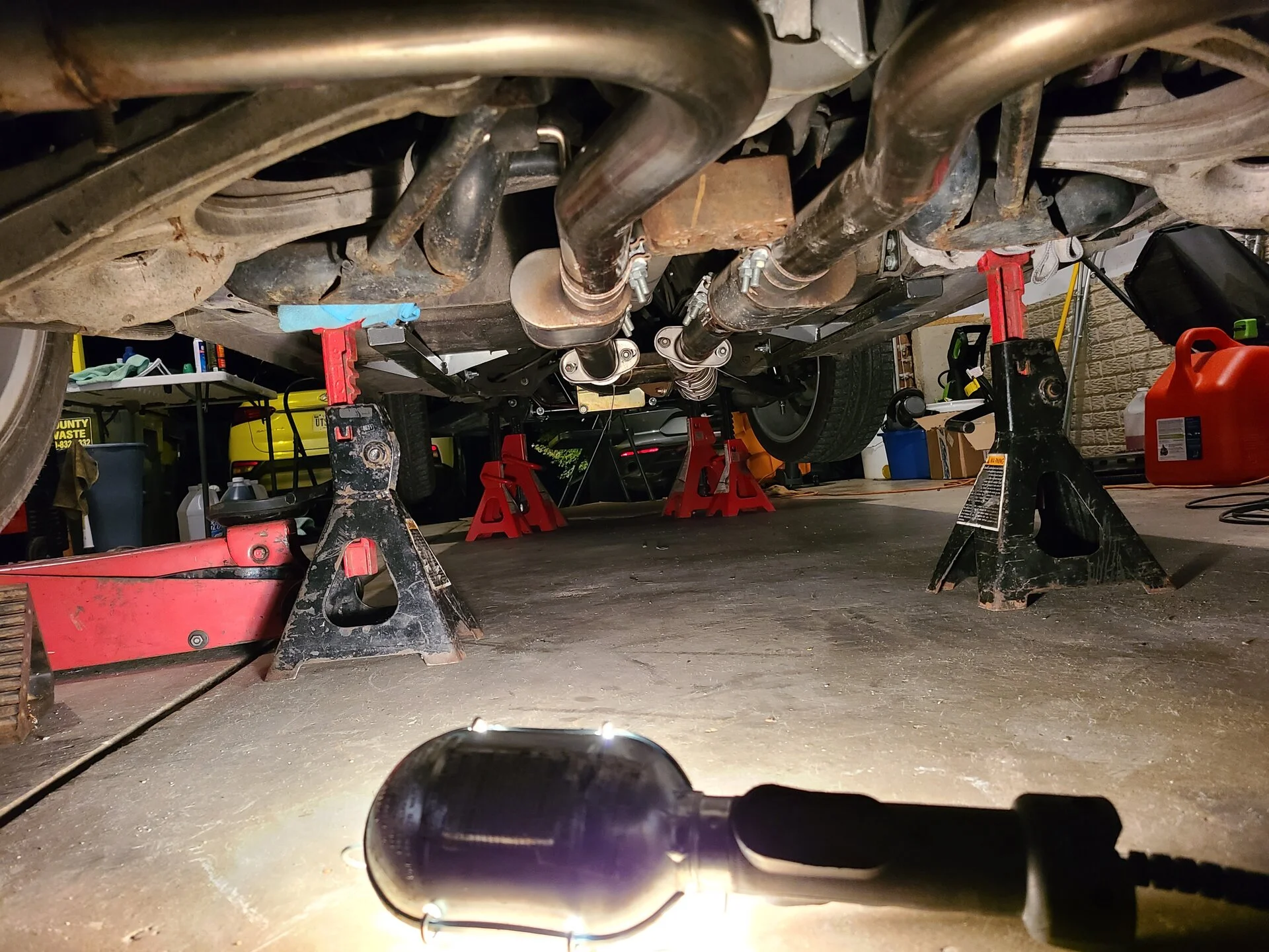

Had a wonderful day at work today. Decided to come home and do this.
It was a super sketchy operation getting the car this high. I'm using 6 jack stands. Trying to make the turbo car hall of fame without being crushed.
I managed to get the t5 fluid drained. Slowed down when I saw the several scars on the old driveshaft. Just a bunch of old stuff I forgot about. It didn't vibrate and has held up over the years but the groove is about 1/16ths deep...thats a lot to put over 500hp through. No one has a replacement except CJ Pony...that I'll never deal with again...and JEGs. Their driveshaft has a hybred 1310 to 1330 u joint at the rear flange. I've been searching for a 1330 flange so I can swap it out for the proper bigger u joint.
Also, I realized that I had the driveshaft shortened so the transmission seal would ride in the same exact spot that it did with the solid axle. Don't know why I didn't just change the yoke. It was a little surface corrosion on it so I didn't want it to tear up the seal. Smh. It worked though...never any leaks from there. I seem to remember only having a very little amount of room between the end of the yoke and the seal. We'll find out when I get the new shaft.
Sometimes I just can't remember things the right way. Frustrates the hell out of me. I feel like I remember but my details are all jacked up. Then I look at something and realize what actually happened....like I wasn't there in the first place. I've been getting better though.
Like just now....why would I buy a 1330 flange when I already have one on the trashed one thats coming out of the car.
