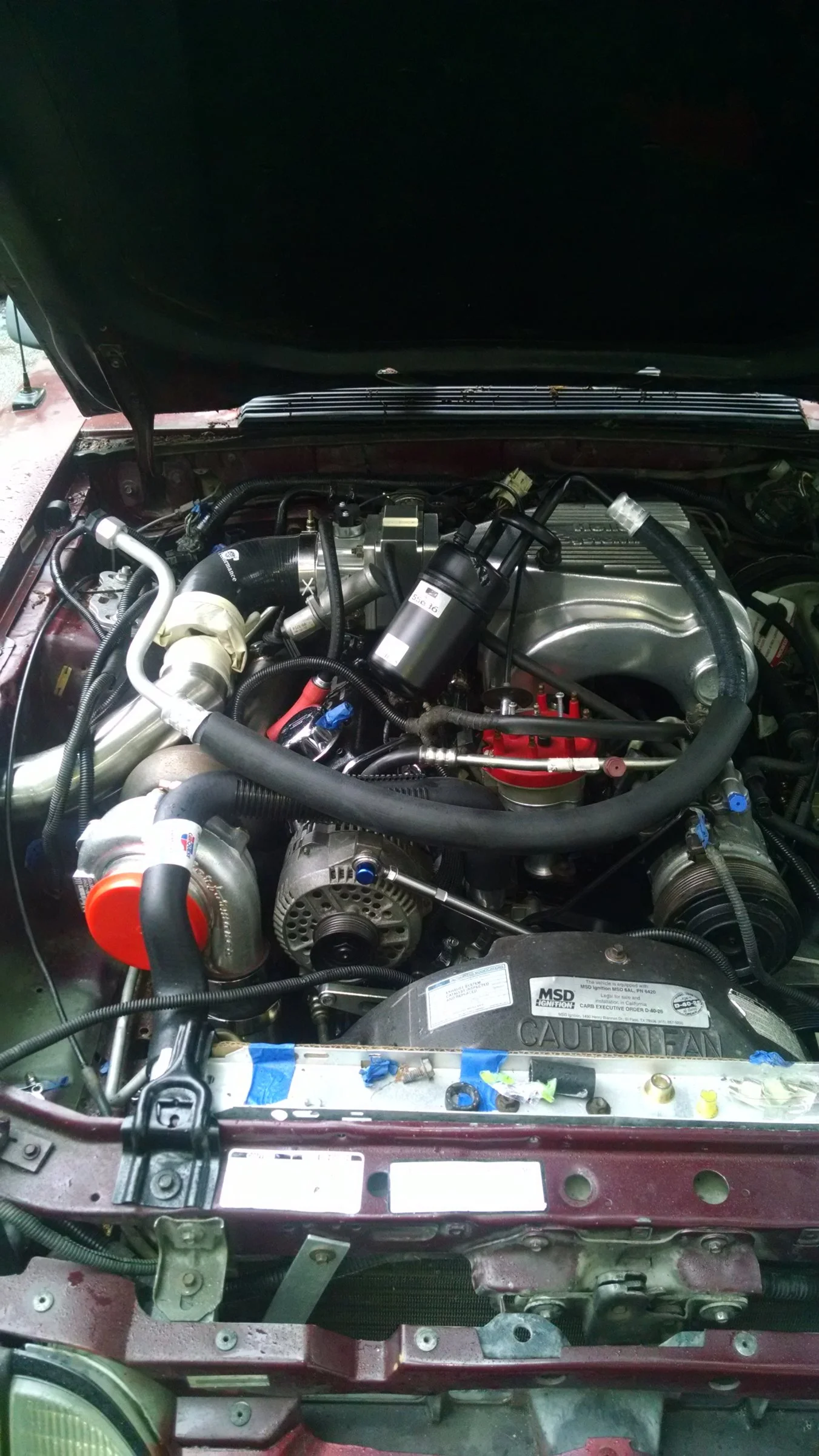

Thanx man... Did you have to bend the pipe where it screws in the evaporator ? Or did it just rotate enough to line up ?
Man it all took tweaking and massaging. The line that runs along the frame rail with the rubber flex joint actuall failed from heat. I bought some 1/2 stainless tubing and swagelok fittings and grafted in a rerouted section.

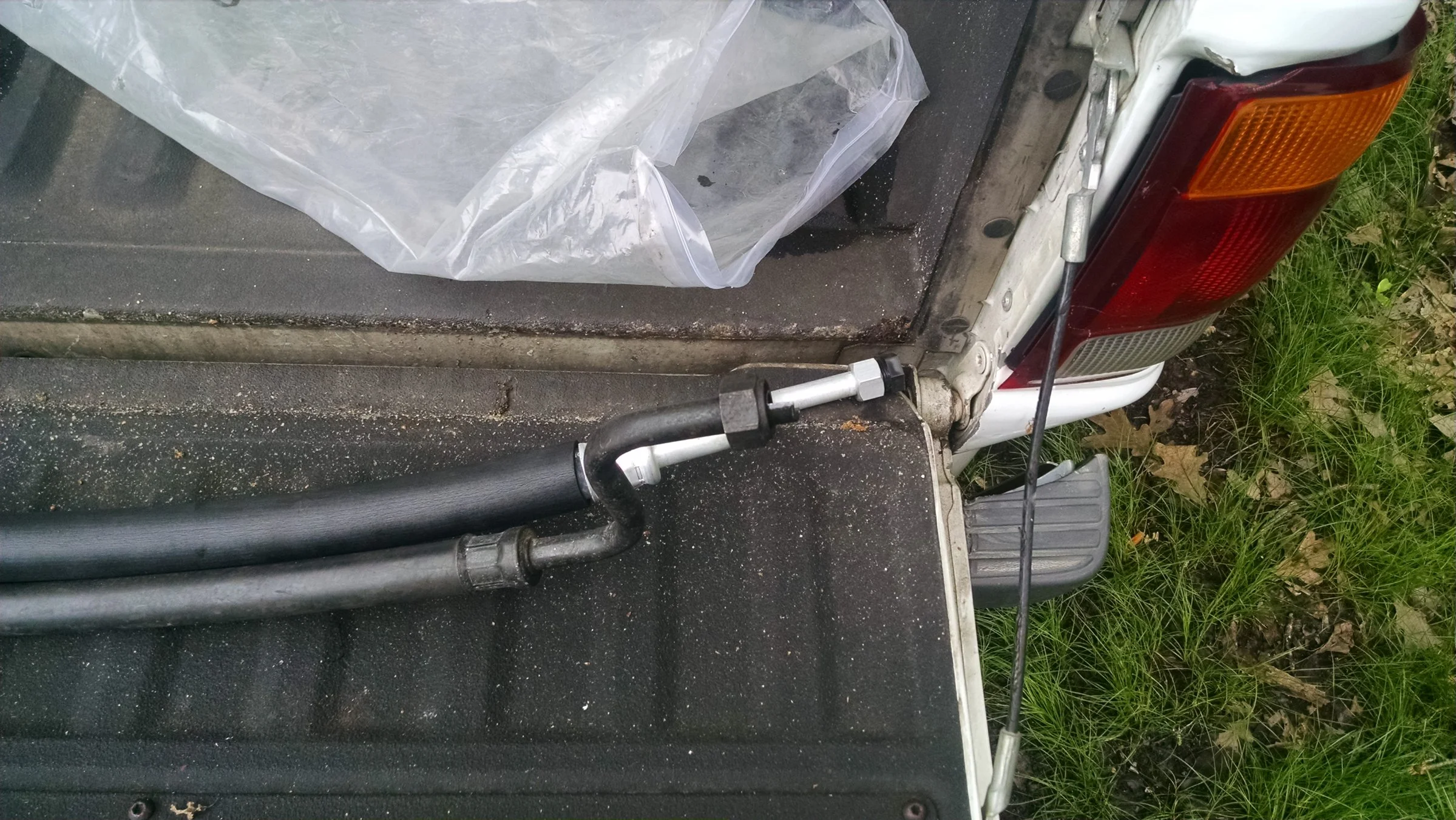

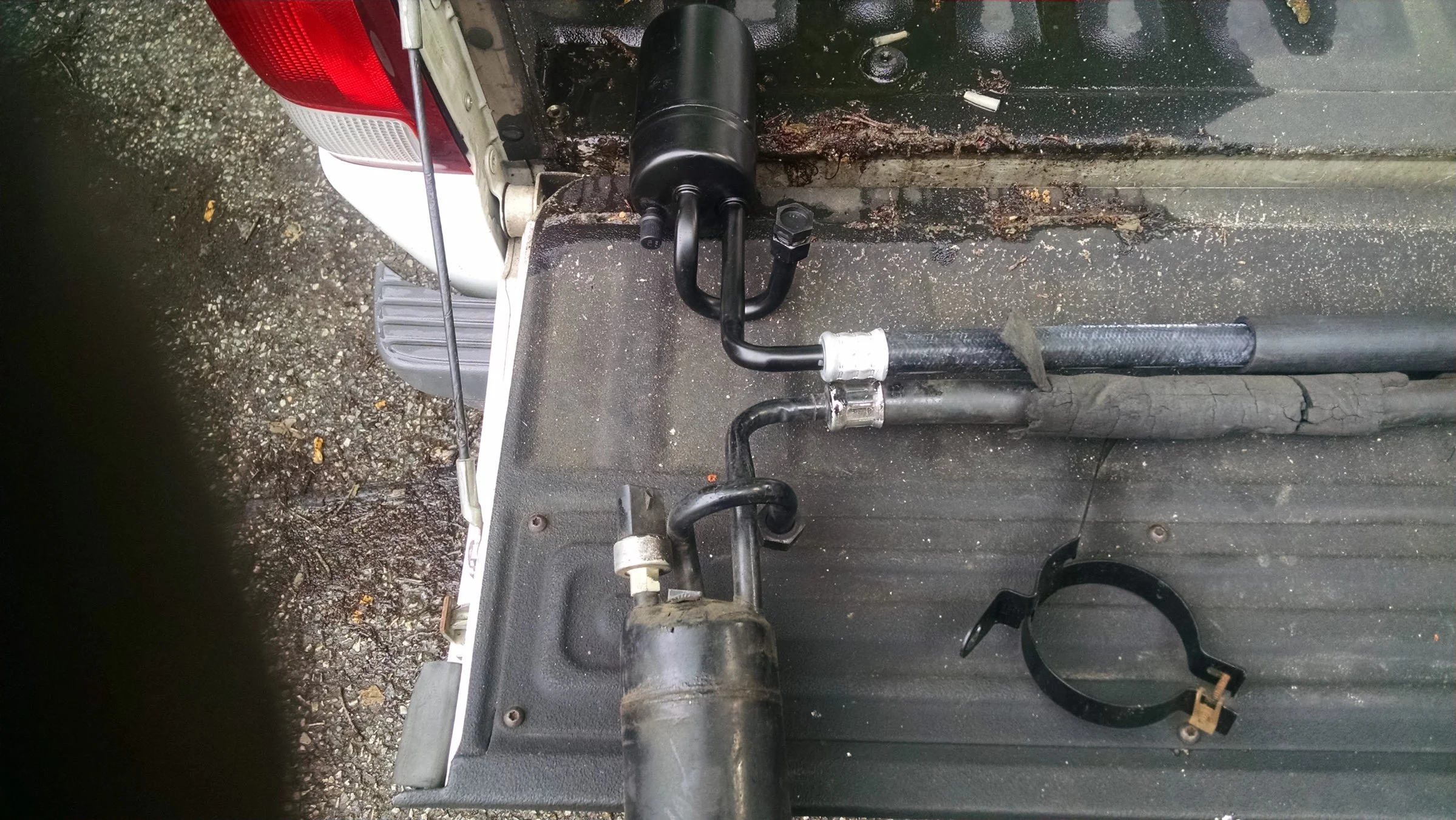

This morning I picked up the new accumulator. The hose is longer than the original....very happy about that.

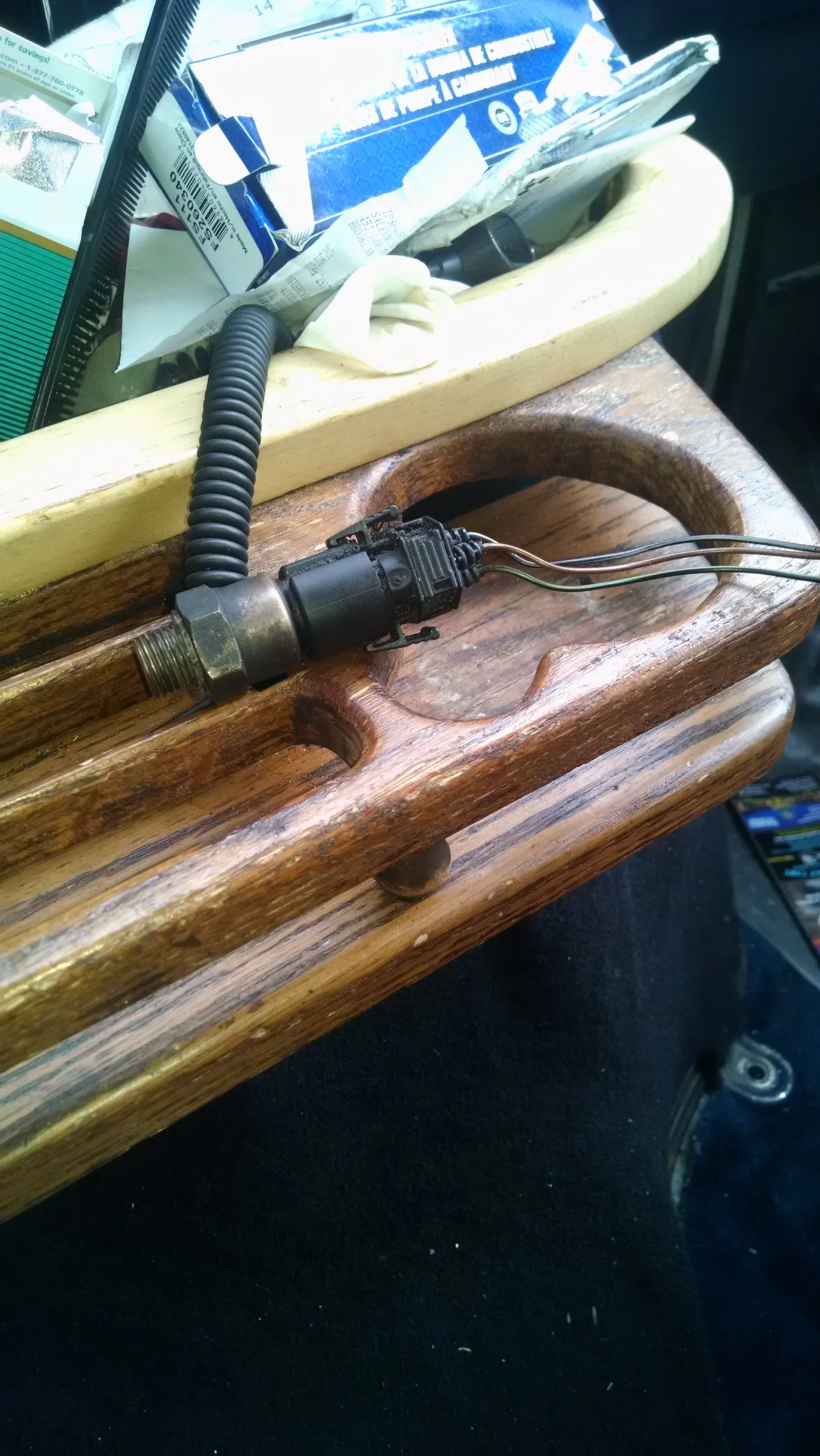

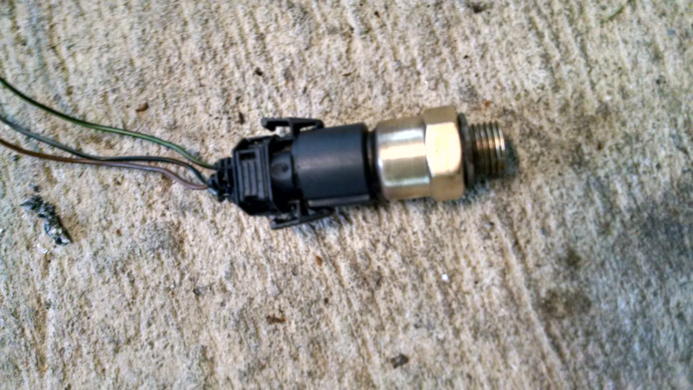

Sensor checked out good and cleaned up well. Low speed makes contact at 182° low speed shuts off and high speed starts at 208°. View attachment 557285 Thinking about tapping my T stat housing for this thing....not sure yet.

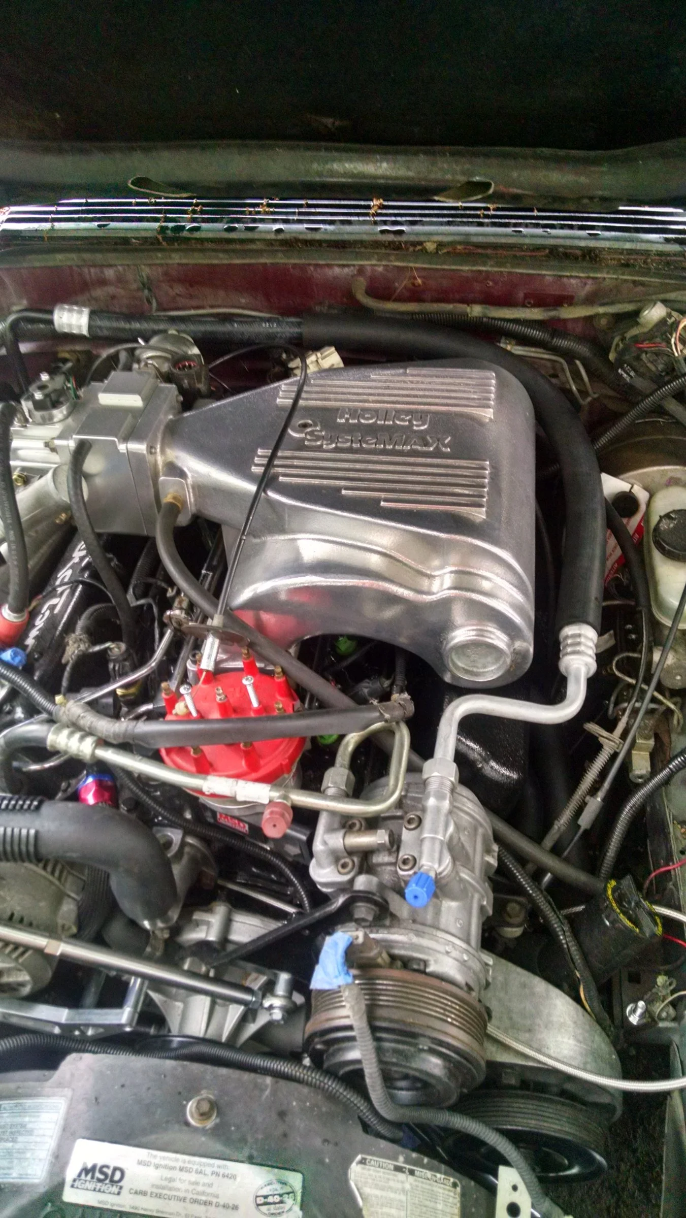

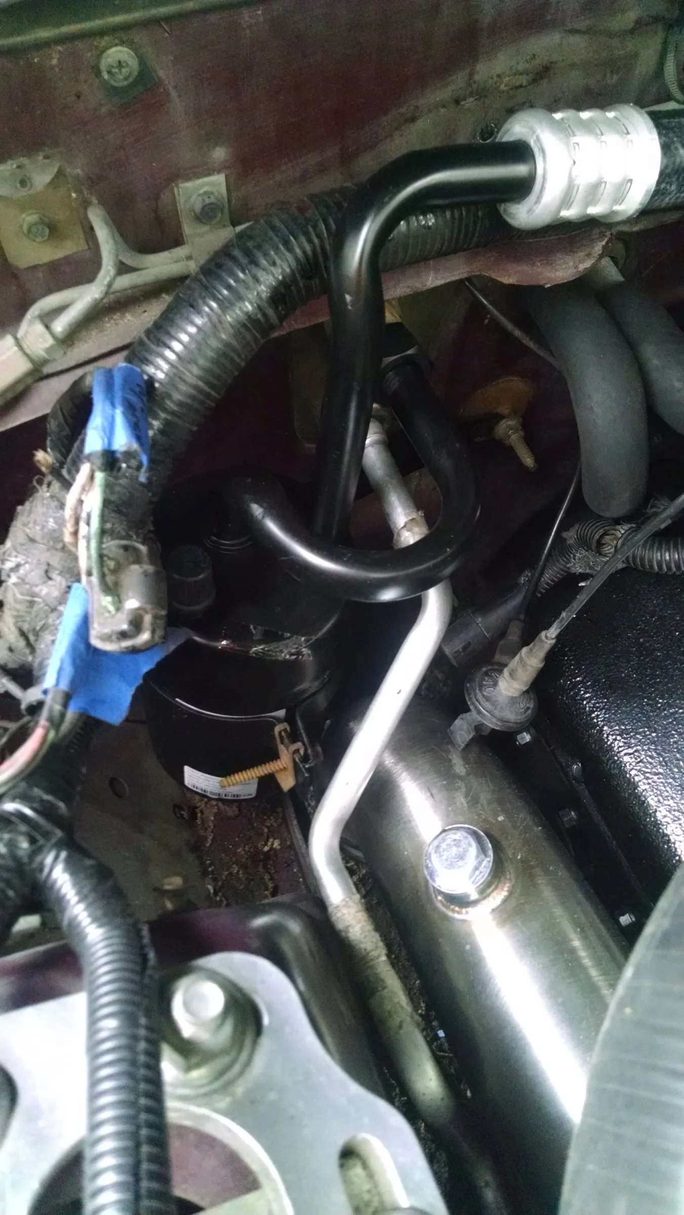

@Boosted92LX the new accumulator did fit after altering the bracket. Simple and functional. ( would post pic but I'm at Applebee's and they won't load )

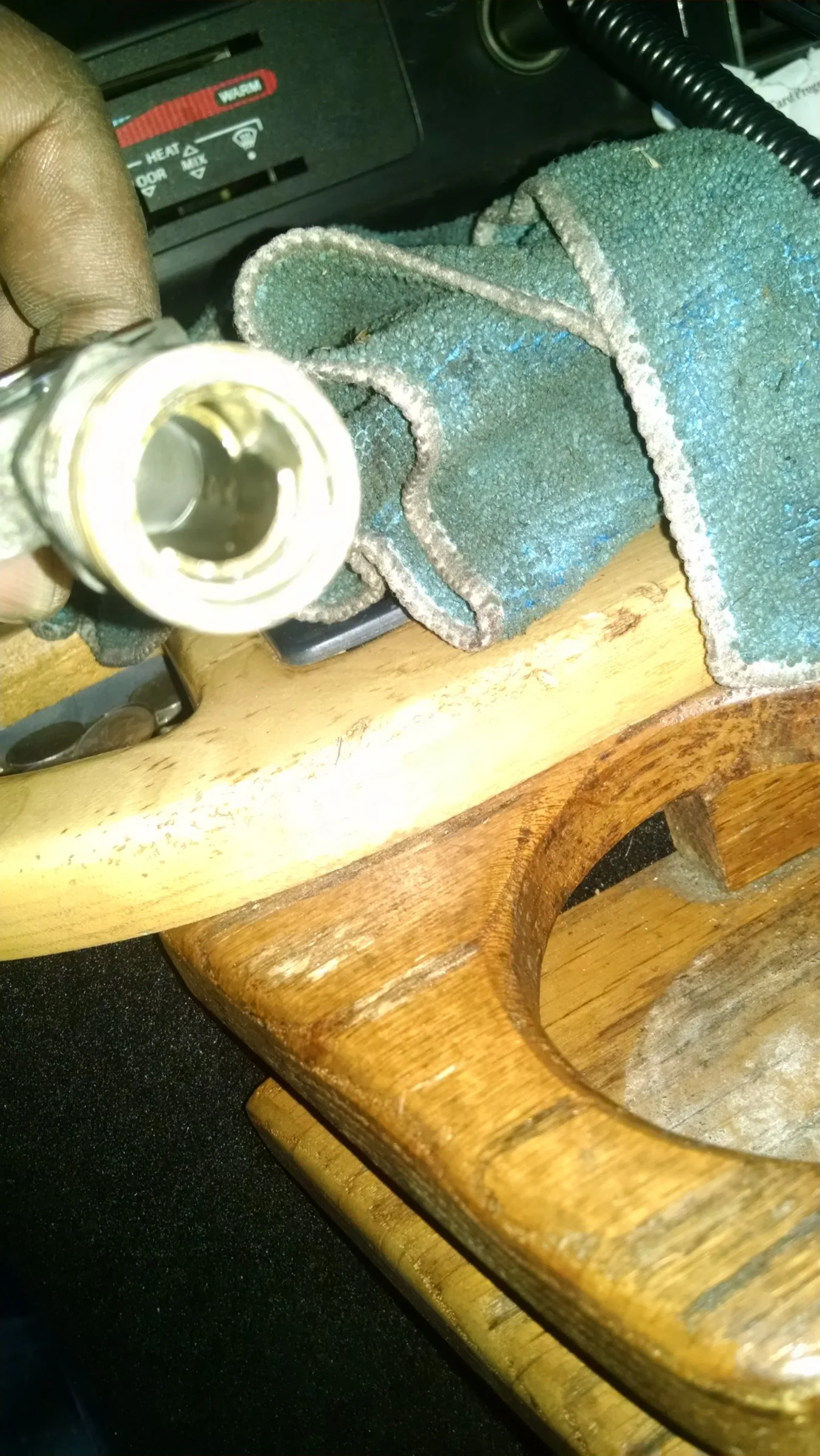

The ac line from the accumulator is different from the factory where it connects to the compressor. The original line has a notch in it and there is a piece of metal in the fitting that it lines up to. I removed the fitting off the compressor ( 2 Allen bolts ) and tapped the inserted metal piece out with a bent screw driver from the inside....being super careful not to damage the ring that seats the orings. PITA....but its done.

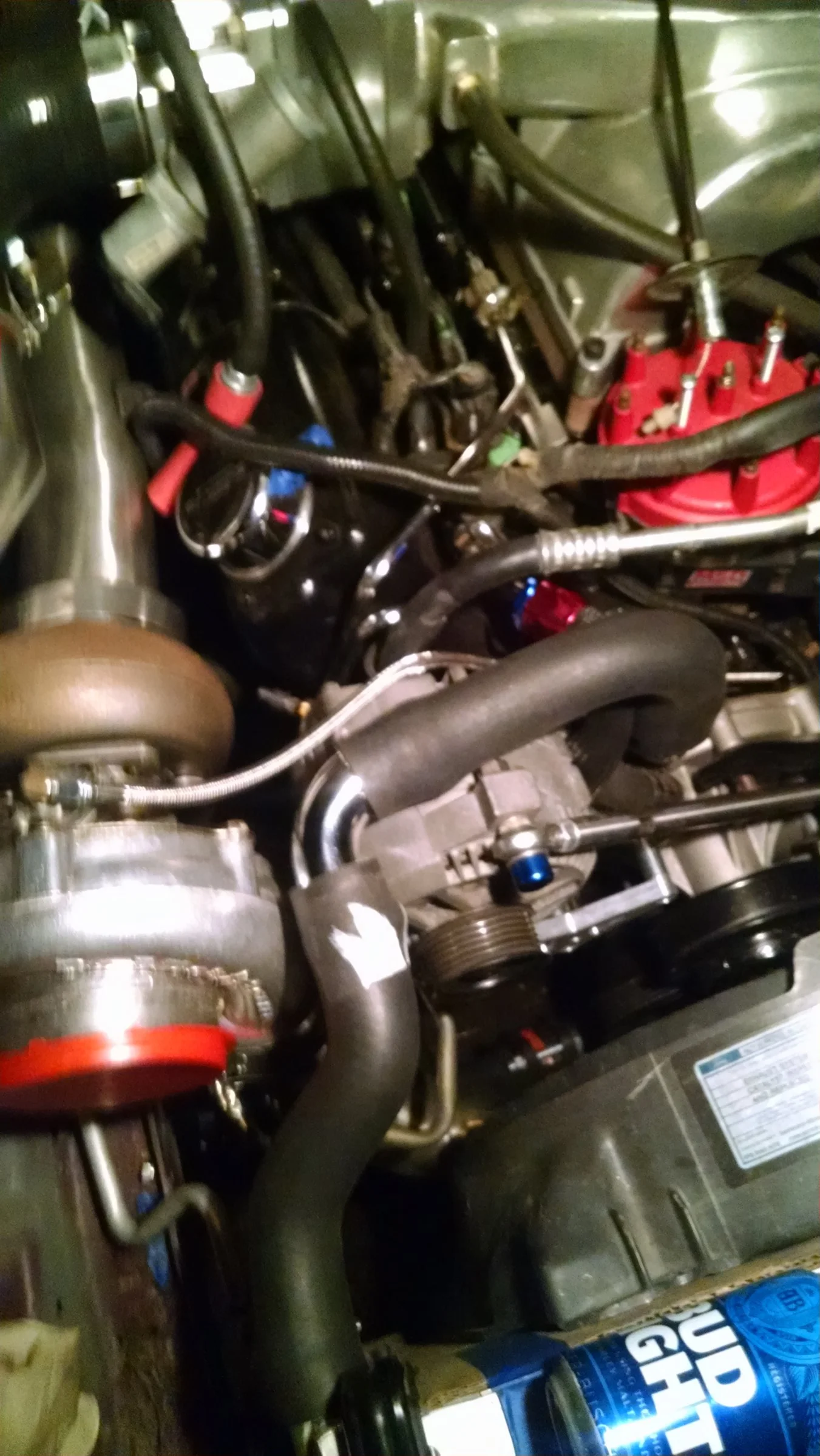

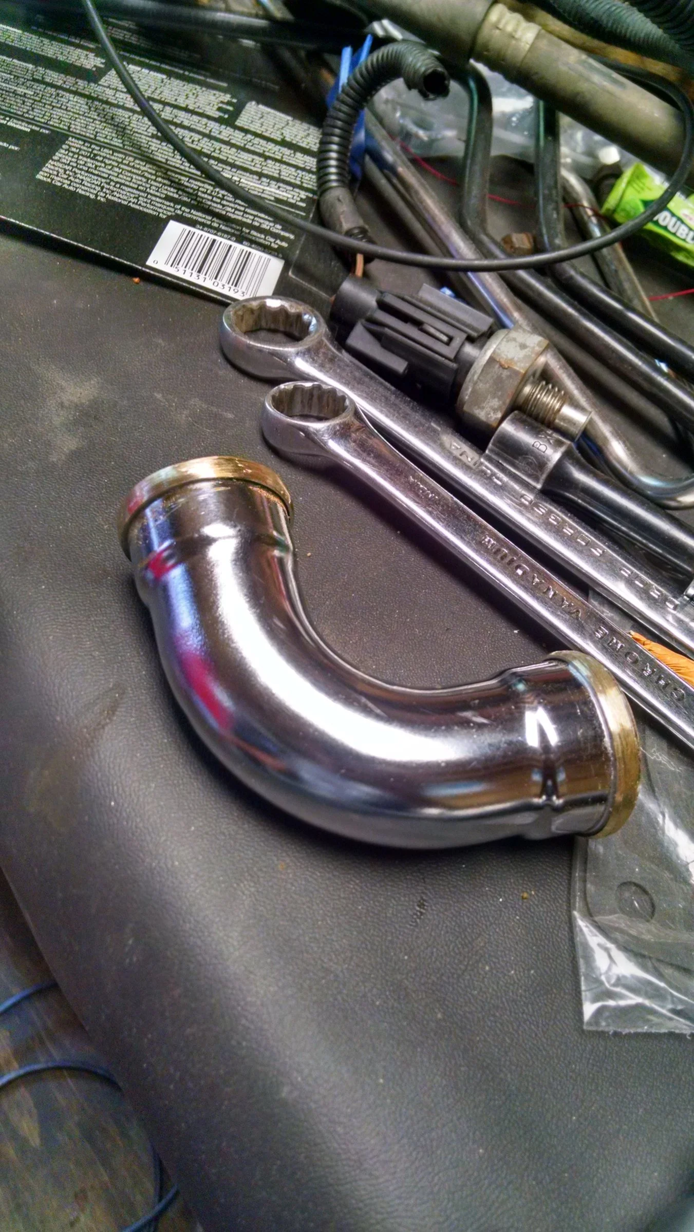

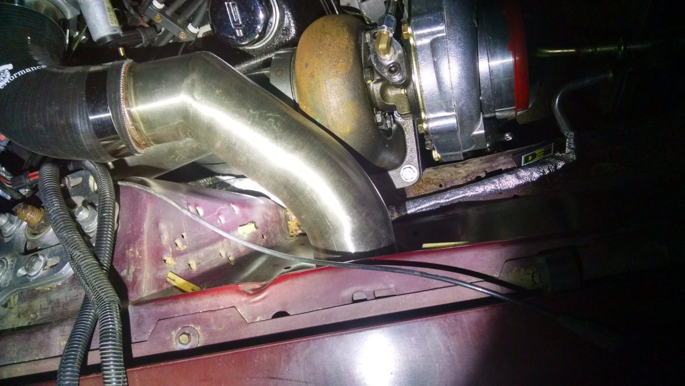

I also got my intake pipe extended and it fits great. I was going to lengthen it behind the fender and open up the hole it runs through...but decided not to do that. The pipe sits about 1/4 inch from the turbo...just enough room for the blanket.
If I decide to go back NA ( not likely ) I wanted as little modification as possible to the inner fender panels. Once its cut there's no turning back. Not ready for smooth panels yet. Lol

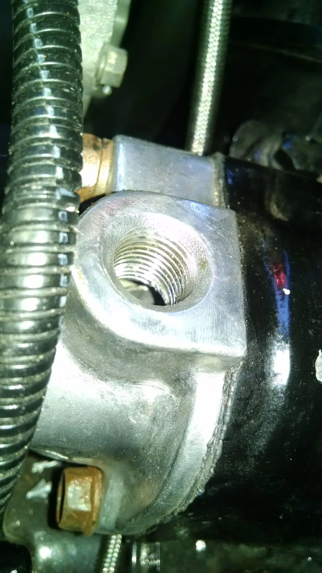

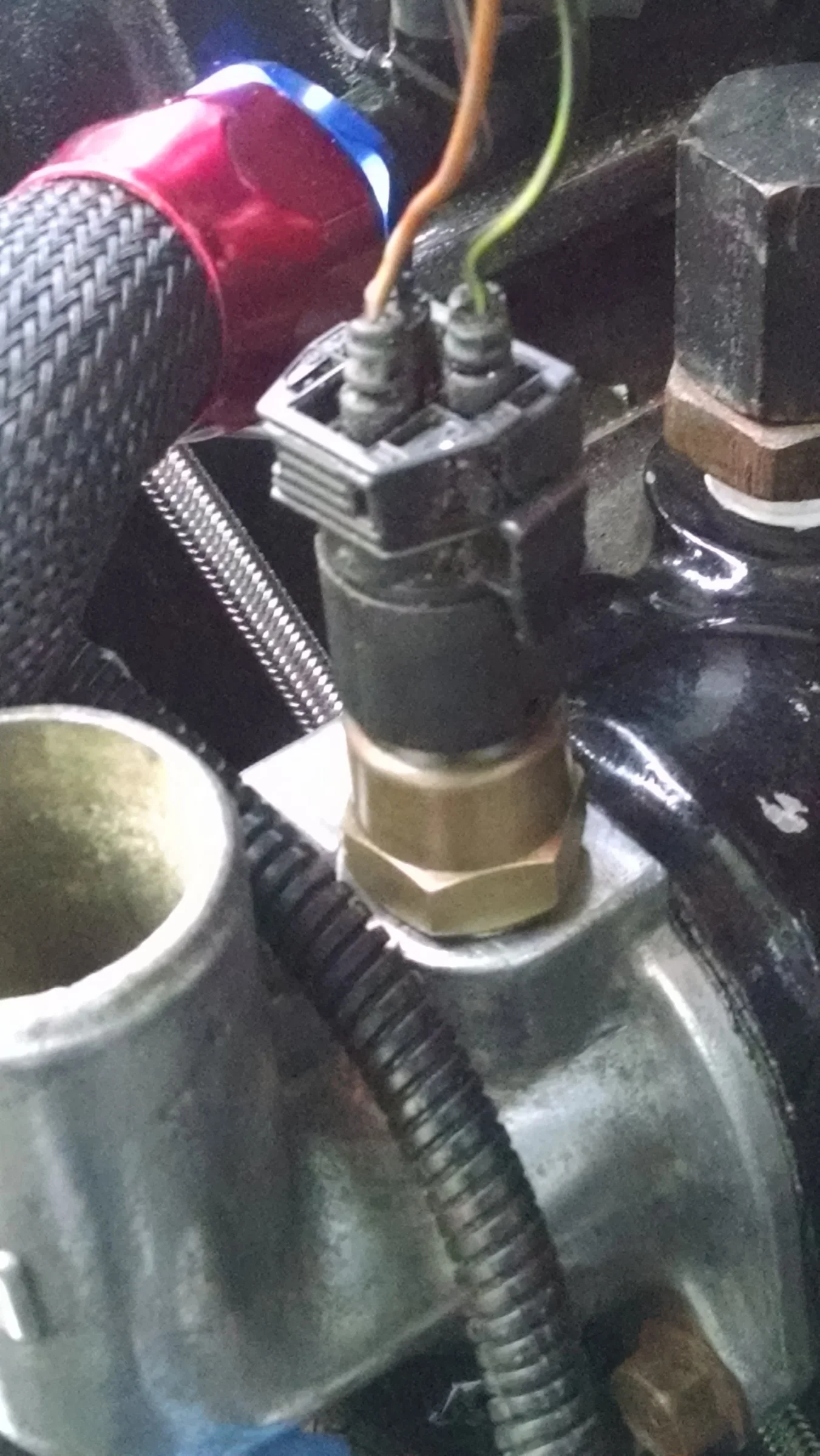

Tapped my thermostat housing for 14mm 1.5 thread. Bolted in no problem. Used a lot of grease and a shop vac so I didn't remove the housing to drill and tap. Yippee !!!
