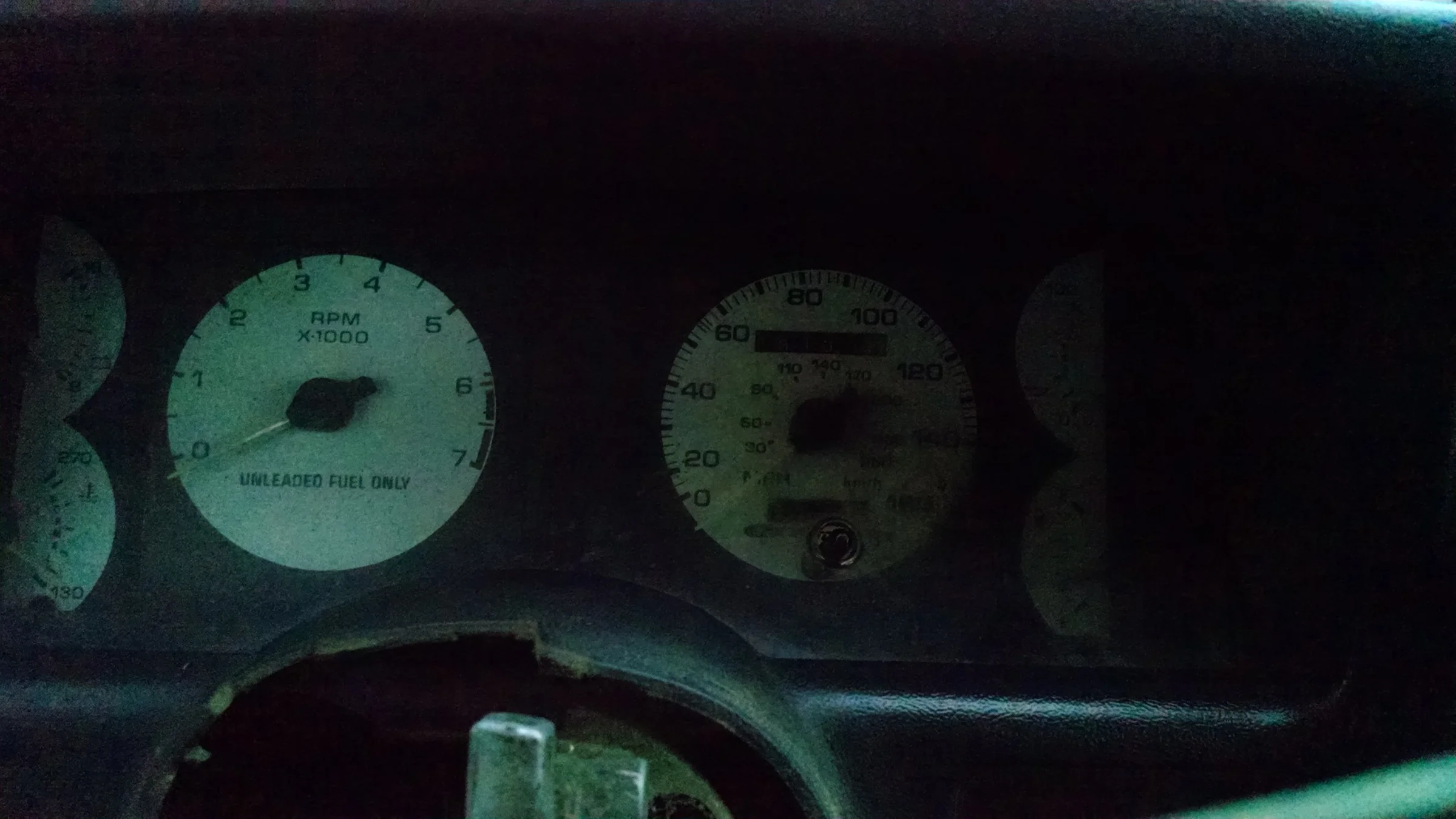

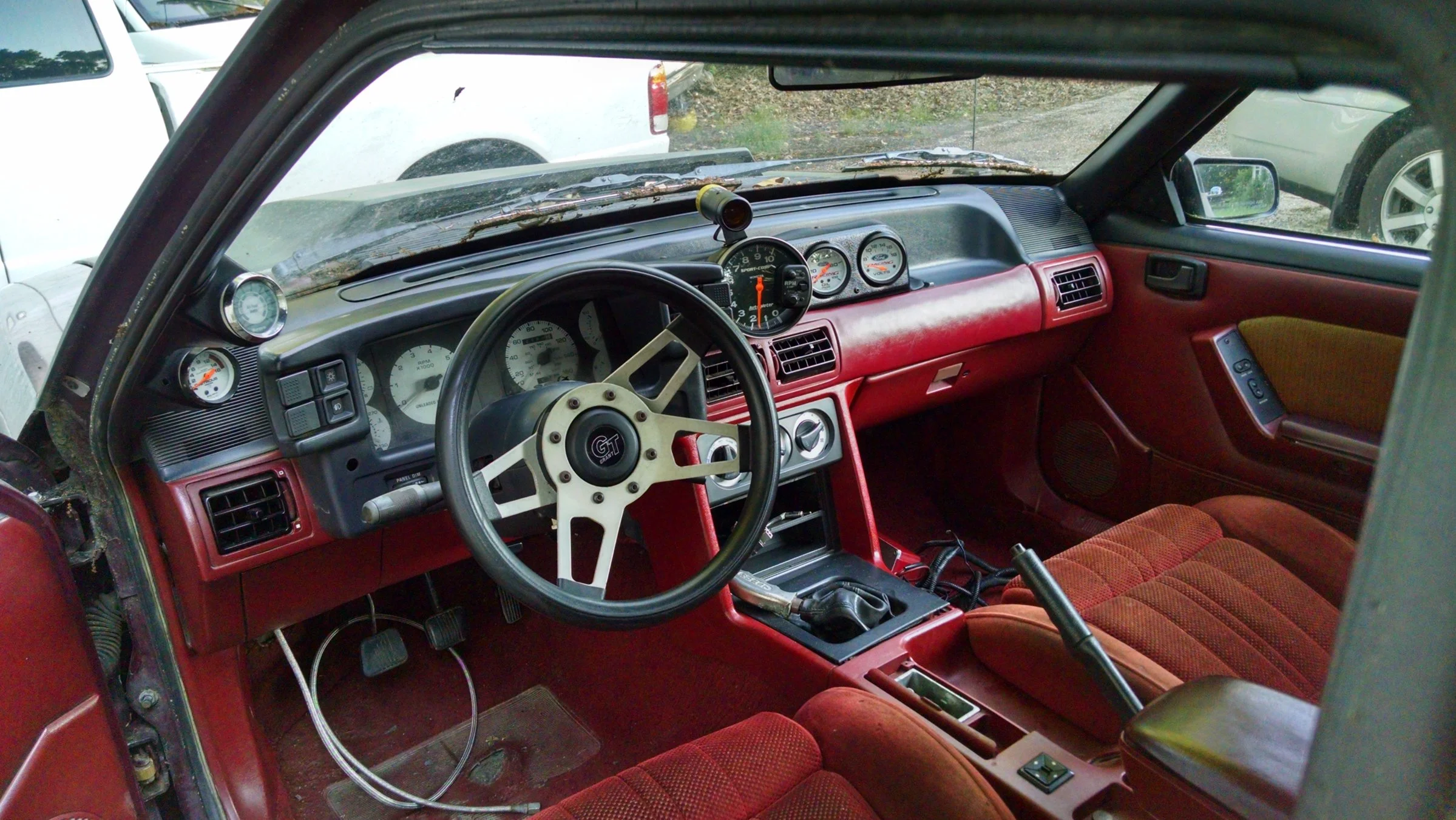

Got my 160mph Ford Motorsport gauge cluster in. I want to get a new cluster lens....this one is scratched and the one that came out of Dusty is....dull....and dusty.

The trans is in....clutch cable ran. Replace the clear cover on my gauge cluster. Changed out the speedometer cable and driven gear.

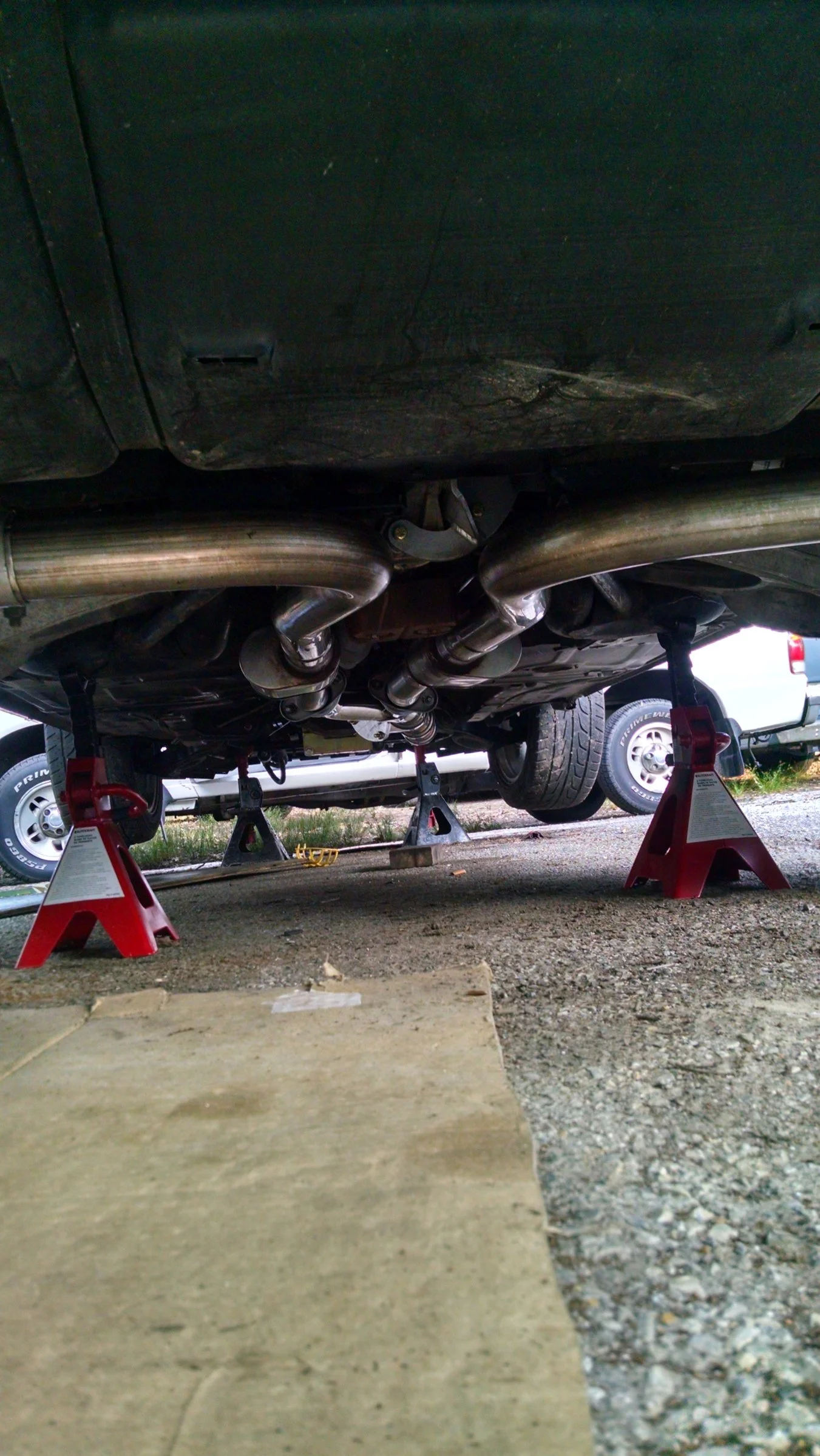

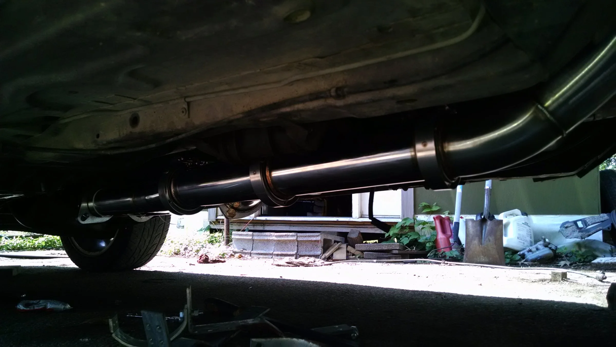

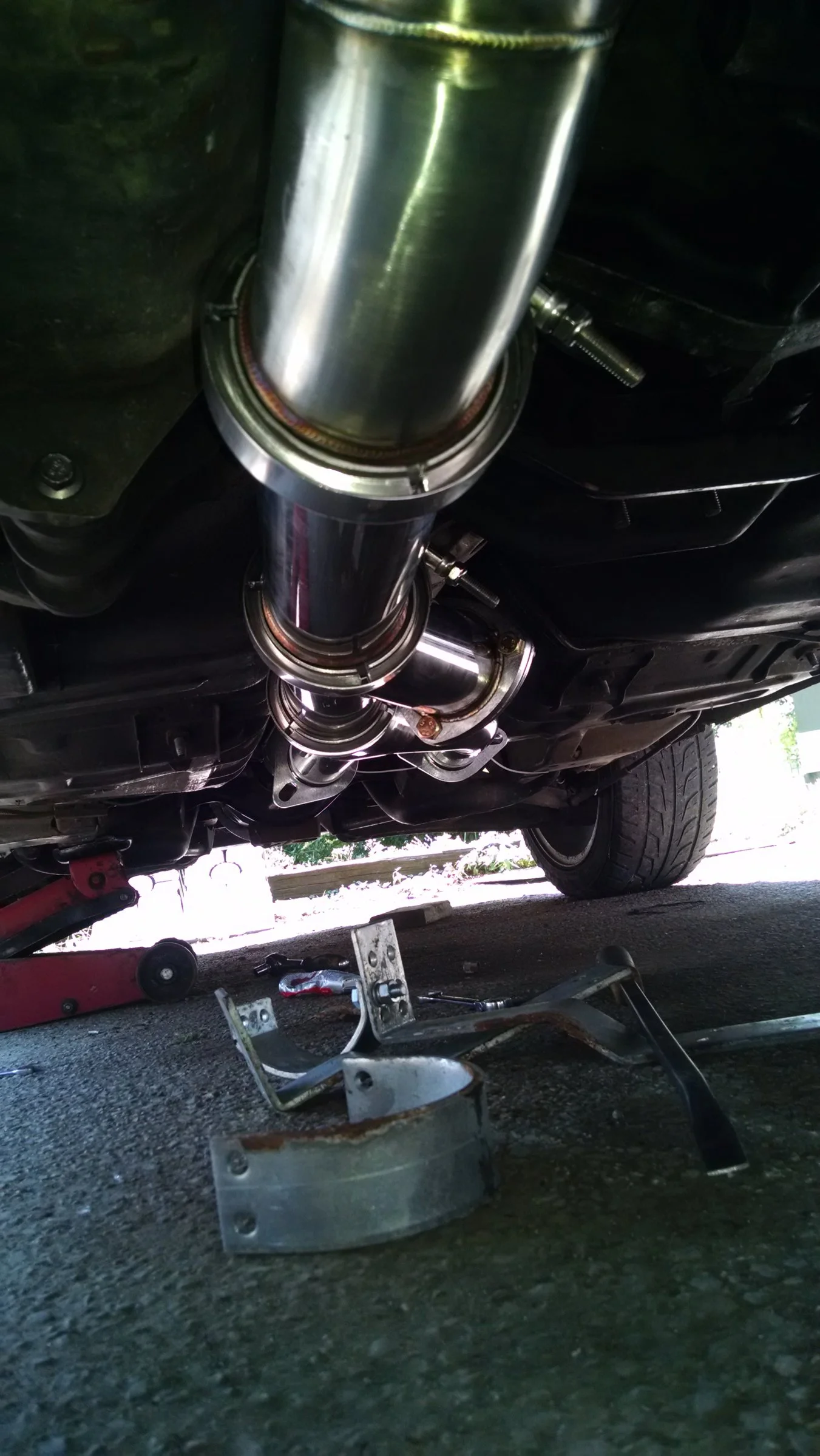

The exhaust from on3 went on without a hitch. It doesn't come with hangers....needless to say, I will be getting a stainless hanger rod bent an welded to support this thing. For some reason I'm not comfortable letting the turbo and flange carry all the weight and vibrations.

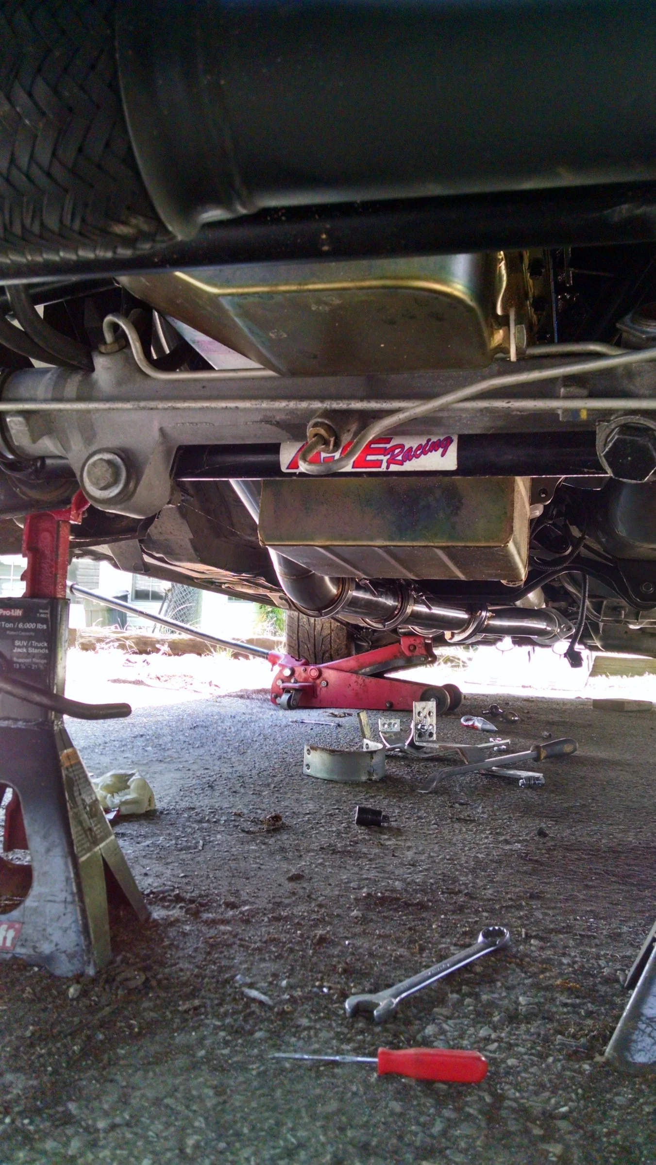

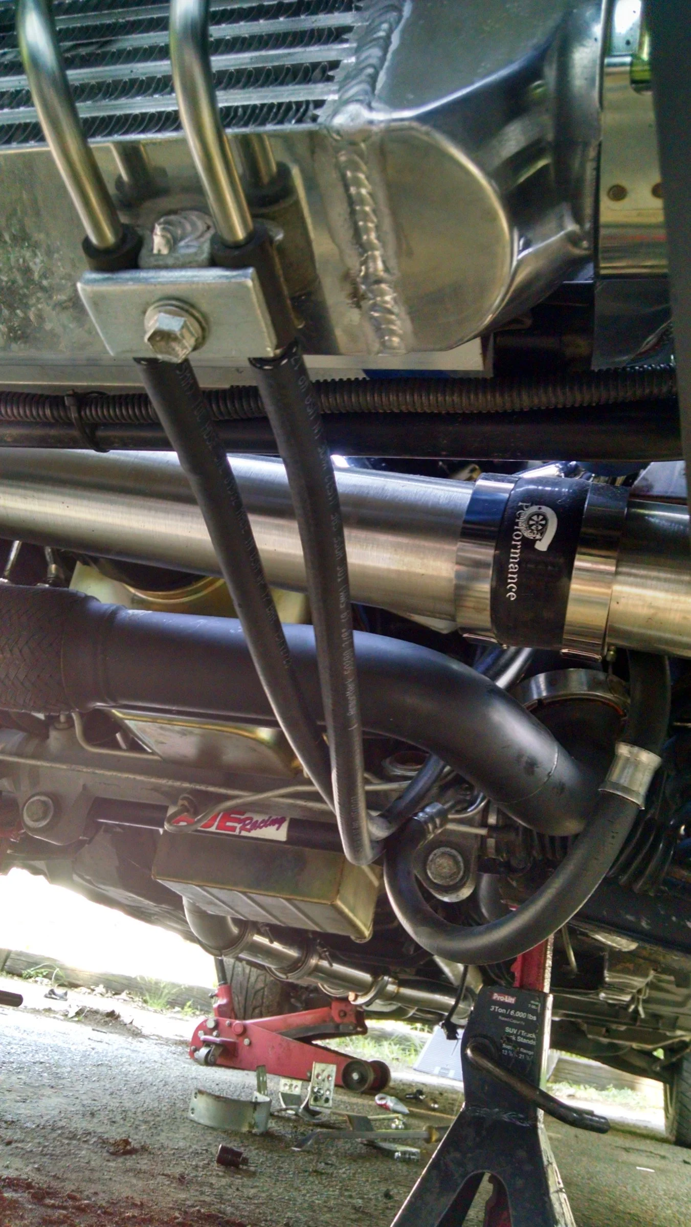

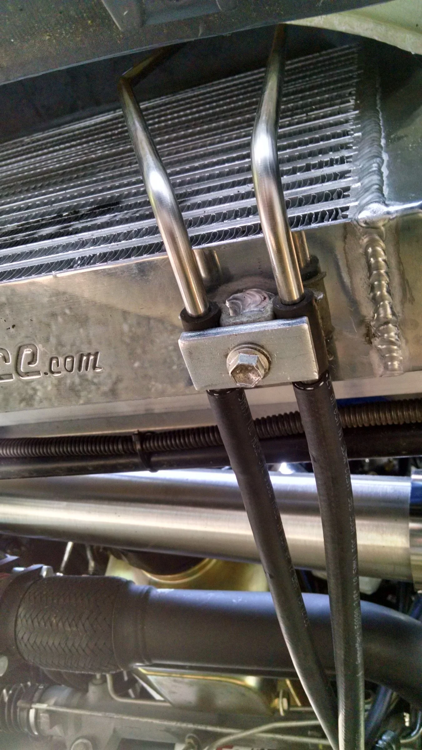

I also ran my power steering hoses and lines...not too happy about using the lower bolt holes on the intercooler but its still above the bumper....

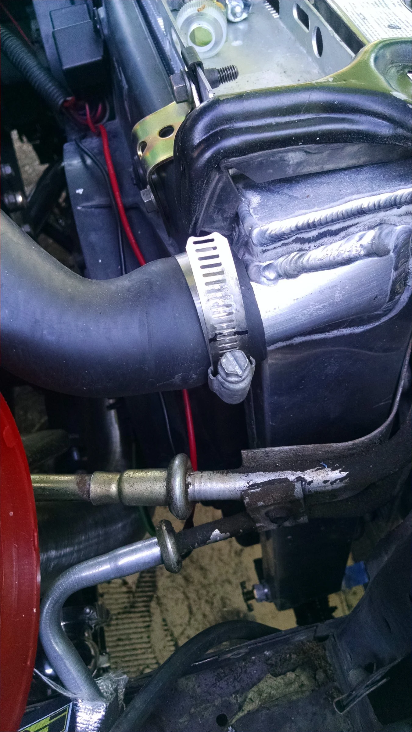

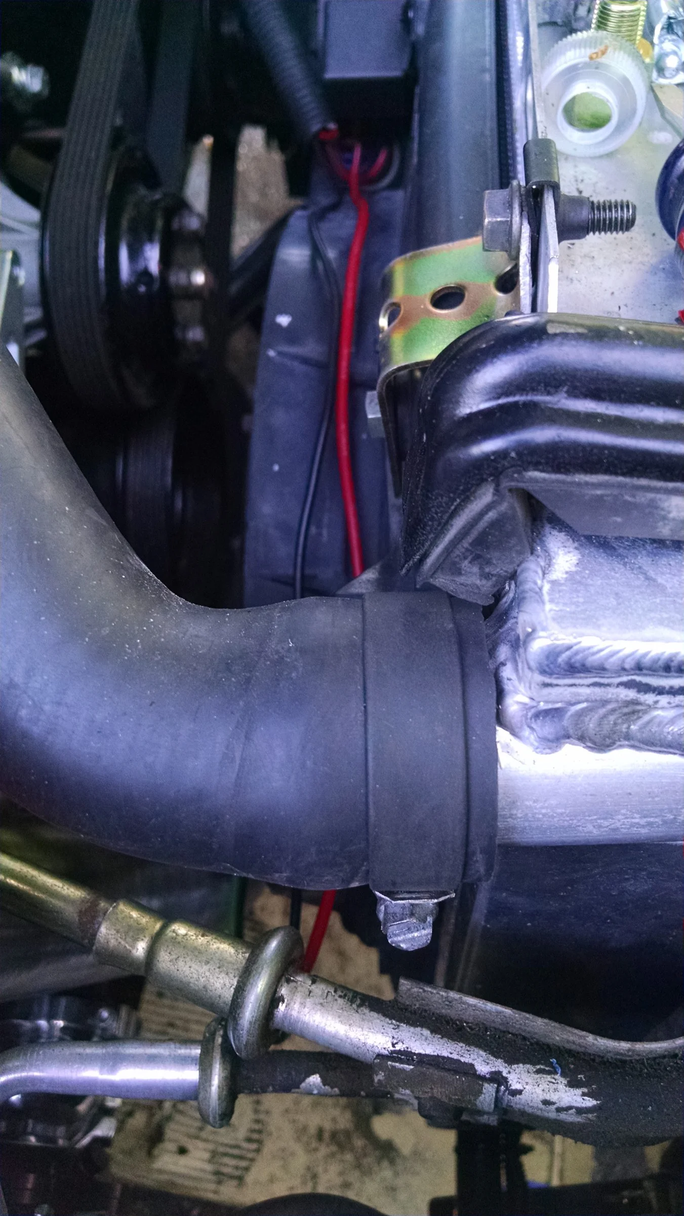

If anyone noticed....I have no hose clamps on any of my rubber hoses. The reason for that is I hate chrome hose clamps. I've been searching for a year for black clamps like the factory 5.0 hose clamps. I have no idea what I'm going to do but I hate anodized hose ( fake ) ends and detest chrome clamps. Doesn't anyone make black hose clamps ?[emoji84]

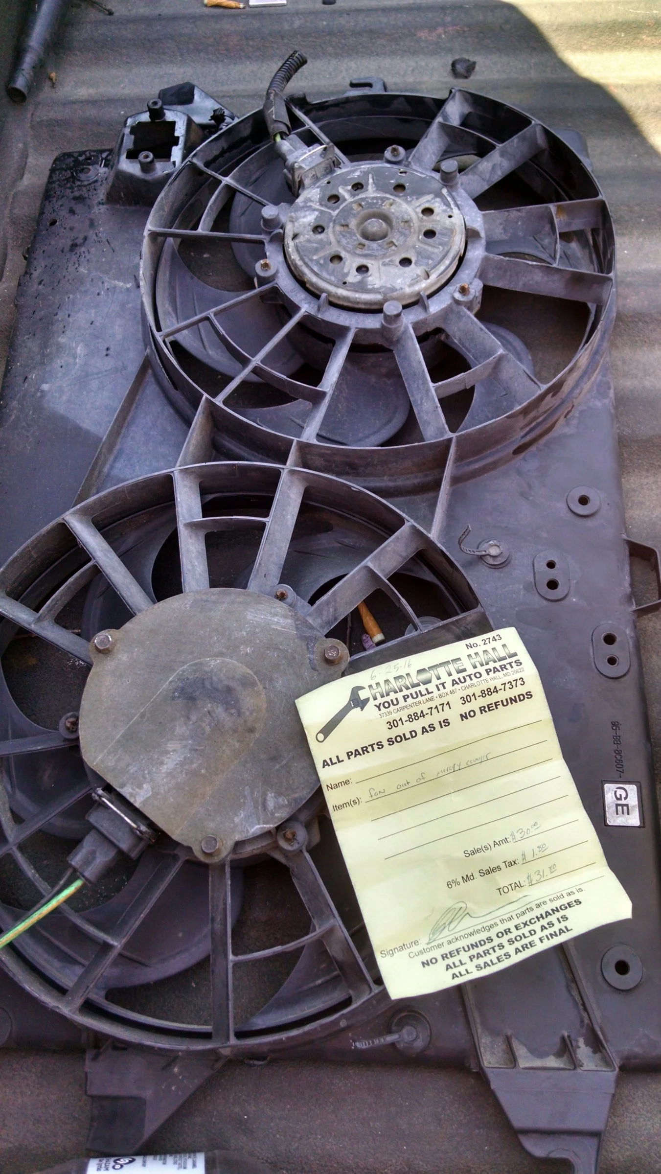

Junk yard hopping earlier and came across a v6 mercury cougar.
Getting the fans out was one of the hardest things I've ever done. Lol. Super tight fit....I have no idea how you'd ever get the radiator out without dropping the subframe. The fans did squeeze out past the core support and motor, but jeesh it was a tight squeeze !!!
The exhaust is on...except for a few clamps and the tail pipe tips.

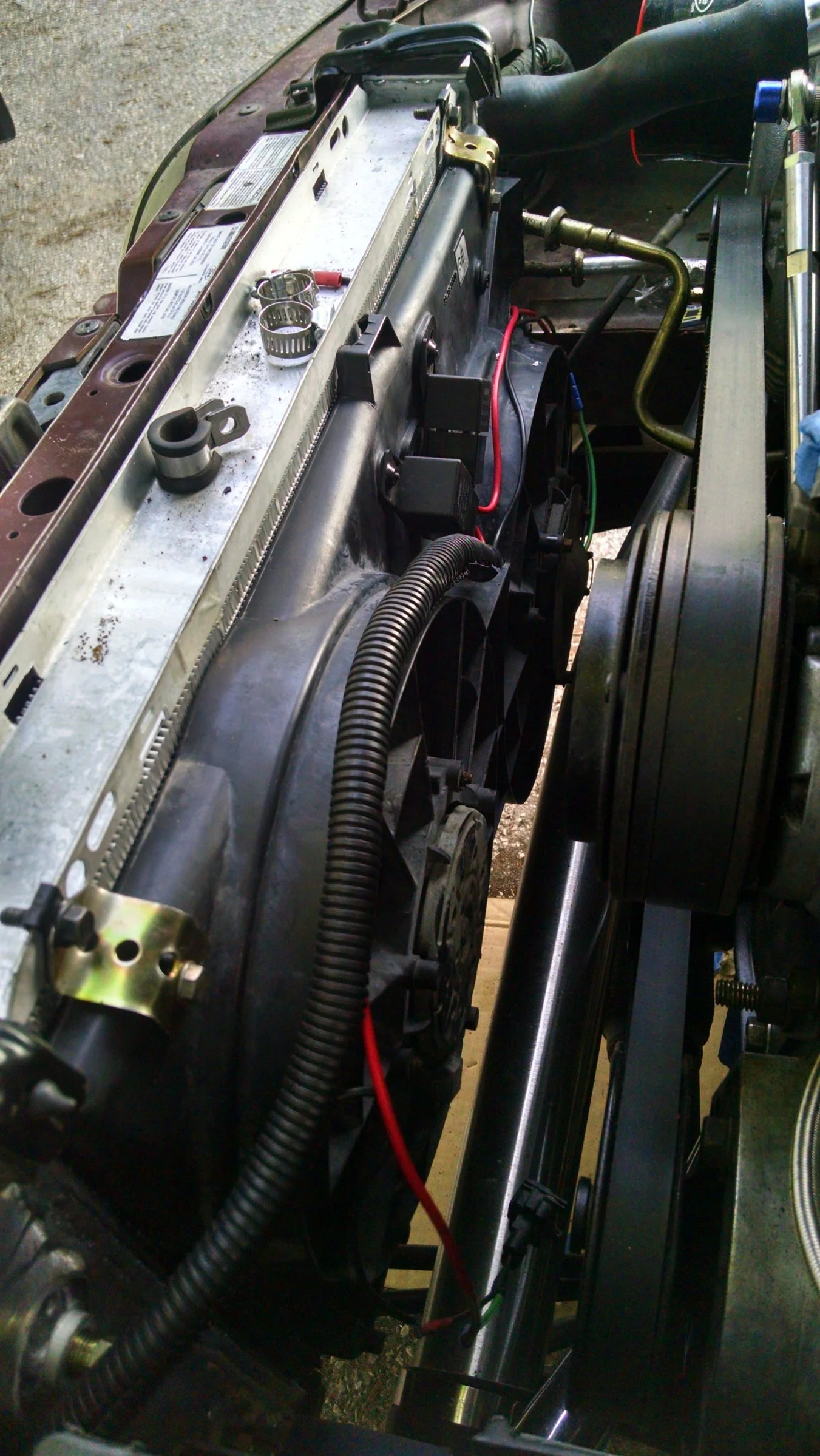

The fans work out nice. I'm still in the process of dealing with the wiring. Trunk weatherstrip to cover the edge of the fan shroud seems like a good idea.

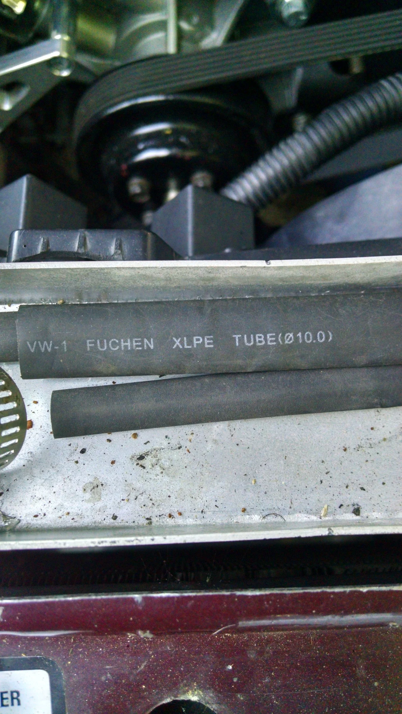

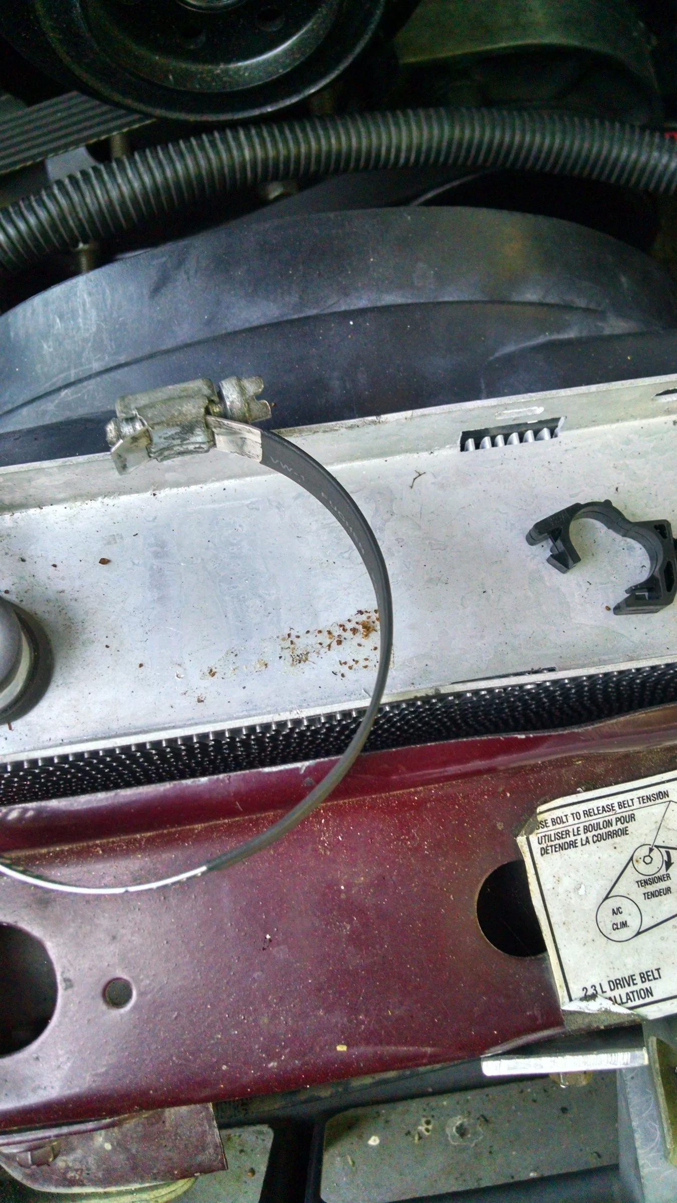

Tried out what my buddy told me to do. Pretty simple.
Put clamp on to see how far the clamp screws on and mark it...
Get the correct size heat shrink tube....trim to fit.
Heat tube to shrink and trim the access over hanging part of clamp ( marked earlier ) and install
The actual head of the clamp could be painted, that's what he did, but I don't mind seeing where to aim the screwdriver.

Shrink tubing the hose clamps is a great idea,and if you turn the head to the bottom of the hose nobody will even know that fuchen thing is there :-)
I put the writing on the inside of the clamp....can't have the kids reading that every time I raise the hood. Lol
