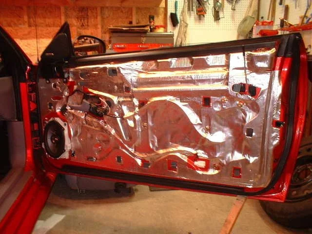

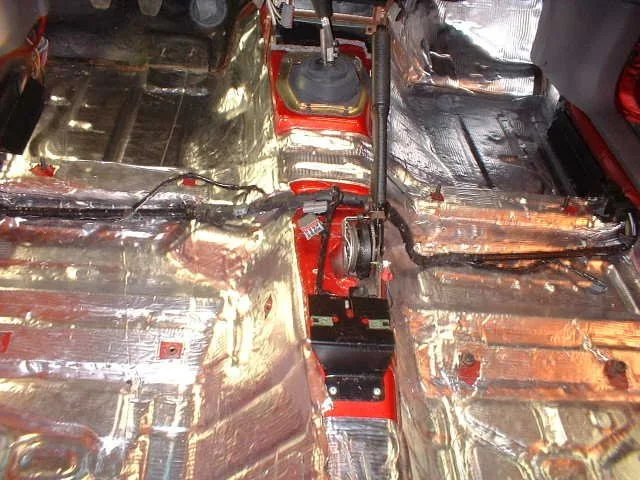

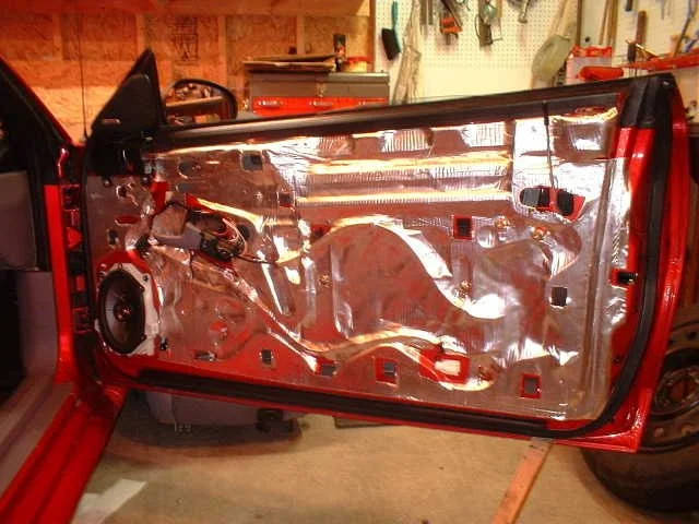

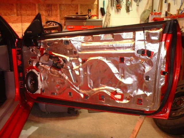

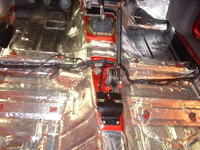

Results = Lots less exhaust & tire drone, dont hear the suspension squeaks, and the doors close with a nice thud, not clunk, with the windows up. The stuff I used is FatMat and I bought 100sq feet off Ebay for $100+shipping. I still have some leftover. Its worth it if you do alot of driving, but it'll take a couple days for the smell (kinda tarry) to go away. Adds maybe 50lbs, if that.

is that silicon you have around your door speaker?
