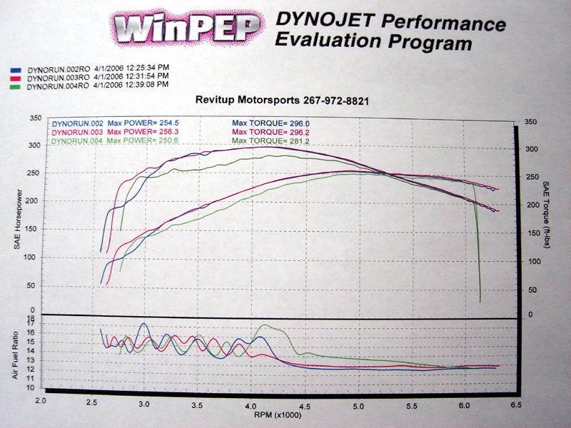

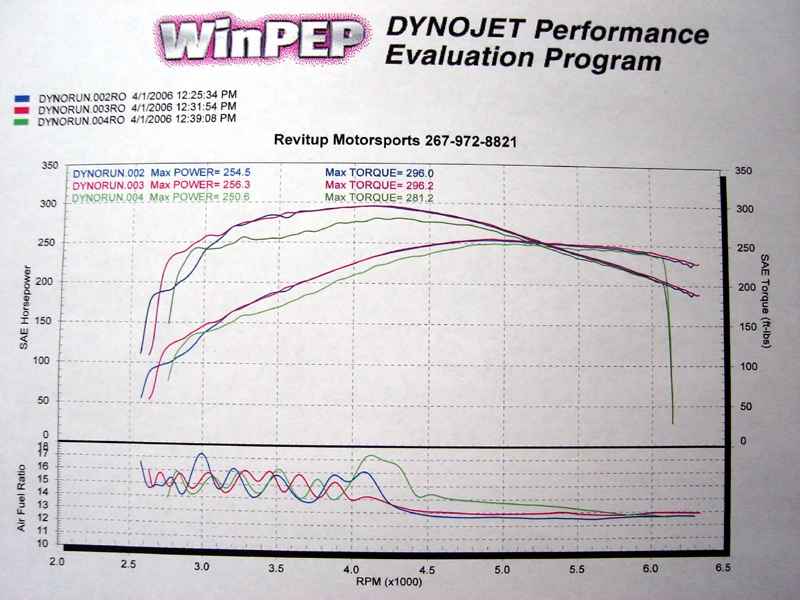

Went to the dyno today.
Mods: K&N drop-in, Densecharger TB to MAF tube (using stock wire mesh b4 MAF), C&L Plenum, Accufab 75mm Throttle Body, Steeda Under Drive Pulleys, Magnaflow catback, Magnaflow catted X pipe, 3.73 gears, Steeda tri-ax shifter, SCT Xcal2 Flash Tune from Modular Depot.
DYNORUN.002 using Xcal2 tune from MD
DYNORUN.003 using Xcal2 tune from MD leaned out 2%
DYNORUN.004 using stock tune

that is killin me.. I have cams and ported heads and I am only making 1 more ftlb of TQ than a bolt on car... something just aint right lol. I am starting to think it is these cams. but I dont wanna change them yet, gonna go with a blower so I might as well wait and get the stage 2 blower cams from VT.

Or get the cobra. :nice:
ForPointSex: Nice numbers. Looks like a fun car.
my tbird makes more power.
Sorry for the size.
those are dyno jet numbers, the STP corrected numbers are 265 hp and 302 yq through an auto with untouched pi heads.
i took it to 1/8 tonite and spun on launch and spun for 1 to 2 shift and ran a 9.10 at 79.79 with a 2.12 60 ft

I definitely think you should be making more torque with cams and heads...what is your current head and cam setup...
First of all, good numbers.
Second, it upsets me that I have done a little more than you, and am not putting better numbers down. Could I have a bad tune? Especially with higher compression I should be doing better than 255 with my mods?

ummm that something that isn't right would be Patriot :D
I just can't get behind any of their products. oh well i'll stick with my boys from VT.
