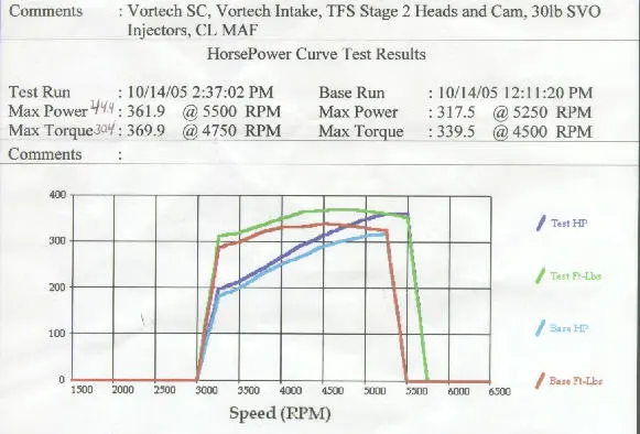

I finally resolved a costly issue with my engine cutting out at high RPM. It turns out my spark plug gaps where to wide. Bringing the gap to .030" did the trick.
I brought my 93 GT in for a dynotuning and got
hp: 361.9@5500
torque: 369.9@4750
Not too bad but I was hoping for at least 420hp...
The tuner said the engine is not operating at full potential. The FMU must be disgarded and 42lb injectors be installed because my 30lb injectors were working at 90%. Additionally, he said that a MAF Extender is needed.
Aside from this, what else needs to be upgraded to achieve 420hp? Also, what is a MAF Extender and who makes it?
Engine Mods: TFS Stage II CNC Ported Heads; Stage II Cam; 1.6 Roller Rockers; Vortech SQ-Trim SC; Vortech Intake Manifold; 65mm TB; 75mm MAS; 30lbs Injectors; 190lph pump; Vortech T-Rex pump; MSD Dist; Crane Hi-6s
Thanks!

A mass air extender is basically something along the lines of a resistor inline of the meter element. What your tuner is suggesting is that your meter is pegging before your motor is able to reach it's full potential. His suggested fix is to drop the signal voltage going to the computer so that you meter is able read more air volume prior to reaching its maximum output signal. He then plans to reprogram your MAF transfer function so the computer can make proper use of the new signals.
Anderson Motor Sports has one.
My question would be why?
Doesn't the EEC discard meter readings at WOT and revert to preprogramed fuel and spark tables at WOT? On a blower car, I don't see what good the extender would do unless you're pegging the meter at part throttle settings.:scratch:
I know its hind sight, but you should have done the 42s to begin with. I feel that they would make a better match for your SC'ed car.

If you get the 42's and a new MAF that's matched to the larger injectors, you no longer would need the MAF extender since the injectors have a wider operating range of flow and it wouldn't peg out the reading any more. Something is very wrong with your setup, because you should be getting almost that much power without the boost. Post up your air/fuel info if you have it, and what's your base timing set at??

Is good to hear that a MAF Extender is not needed with 42lb injectors. One less expense. My base timing is stock at 10 degrees. All appears to be bolted on correctly except for the headers. I'm thinking of ditching the 75mm Pro-M bullet and go to a 80mm MAF, instead.
When the headers are replaced, the injectors replaced with 42lbs and the MAF at 80mm, should this combo finally put me at least 420hp considering the horsepower already gained shown in my dynogragh? A blown 420hp+ 93Mustang GT sounds about right, doesn't it?
Wow, at 10 degrees you should be making tons of power with boost. Yes, with 42's and a big MAF that works right, you can definately make 420 at the wheels with your combo. And why the crap are you stopping at 5500 RPM.... rev the thing up!!

Just wanted to point out that if you're having custom tunes done, that you need not get a meter specifically calibrated for 42s. You'll have better resolution out of a meter that's not been modified. In other words: Stick with the OEM calibration and make your transfer adjustments through the tune.
The tuner said that the engine begins to break up at 5500rpm because the supporting parts can not handle it. He also mentioned that the engine has much more potential for power and the 30lbs injector and the maf is what's holding it back.
