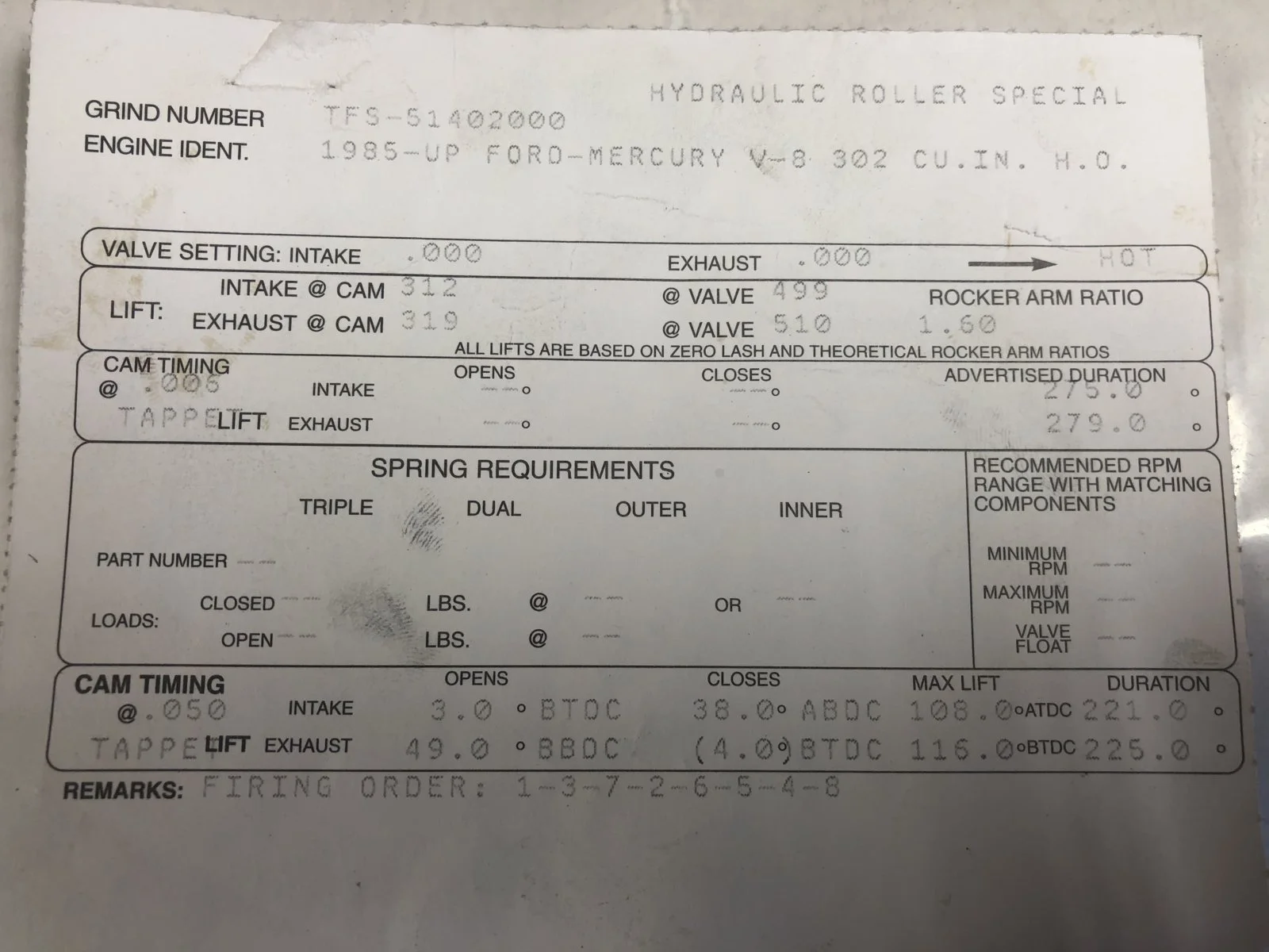

I bought a long block from Coast High Performance and was told to add certain parts to complete a build that was a blown 347 that passed the California sniffers (NJ was close). Things I can remember are it was a Sportmans block, all the Probe Industry goodies like forged pistons and rods, AFR 185 heads, 9.5 or 9.6 to 1 compression and onto that I was to add a Edelbrock RPM II plenum, a 70mm TB, 80mm mass air, 42lb injectors, and the V-2 Vortech kit. This was to be 540 FWHP and 450 RWHP at sea level (I don't remember the torque numbers) I was told the stock rails were good to 500hp, so no need to upgrade them. I do have a power pipe, but the point of that was to get the mass air in the fender well.
Some things have changed from NJ. Firstly I had bought all shiny parts and the EGR was butt ugly, so it went, along with the smog pump. No worries as I live in a county without emissions. Now for the bad. Combustion is ~35% less efficient up here, so my 450rwhp becomes closer to 300rwhp and I have read that you lose 2.5psi of boost per 5000ft I have no idea what the boost would have been with my engine but I am estimating ~6psi and then losing another 4-5psi with altitude seemed like I might be even worse off. (and if I don't get more air in there the 42lb injectors will be too much) So it would seem to be time for another pulley, but I am not sure which one to go to. The instructions indicate that I have a 3.33. I would like have enough boost to make this all worth it, but I don't think an after cooler is going to happen. I live most of my life between 8000-10000ft, the car will got to 5500-6000ft regularly and 4500 once in a while.
So after all that, with this engine and this blower, what pulley should I go to that will not slip? Do I need to change the crank pulley also? I would like as much as I can have at 9500ft while still being safe if I went to 4500ft. I figure if I want to take it to sea level, I might have to step up the pulley size for the trip. I did just buy trick flow fuel rails as if I go lower and make boost, I could exceed 500rwhp depending on the boost I end up with.
Thanks for any help or thoughts you could provide
