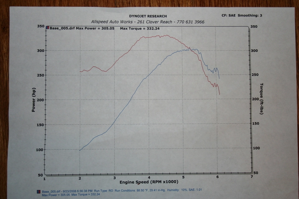

I haven't dynoed my car since 06 when I had those crappy procomp heads, and needless to say, trickflow heads are worlds better than cheap knock off crap. I work at a shop that is also a speed shop on the side for high end cars like BMWs, so we have an in ground dyno that I have free access to, so I finally decided to drive my mustang to work and see what it makes.
Well it put down 305-rwhp and 332-rwtq. Not too shabby imo, and I surely wasn't disappointed this time lol. My car put down 55rwhp more with trickflow heads than it did with the pro comp 210cc heads. There were no other changes.
And here is an awful cellphone picture of my car.

It either the tune or the intake is too big. The dyno A/F wouldn't work so I didn't get a reading. It is sort of a strange torque curve though. I'm just happy to have broken 300rwhp with this tired old engine before I start building the new engine I have planned.

The peak numbers are nice, especially the torque, but the powerband does look rather narrow. It all seems to be happening from 3000-5500rpm with not much on either side.
Have you had the engine computer dyno tuned? It's possible the timing and fuel curves are some way below optimum.
I agree that its probably in the tune, but since I'll be building a new engine shortly, I cant see spending the money to have it tuned. The curve really doesn't bother me at all, I'm used to driving mostly high rpm cars at work so it just feels like one of those.

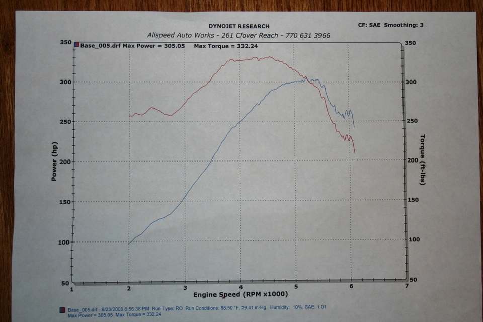

I changed the scaling on of the graph today and it makes the curves look much better. Looking at it now I dont think there is any problem with the current tune although getting a tune would help to optimize the power potential and drive ability.
