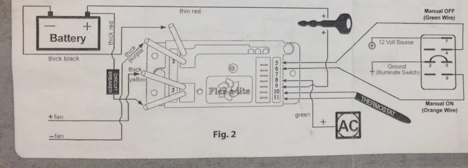

The switch is made specifically to work with this exact controller
Here's a diagram of the wiring in the flex a lite kit with the switch. Everything is wired exactly how you see here with the exception of the AC switch (optional connection that I did not perform).

I can say I have used the FAL 33054 on 3 cars and not one has failed. Still waiting for the OP to jumper the probe pins like I suggested twice to see if the probe is faulty.
