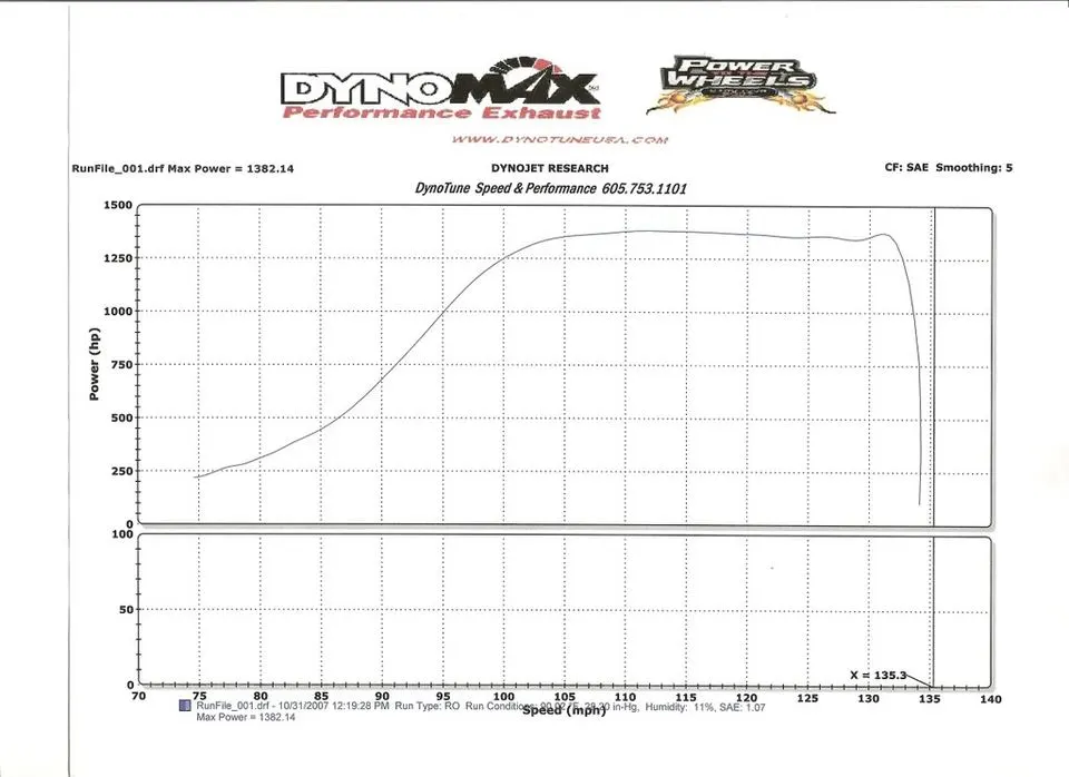

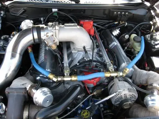

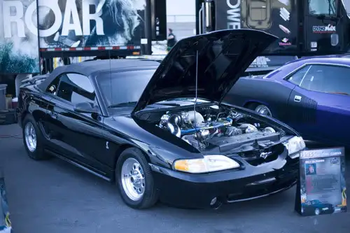

this guy is running E85, 427W w/ TWIN 78's
only problem is he was running an Accel pump on it @ 840 lbs/hr and at about 1250 rwhp it was starving the engine. So a friend let him try his Weldon 2035 (200 glns/hr) same thing at 1250. Hooked up both of them and no issues. He will probably have upgrade to a belt drive pump this winter. (all this cuz it takes about 30% more fuel)
160 lb/hr injectors:shock:
