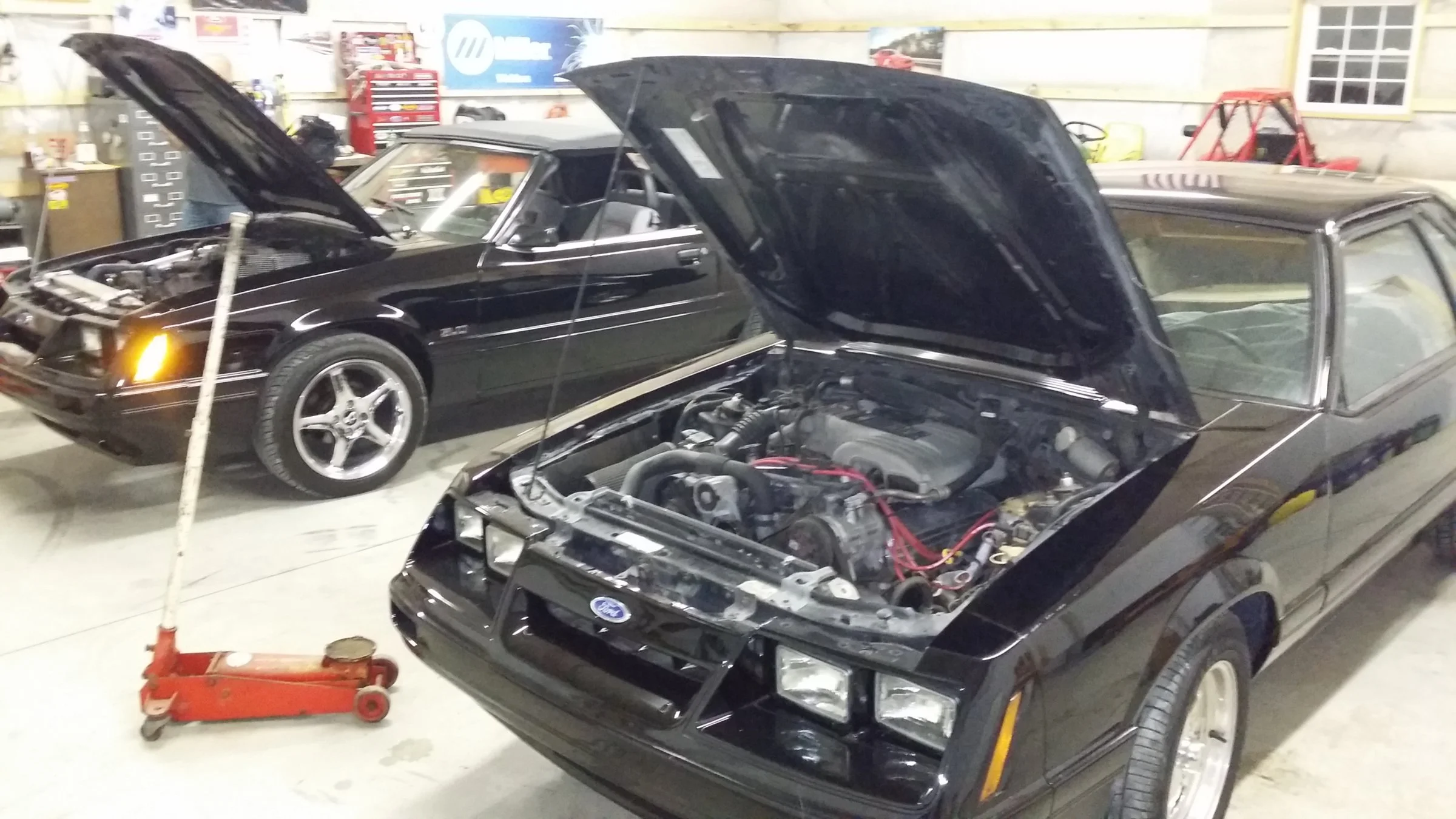

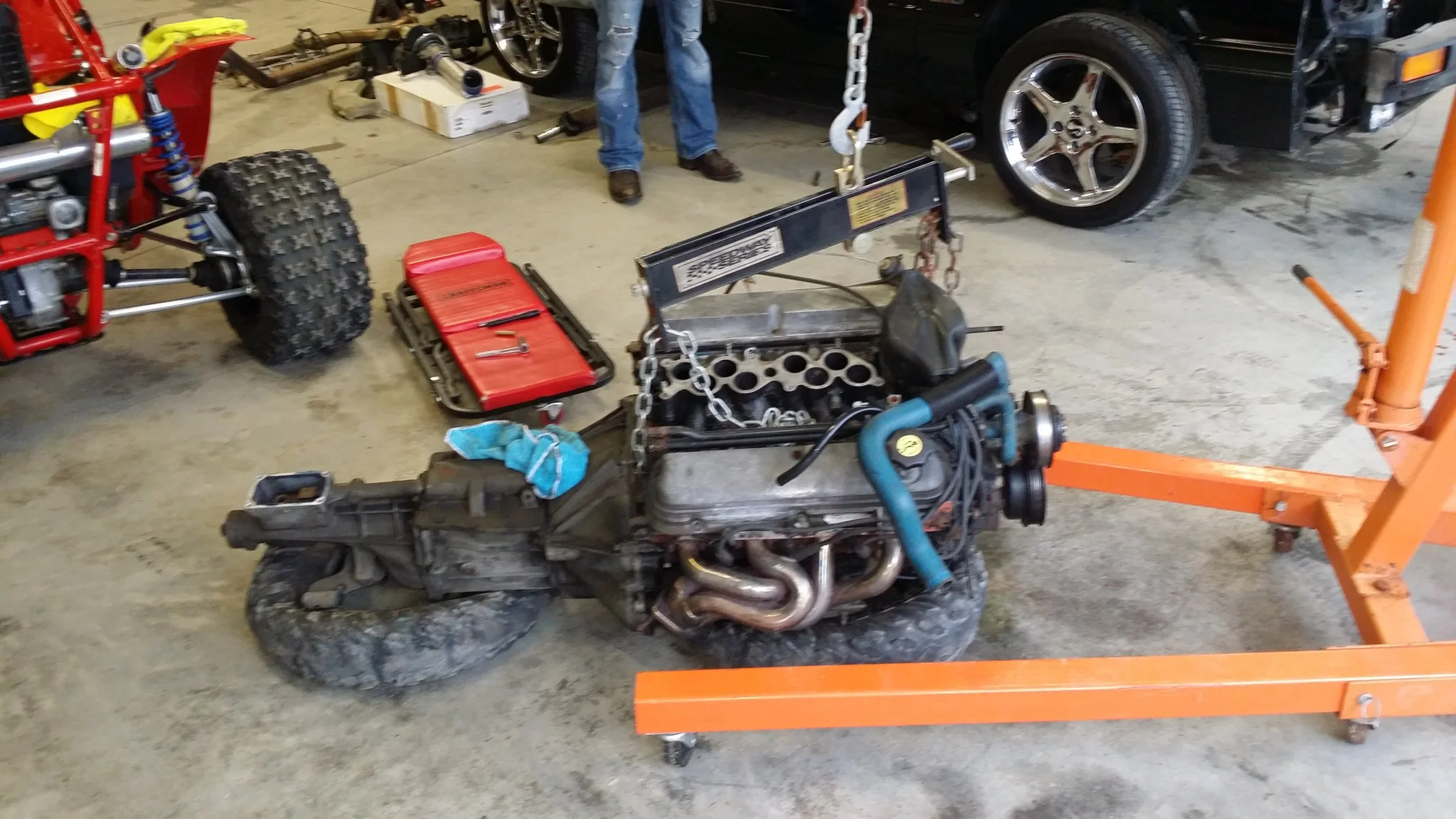

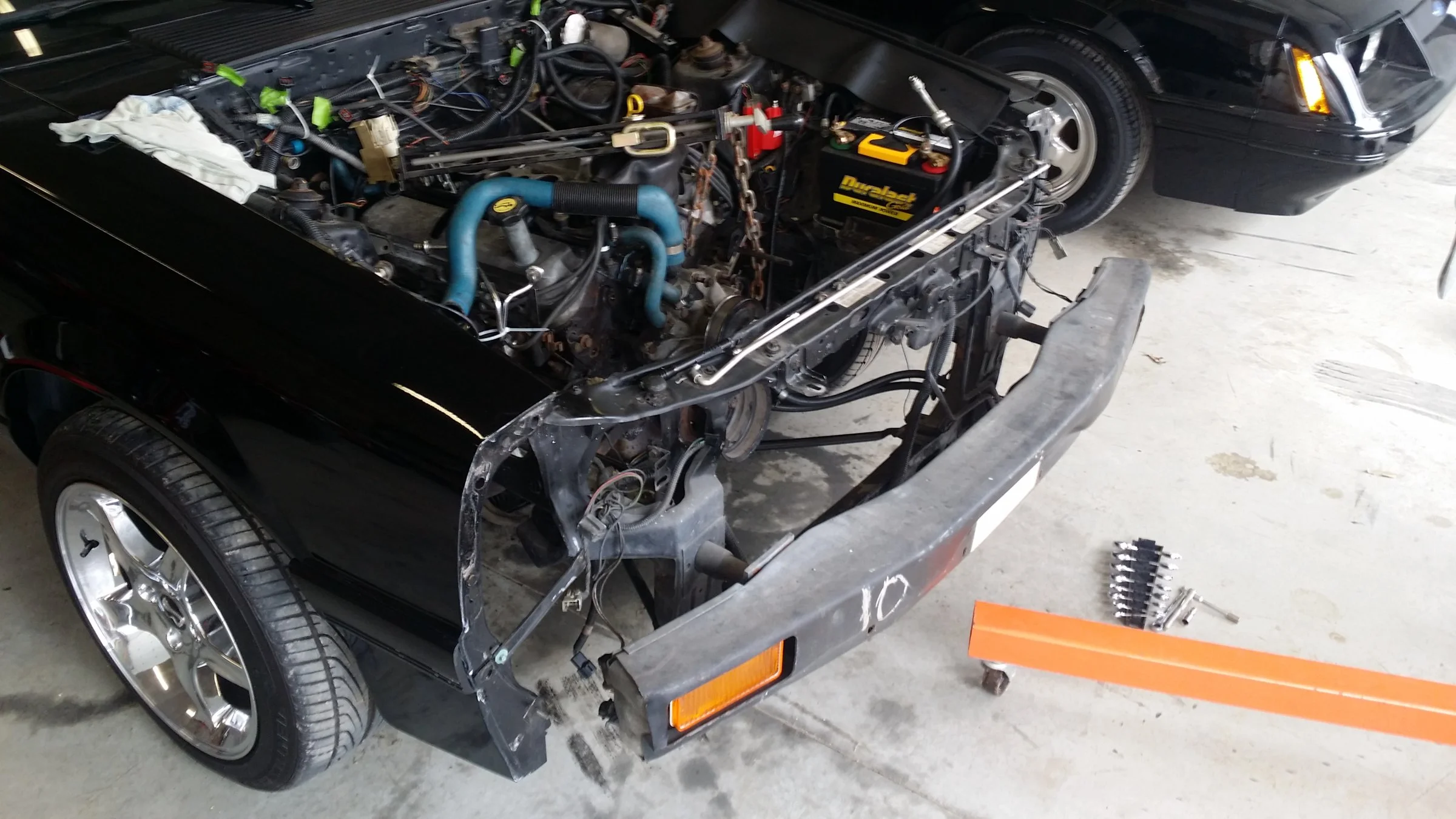

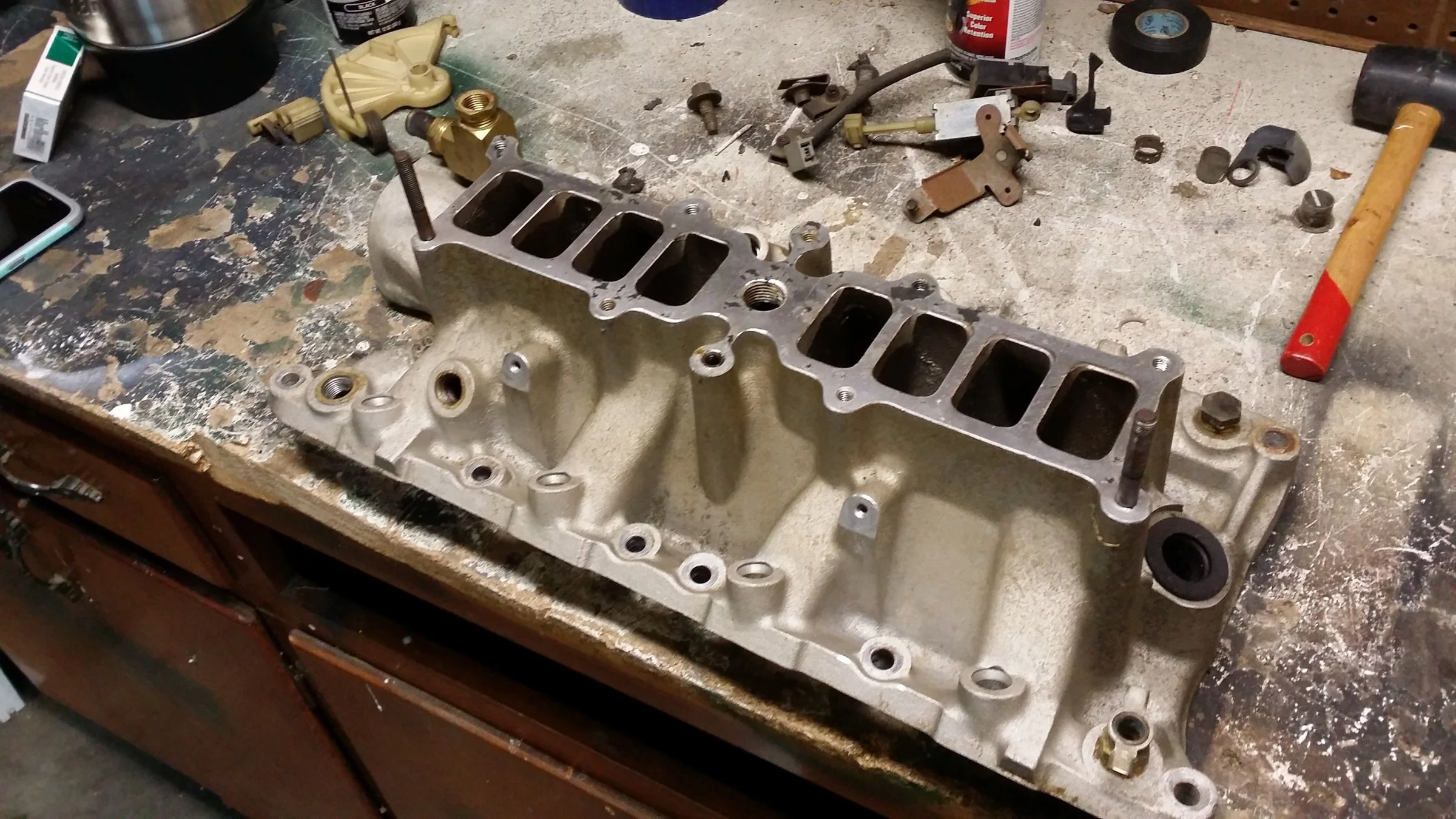

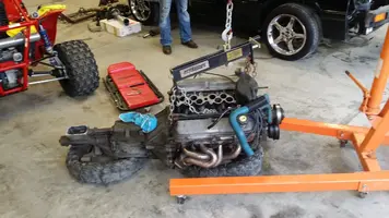

Well, I dont have any pictures of the on-going project, to speak of. Here are a few of when we got started. The intake, the block, accessory brackets, TB, etc. have all been blacked out. Im going to work on it tonight, after my parts show up from LMR. I hope to have it running/driving tonight before I go to bed. **Fingers crossed**
