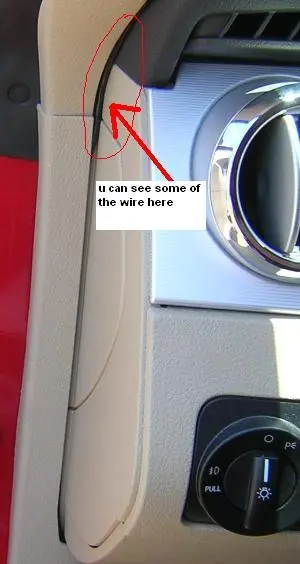

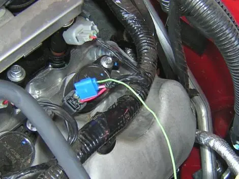

i added a raptor tach light very easy here is what i did

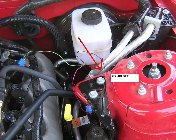

running the wire down the door seal trim panels to a wire loom to the left of the clutch pedal under the hood its a tight fight but you can get your hand into the hole next to the master cylinder then i attached the green wire to the wire going to the coil that was not red. then pulling the bolt on the bracket in i striped the black wire and grounded it.

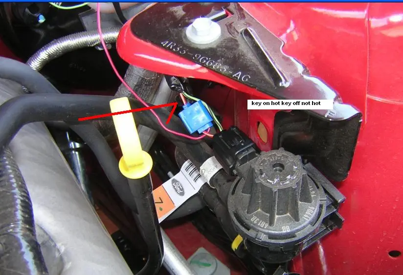

last the only key on hot, key off not hot wire i could find was to that egr sensor or what ever it is and its done i left the extra length of wire under the hood so i did not have wires getting in the pedals
