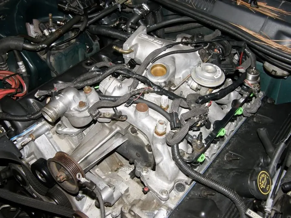

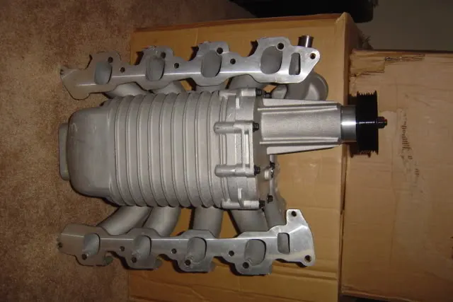

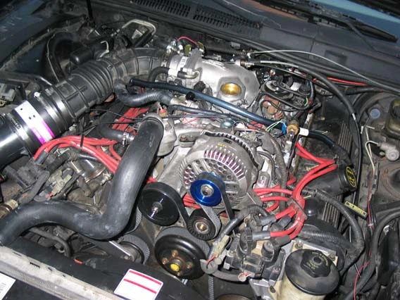

Furthermore....and M112 uses a press fit pulley, as shown on this under hood picture of Timb's car an in the pulley image and link below.....
http://www.pulleyboys.com/fordsvtpf.html

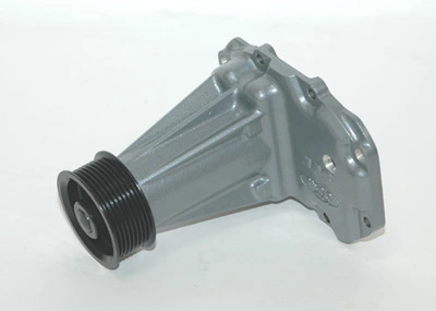

The M90 uses a keyway system to affix the pulley, as show on this pulley image/link below.....
http://www.pulleyboys.com/allenengine.html
Another dead giveaway is the pulley diameter. Since the M112 moves so much more air per single revolution than the M90, the pulley size is noticeably larger by comparison. Standard pulley sizes for an M112 usually run within the 4.0"-to 3.5" range (depending on it's usage). Overdrive pulleys can be had as small as 2.74", but you're talking serious boost here, not for your average user and certainly not for use with a non-intercooled kit like the FRPP/SVO unit. The M90 uses a much smaller pulley to make boost, since it needs to turn much faster than the M112 to produce the same volume of air. Standard pulleys on the M90 run in the 3.2-3.0" range and can be run as small as 2". I'm personally running a 2.35" pulley on mine.....something that would be inconceivable for an M112.
Lastly, if all that doesn’t convince you, I’ve got a complete set of pictures and parts detailing the FRPP/SVO kit in a link provided by green_fow_six on another board…http://briefcase.yahoo.com/bc/bramr...w=l&.src=bc&.done=http://briefcase.yahoo.com/

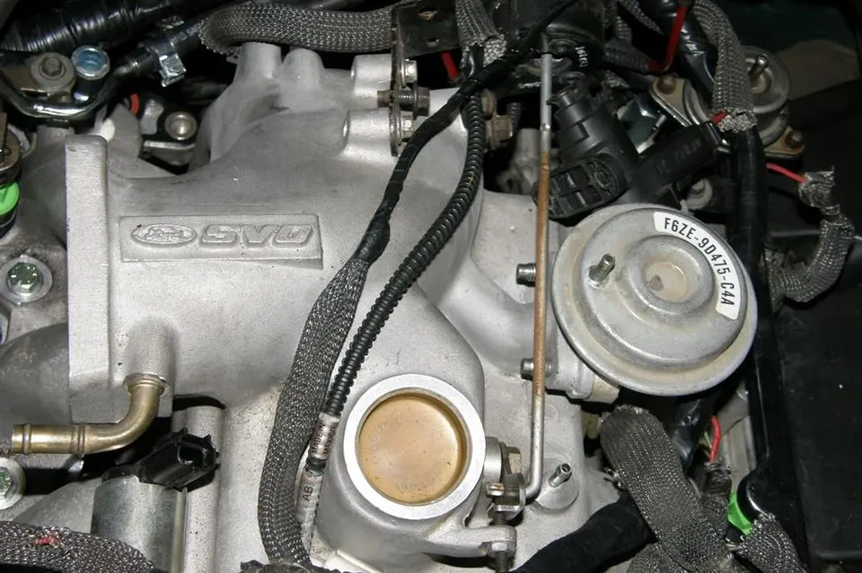

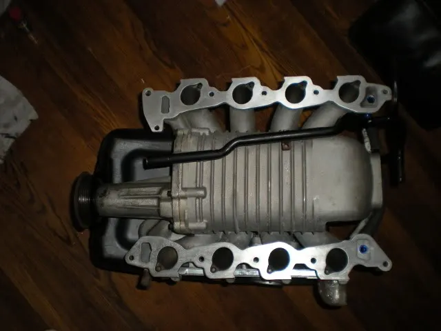

Ford chose to cast isn't own one piece manifold for the FRPP/SVO kit but make no mistake about it, it is an M112. Notice the wider rib spacing and different over all design of the unit itself (pay particular attention to the area up front where the bosses cast into the case to bolt the nose drive on are external with the M112 and recessed with the M90 ). It also has a much longer and wider case to house the longer rotors (look closely, the rotor section of the FRPP case runs nearly the length of all four intake runners on the FRPP manifold, where the Allen kits M90 barely runs the length of three of the runners), as well as a completely different nose drive, in comparison to the M90.
M112 on the SVO/FRPP Kit

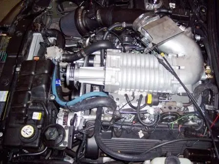

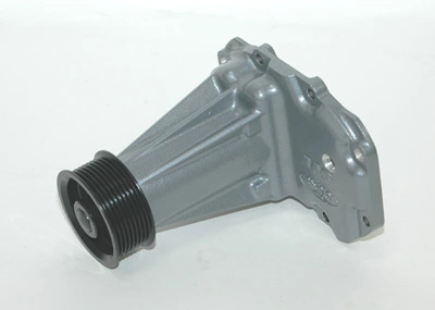

Nose drive for the SVT Cobra/Lightning M112.....see any smiliarities between it and the FRPP/SVO Nose Drive?

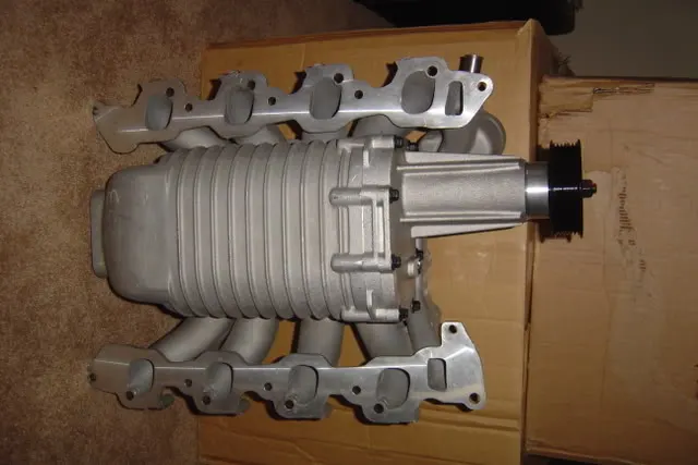

This is an M90 Nose Drive.
M90S on the Allen Kit

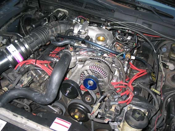

M90 on the Saleen Speedlab Supercharger Kit
