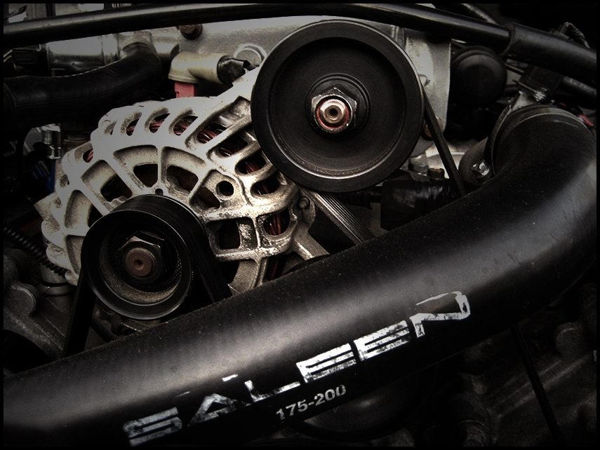

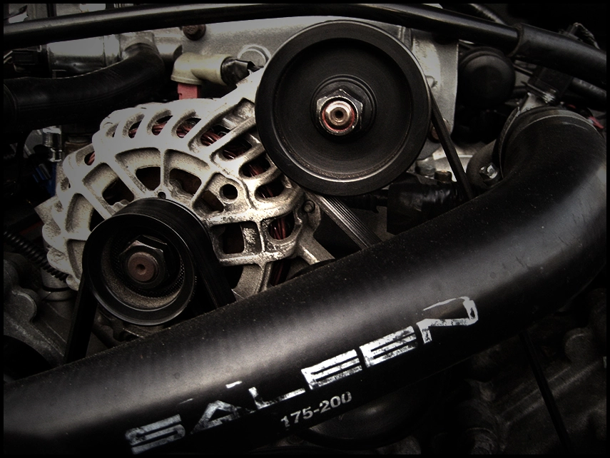

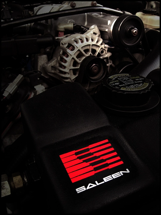

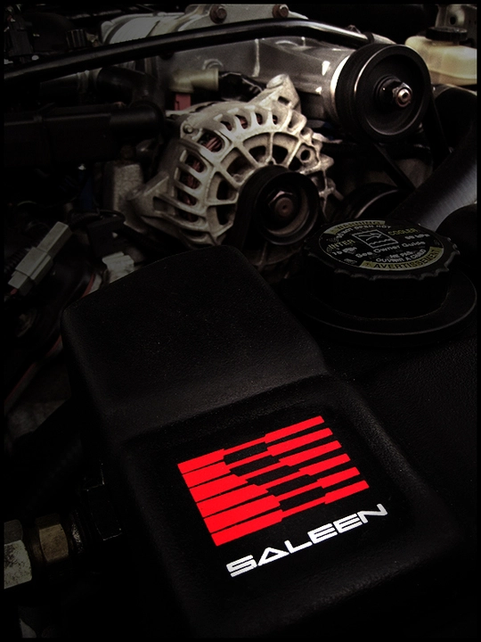

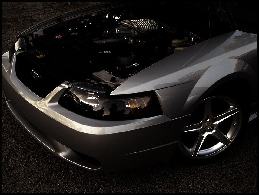

Heres some pics of my Series II on my car. I love my setup, and would not have been able to afford any boost otherwise - haha. Plus you cant beat the whine!
