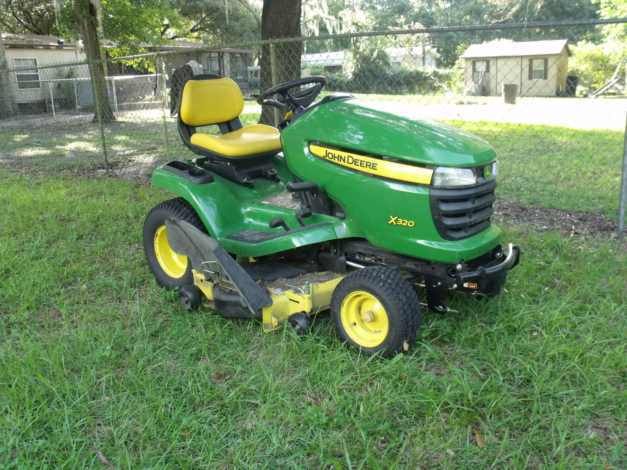

I can only compare my Chinese ignition box for my OVERPRICED JD Lawnmower. Embarrassed to call this overpriced POS a " tractor" ...... John Deere wanted $115 for the new part, while I found it on Amazon for $26.. Both looked exactly the same and both are made in China....
The $26 part lasted one year before it did exactly what the original POS one did, lose spark after it gets warm.... Not sure if I will splurge on the JD part or use this POS for target practice.....
I'd sell that POS while it's still running and try finding one made in the US and built by the same company that pooped their label onto it.
I wonder if any still exist. :chin
Its actually not running now... Its about 11 years old, the really old metal bodied ones were supposed to be the best ones...
