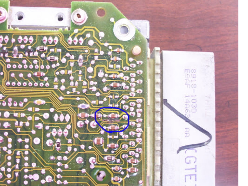

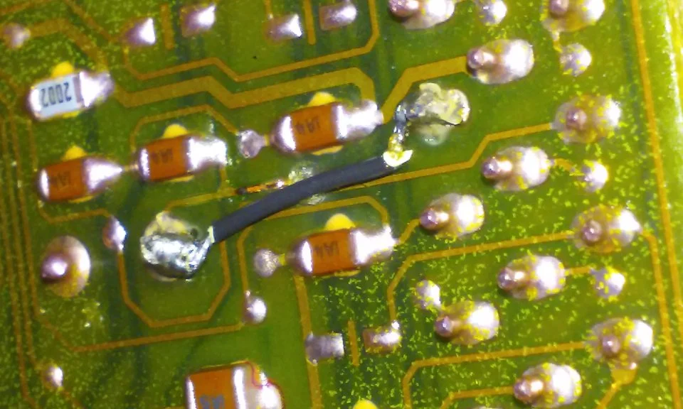

If you have a damaged computer with signal ground problems, see the pictures below for help finding and fixing the burnt computer trace.
The fix is some careful soldering of a small jumper wire across the burnt section of copper trace.
