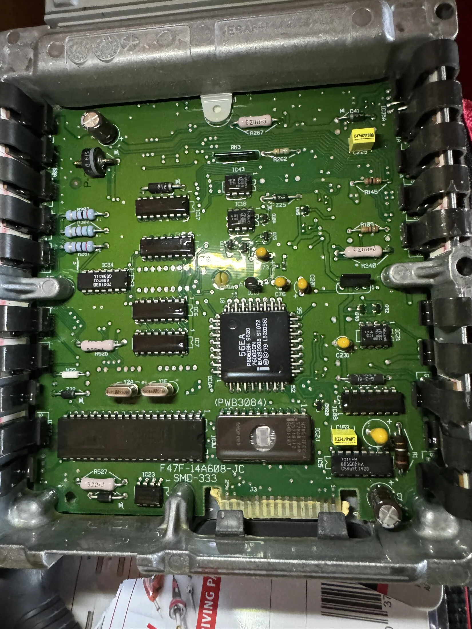

Hello, I’ve been dealing with a no start issue for a bit now. After chasing an issue with the fuel pump not priming, one day it randomly started to constantly prime when I had the EEC jumped using the test connector.
I would like to mention the fan would constantly run after I had replaced the EEC fuse and CCRM. Now the fan and fuel pump constantly run but still no start and barely any power to the injectors.
I’ve searched and read through loads of forums to diagnose the fuel pump not priming. Now with this new issue I’m finding that this is a common sign that a capacitor could be shot in the EEC? I took the cover off and can’t seem to find any blown caps and their legs are intact.
I’m really stumped on this issue, any help is much appreciated!

Send the EEC to a repair service. There's no way for us to tell if it's functioning through an image.

Sent that image to help show that the caps are in tact and there weren’t any burn marks on the PCB.
