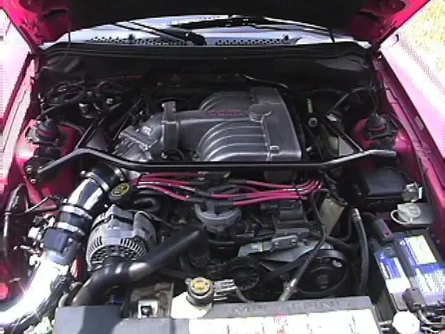

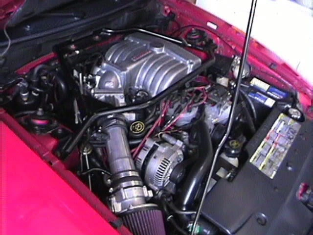

Man, I haven't heard of issues of this product other than ears breaking due to over tightening. I bought my Edelbrock Performer intake in early 1995 when it first came out. I used it all the way until 2002 when I changed the upper to an RPM (still ran the 1995 lower). The plenum cover on the first Performer's used 6 torx bolts which wasn't the best design, I over tightened one and stripped the inside. Had to weld in new aluminum and retap. They changed that later. I remember that Eddy intake, 70MM TB and 77MM MAF getting me my heavy 94 finally into the 13's.
Scanned this pic from 1995. Was messing with cold air kits, straight shot vs. bends. Straight won on the dyno vs. rerouted bendy air.
Back in 2002 changed to the RPM upper still using the 1995 lower.
