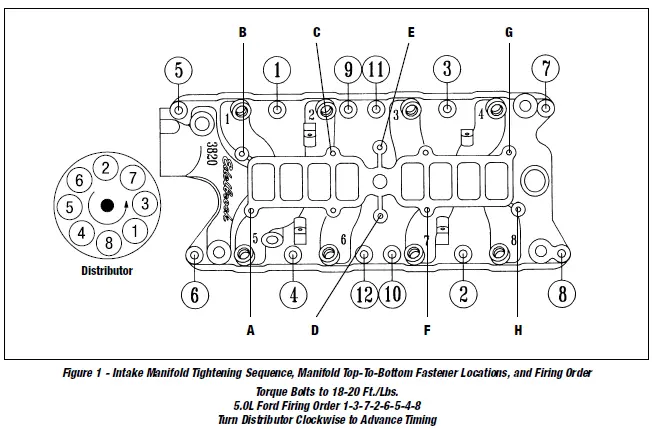

Same Question, as my Edelbrock Performer RPM intake showed up without any hardware. I found the instruction manual for the Performer 5.0, not the RPM, on Jegs. It's given a couple clues:
I've spent some time on this, today. Wish this info was easier to find. I actually don't trust the above, because that info is for a Performer 5.0, not a Performer RPM. The intake takes four 1/8 NPT vacuum hose barb fittings, and two 3/8 NPT Vacuum Fittings (Tees for me).

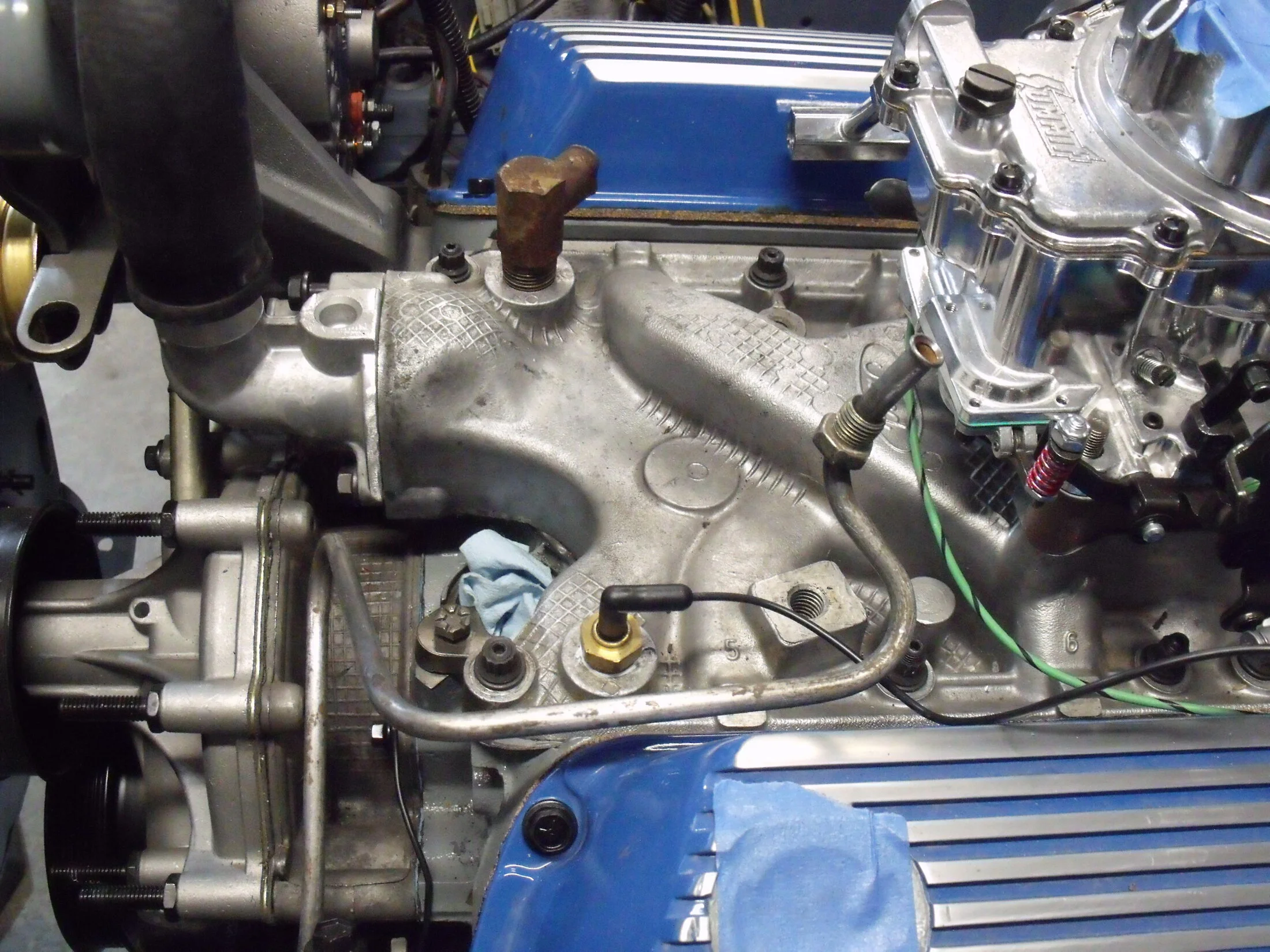

A great way to install your intake and gaskets.. No movement...

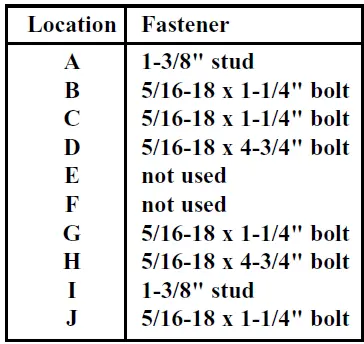

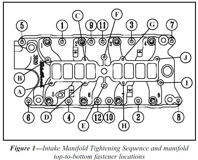

Nailed it! You're better at google-fu than me, it seems.
Let's see how I did:
So, they used bolts instead of studs in all but the outer two Driver's side studs. 1 3/8" was correct for them. So, I'm in good shape there. The other 2 Driver's side studs might be slightly short since they're calling for 4.75" bolts and I got studs, which'll need ~0.3" more for the nut to go on top. All 4 passenger side bolts are 1 1/4. So, the 1 1/2" studs should give the extra room I need for the nuts.
So, I guess that's a win. I shouldn't need the 1.7" studs. We'll just have to see if the 4.7" studs will work, and I would have gone to 5" studs, but they didn't sell any on Summit and I thought I could get away with it. I'm thinking it's gonna be ok. Might have to use a little blue loc-tite on those two and thread them a little shallower... maybe not torque 'em as much if they don't have enough threaded on the bottom-end. *crosses fingers*
