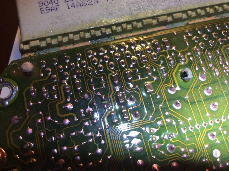

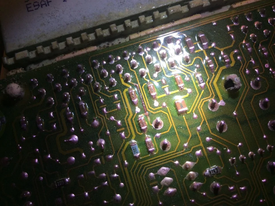

Okay, I yanked the computer out of the car, took the cover off and found pin 46 chase... Looked burnt, and no continuity on either side of the section in question... I'll solder a jumper wire and let you know what happens after I double check all other wiring...
