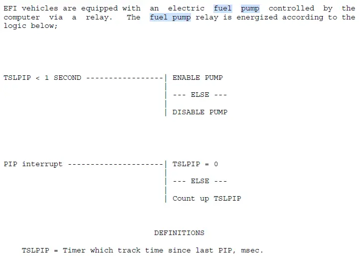

What about after the prime and you are cranking the car? Doesn't the ECU need to see a PIP signal to run the pump?
Correct. Although now that I did into this, the initial key on prime might not take into consideration PIP input. Trying to search through 600 pages of A9L strategy but can't find the right ladder logic for key on prime.
But this is crank/run.
