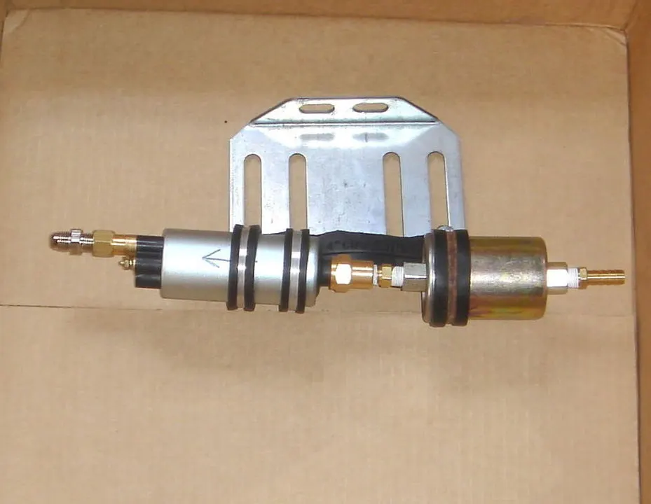

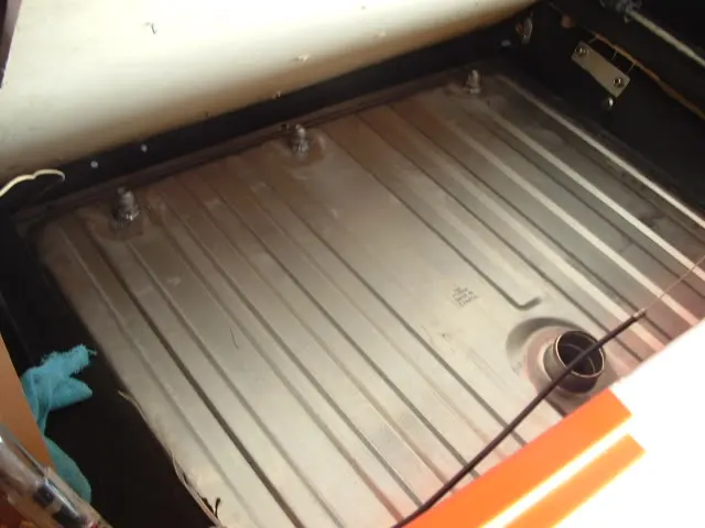

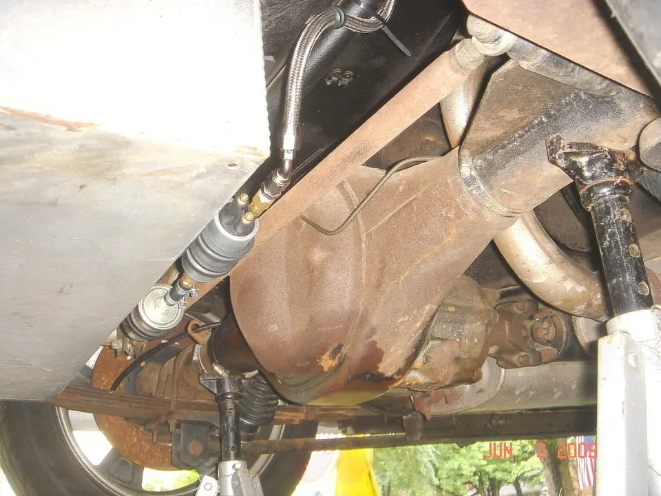

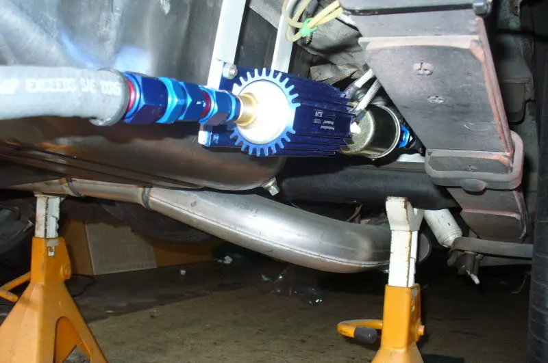

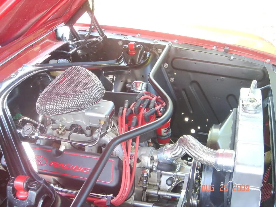

Here's my Projection returnless set up:
Here's the bracket I used. It mounted in the same location as the gas tank mounting bolts. I used rubber spacers where the bracket mounts to the trunk floor and where the pump mounts to the braket and rubber isolated mounting straps to help minimize the pump sounds/vibrations - the pump runs nice and quiet and is only audible during priming, before starting.
My sits just in front of the gas tank (fuel cell) and close to level to the bottom of the tank. I, also, ran new 3/8" braided fuel line from the pump to the throttle body. Early Mustangs have 5/16" fuel line and Projection units require 3/8" supply lines.
Since I was rerouting my fuel line, I brought it up from the trans tunnel to rear feed the throttle body. I think it makes for a cleaner look.
