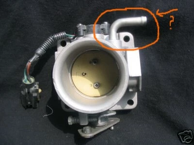

monk302 Founding Member Apr 18, 2001 742 2 16 New Jersey Jul 2, 2006 #1 Jul 2, 2006 #1 Anybody know where this port attaches to? Trying to finish up the swap in the next weekend or so. Thanks, Mike Attachments be_1.webp 20.4 KB · Views: 200
P Protowrxs Member Jul 20, 2005 93 0 6 Oklahoma Jul 2, 2006 #2 Jul 2, 2006 #2 That is the air intake for the PCV. It should run from the throttle body to the nipple on the EFI version of SBF valve covers. -Stepheen
R Red5oh Member Jul 8, 2005 377 0 17 DFW, Texas Jul 2, 2006 #3 Jul 2, 2006 #3 If you still have the EFI valve covers...it goes to the oil filler tube in the passenger side.
LUCAFU1 Founding Member Apr 19, 2001 496 0 16 Tucson Jul 3, 2006 #4 Jul 3, 2006 #4 just cap it, youll be fine
P Protowrxs Member Jul 20, 2005 93 0 6 Oklahoma Jul 3, 2006 #5 Jul 3, 2006 #5 I had planned on removing mine and run filter filler caps.. it appears to be a pain to get out in one piece though so far.... It just provides a clean air source for the PVC setup. -Stephen
