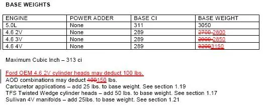

not 100% true...
if its gunna be heavly raced a carb is the way to go. pure street in the NMRA is a very close class where you have the option to run carb or fuel injection
25lbs to go carb and 50 for tw heads. in my eyes that there says those 2 parts allow a big advantage

I agree, the carb and intake is going to offer a slight weight advantage, but aluminum heads fit on engines with both styles of induction. So really....is a 25lb weight advantage worth it? I'd rather pick it up with moving my battery to the trunk, or swapping out suspension components personally?
What I'm really I'm saying is, if it’s still going to be primarily a street driven car and ain't broke.....don't fix it. Its simpler and cheaper to just upgrade existing components, than it is to tear something all apart and start over from scratch with a new set up.

think your looking at that chart wrong...
the weight savings is null and void here.. base weight is base weight... if your running a 302 based motor up to 313 inches you have to tip the scales at 3050 pounds. you want to run a carb you have to add another 25 to that... and in a class thats won or loss by .1 or so 25lbs isnt going to help win unless its making more power...
all that other stuff like battery in the trunk and normal stuff is done already
