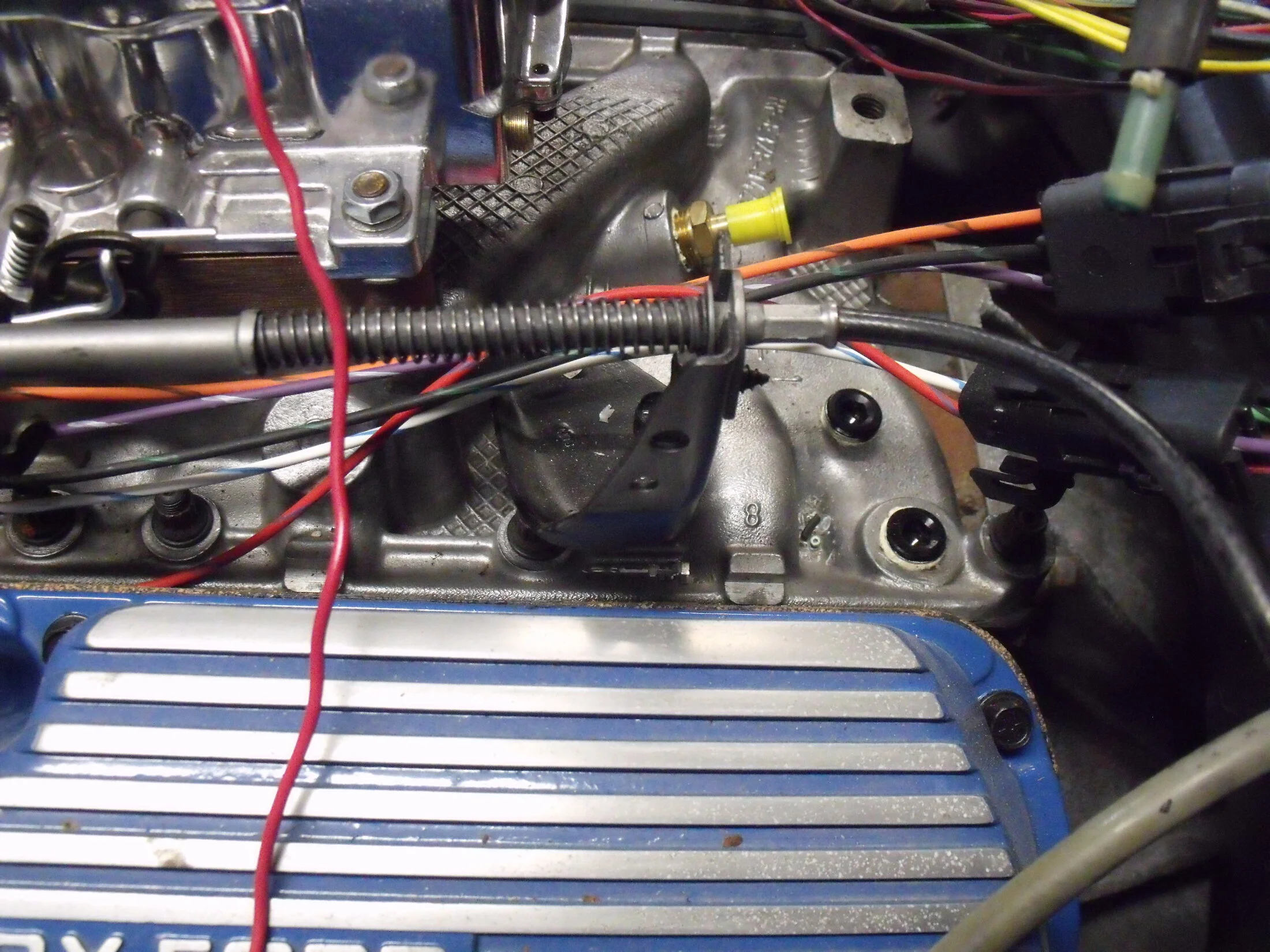

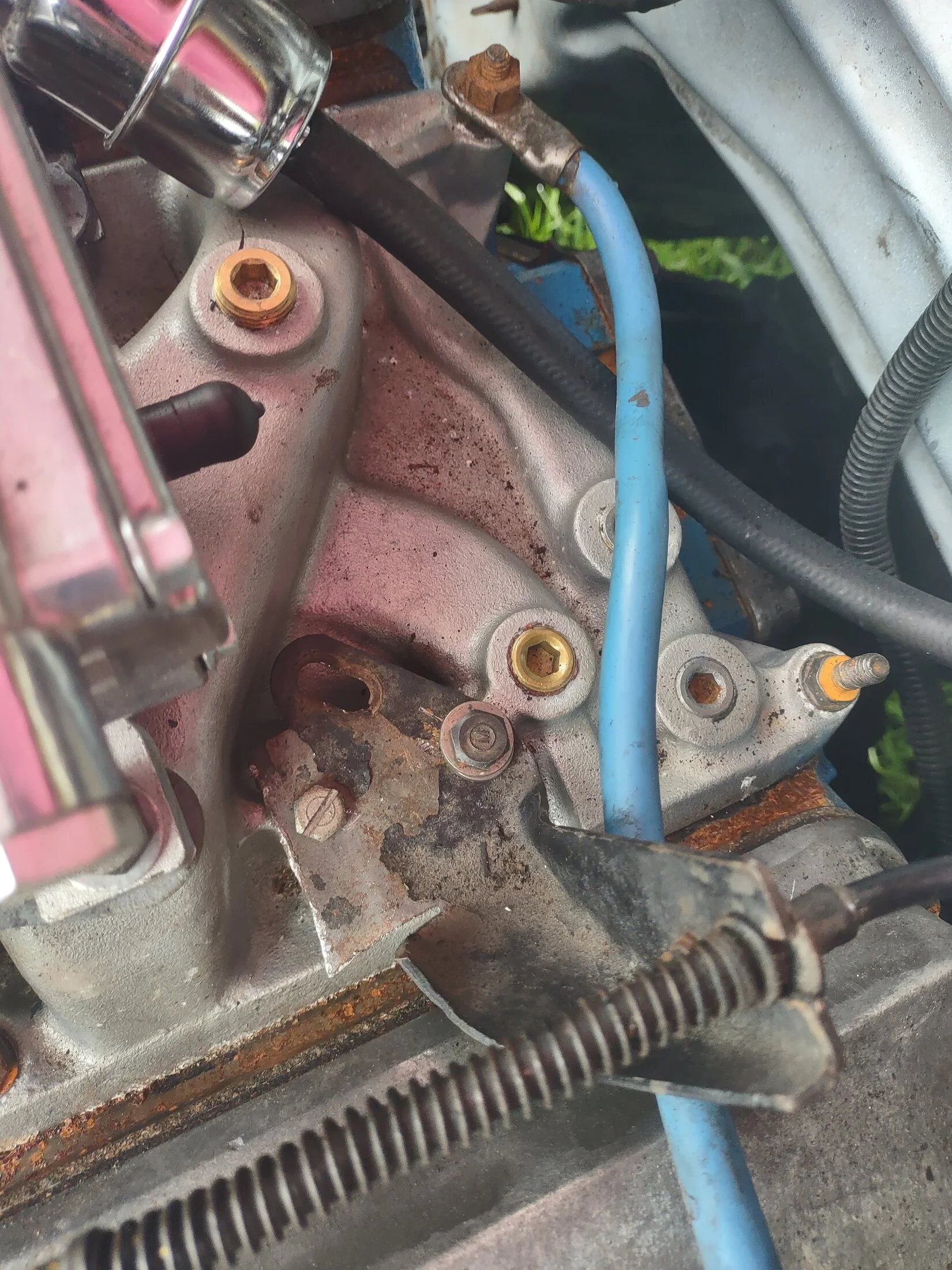

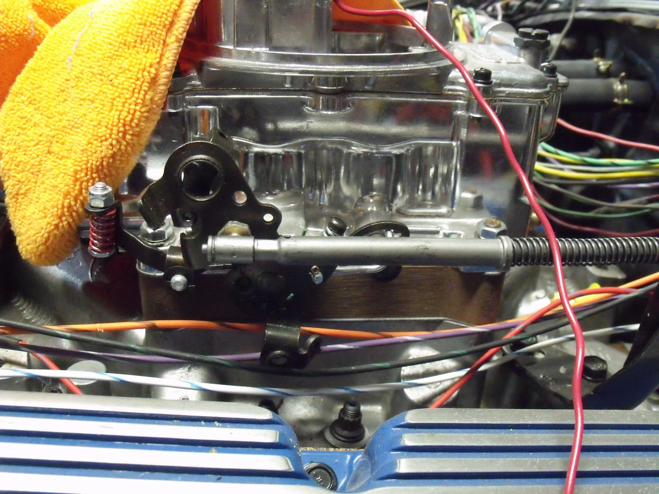

limp wrap a little cheese around it and its a done 5 Year Member Oct 4, 2020 5,486 2,909 173 Florida May 21, 2024 #21 May 21, 2024 #21 Did you mean the throttle cable bracket? Mine is off my 83

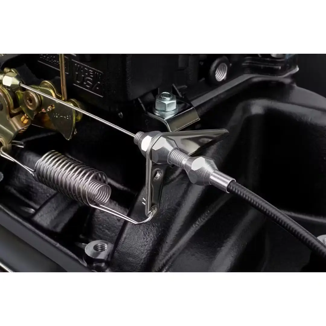

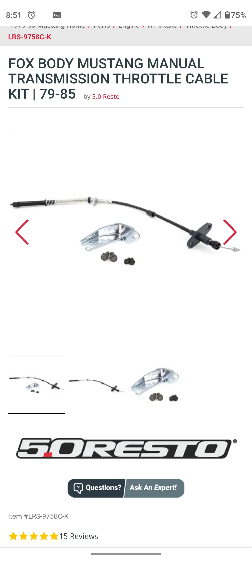

85GTStangGuy 5 Year Member May 19, 2021 1,003 625 133 Jax, Florida May 21, 2024 #22 May 21, 2024 #22 Noobz347 said: Does [anybody] happen to have the part number for that carb bracket? It's from an 82, correct? Click to expand... Based on the LMR bracket, it looks like the same bracket fits 79-85 carb'ed V8's. https://lmr.com/item/LRS-9758BRKT-K/mustang-throttle-body-cable-bracket-79-85 Edit - Did some p/n digging. I'm seeing 2 part numbers for the bracket for 5.0 carb'ed Mustangs... 1982 - E0DZ-9728-A 1983-1985 - E3ZZ-9728-A Last edited: May 22, 2024
General karthief wonder how much it would cost to ship you a pair Mod Dude Aug 25, 2016 27,983 10,611 213 polk county florida May 21, 2024 #23 May 21, 2024 #23 I'd bet that bracket is used on most all 302/5.0 carbs installed on 74-5 up to 84-5 Ford small, mid size and trucks. Just a guess.
