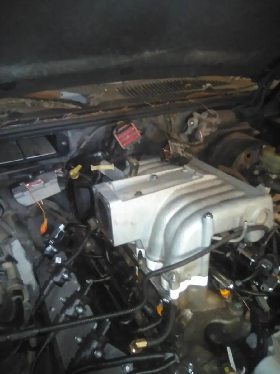

I Had to use a 1" spacer between the upper and lower plenum so that the upper plenum would clear the "Godzilla" coils. So, I happen to have the added benefit of a cooler upper plenum. It might help you in the future if there is enough hood clearance in your Mustang.
1" Delrin spacer
Installed
Reactions: PonyGTrider
1" Delrin spacer
Mine is a 90 GT with a stock hood and 3/8” is the tallest spacer I can fit there. So I have a 3/8” phenolic spacer. The intakes will be cooler when I block the EGR port at the heads.
Thank you
Reactions: GOvert

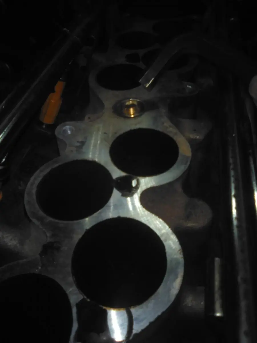

I found a core (freeze) plug that fit in that hole.
Reactions: GOvert

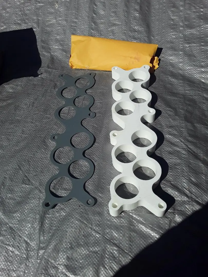

My 3/8” phenolic spacer has the EGR hole but in my case I’ll order a set of either FLP-1250-S3 or FLP-1262-S3 lower intake gaskets, those S3 gaskets don’t have the EGR hole so you block those gases right at the heads and that keeps some of the heat down
Reactions: GOvert

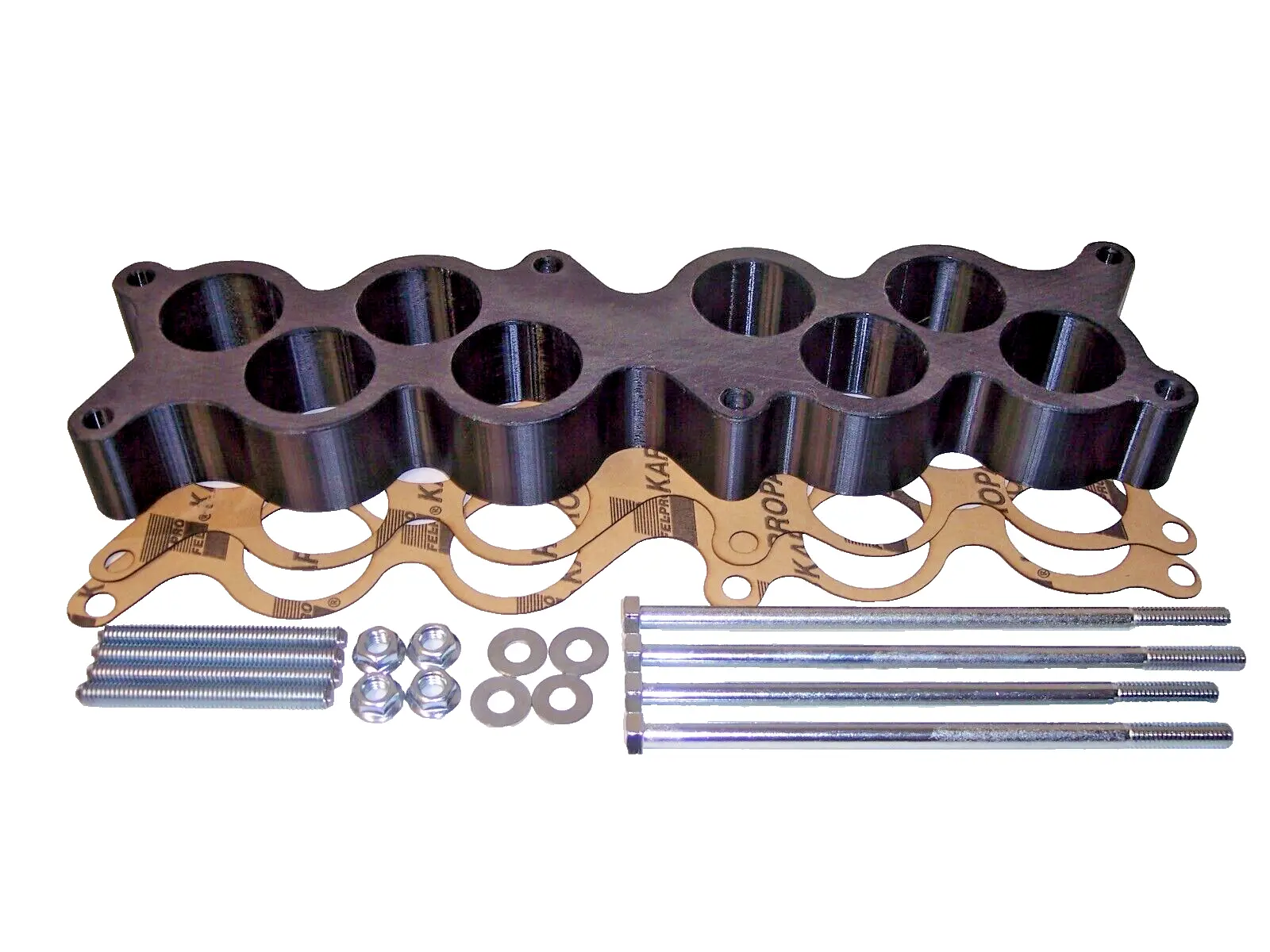

In hindsight, that’s what I should have done but I don’t want to pull the lower intake. Just looking to block it at the lower
Only one I can find is the bbk 3/8” without the hole
Ford GT40 Cobra Intake Manifold 3/8 Inch Phenolic Spacer Kit 86-95
Enhance Your Ford GT40 Performance with the Cobra Intake Manifold PART #1506 FEATURES: Promotes - BBK Performance
bbkperformance.com
bbkperformance.com
Yeah sometimes plans change and come up after the fact but that spacer will work fine

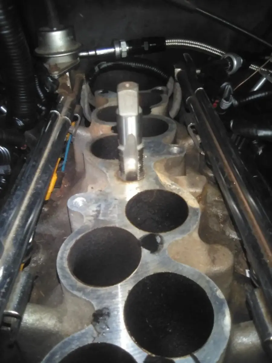

Tapping for a pipe plug is an excellent way to address the lower intake ERG port. I used a Dorman steel shouldered expansion plug on mine., as mentioned earlier in the thread. I did tap and plug the exhaust crossover/EGR passages coming out of my AFR heads (1/4" NPT) to stop the exhaust gasses from heating up the lower.
Another old school way to address the lower intake EGR passage (if you had the lower intake off) would be to pack it with furnace cement. This method worked on patching up late 70's to early 80's Ford EGR spacers found under the carburetors The exhaust gasses would eat away at the cast EGR spacer over time and you would have an under-hood exhaust leak. Pack the ERG spacer cavity with furnace cement and move on. Not very elegant, but it was highly effective with no comebacks. There may be some suitable high temp epoxy products on the market today, but this was an inexpensive "Saturday Afternoon Hardware Store Solution" that would work. Welding a passage closed is really the best answer, but not everyone has convenient access to that.

Actually the Felpro 1250 intake gaskets have an insert to allow you to keep the EGR port open or block it off.
The 1250-S3 has the port blocked off
Reactions: 90trunk and GOvert
