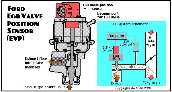

EDIT: Found this image from jrichker. Sort of looks like the headers crossover in the manifold (which I know they don't..) but I guess the EGR passages are part of the lower intake manifold and activated by the solenoid which is visible. It looks like a line runs to the bottom of the valve though? I circled it in green. Or is that INSIDE the manifold? I can't tell from the diagram.

The vacuum lines I can see, it was the actual line that carries the gases he was looking for. Now in the Holley directions, they mentioned internal or external EGR, but I was looking for a diagram I guess that showed it. I know what the thermactor tubes/hoses look like but didn't recall the EGR.
ratio - is it internal to the heads? Does anyone have a diagram or a reference for this? I'm thinking I'll need something to show the inspection station...
That diagram is absolutely correct.
The red that appears to be header tubes crossed over is exactly how the internal plumbing is routed.
Look at your intake gasket... the hole in the middle from the head into the lower intake is the "tube" the exhaust gasses go through.
It then carries up from the lower to the upper right through the hole in the middle of the gasket between them.
Ultimately it travels through that passageway to your TB and EGR valve.
What you have circled is correct too, it all travels inside the intake manifold, hence it being "internal".
Mustangs did not go to external EGR until 94.
Trucks were external from day one on 5.0/5.8... maybe that is what the inspector is thinking of. ???
There are NO external feeds from start to finish in your system.

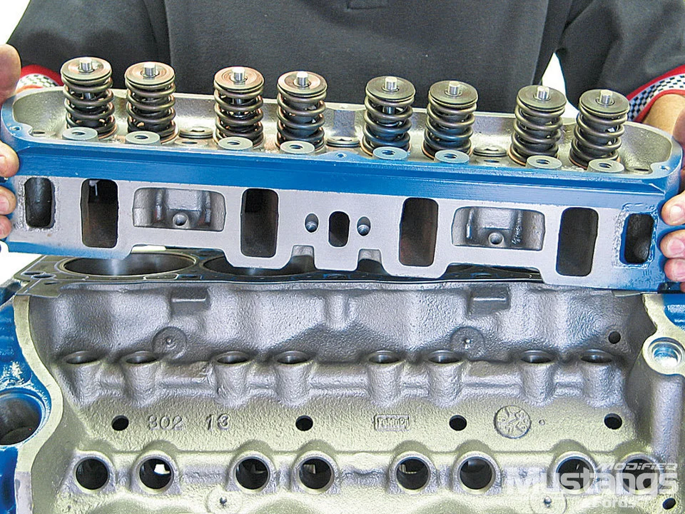

Ok I've read and reread the diagrams and I'm still not 100% on how the EGR valve works. I just don't see how it recirculates the air. Here are two pictures of my setup - anything out of the ordinary?

Ok - I think I've got it, after some deliberation and a few phone calls... The EGR being open draws air (vacuum) through the passages in the heads/intake manifold to circulate back into the intake tract?
I guess I was just looking at the diagram thinking the gases come out of the heads, and into the exhaust manifold. How would the gas go back into the head to continue through the lower intake and then into the upper? I'm just trying to picture the flow path in case I have to explain it. Thanks everyone for the responses so far!
Let's see if the pic works...
See the little hole in the dead center, between the 2 bolt holes?
That is where the exhaust goes into the intake.
Think of that hole as an additional exhaust port, besides the ones on the other side of the head.
The second cylinder's exhaust port feeds into that port, which then feeds the intake. The exhaust gas that goes this way, never makes it to the header, and therefore never needs an external tube to get it back into the intake as you are thinking.

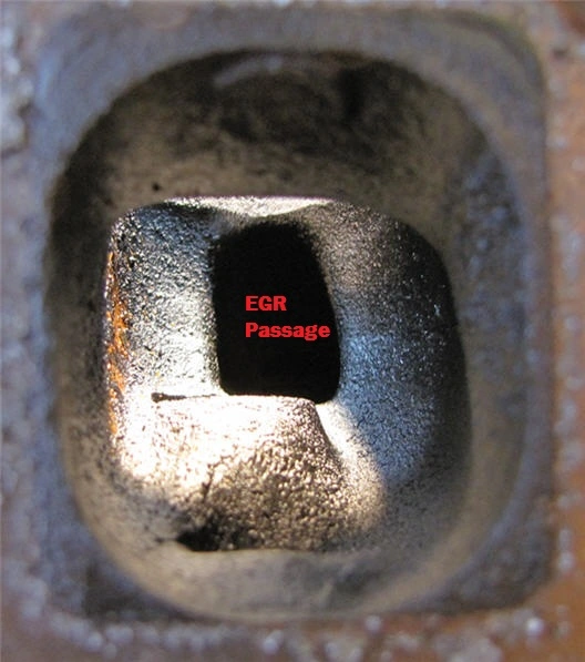

Here's another shot from the other side of the head.
This is looking into the 2nd exhaust port (valve out so you can see).
You are looking into the hole that feeds the header, and the hole on the other side feeds the intake, and eventually the EGR valve, which send the exhaust back into the fresh air flow being taken in by the TB and sent to the intake valve.
