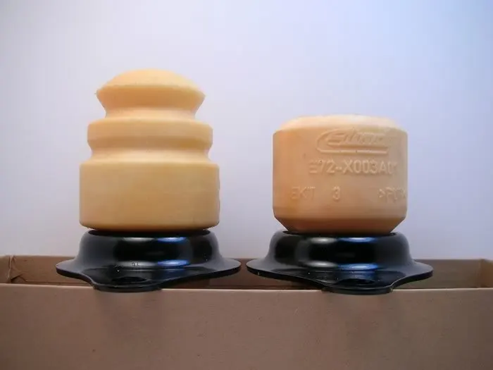

I know a lot of people cut their stock bump stops but I thought I'd try the Eibach stops #bs45001617 from their Sport Line kit. With the Eibach pro-kit springs on my car I can't even put my finger between the stock bump stop and the frame. When I put my big butt in the car I'm probably bottomed out :(.

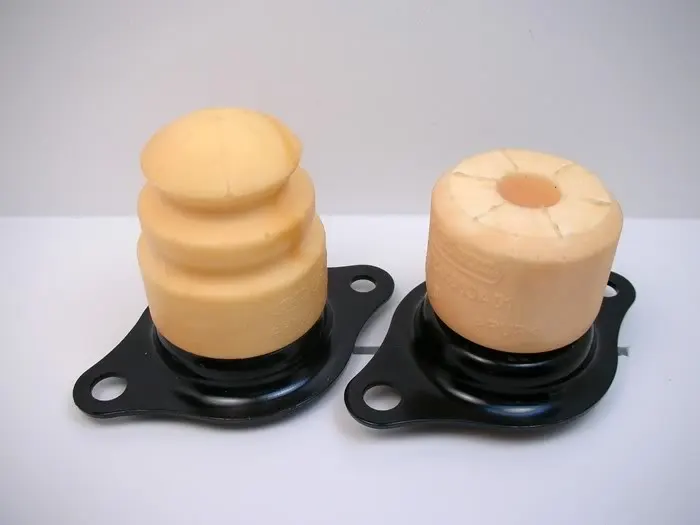

Here's a comparo of the stock on the left and Eibach on the right:
The Eibach is a little more than 3/4" shorter than stock and feels softer, more compliant to me:
I report back when they are installed.................
