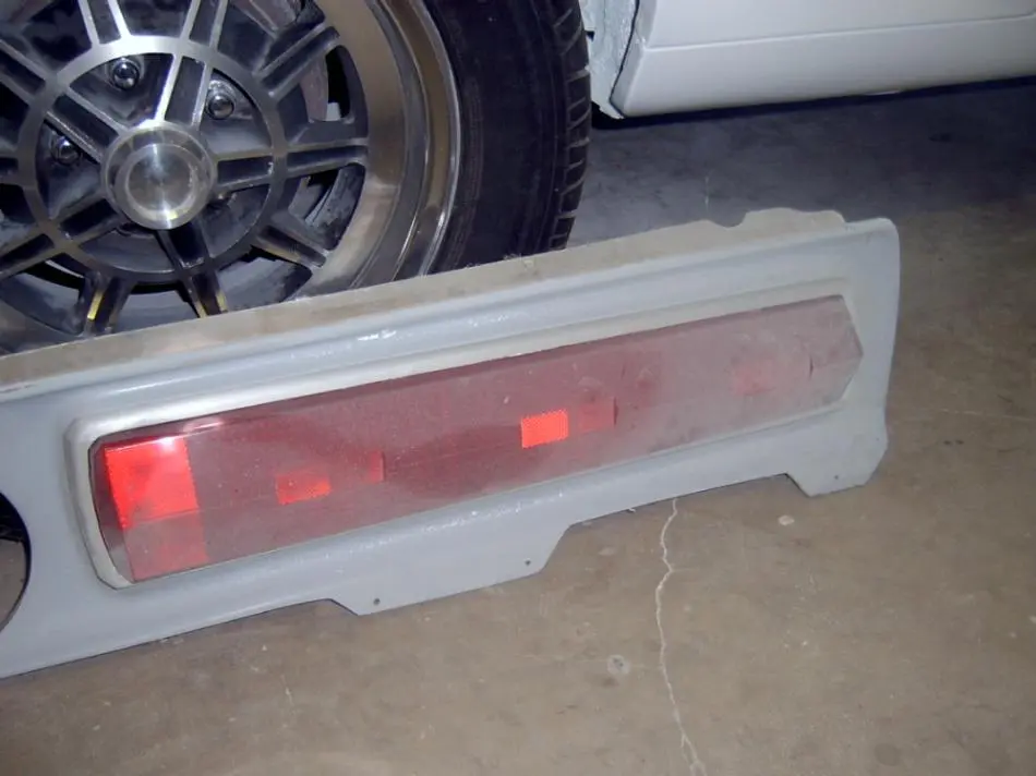

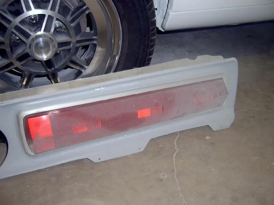

This is the taillight panel assembly. The trim rings have studs that go thru the Cougar buckets where the Cougar grilles mounted, sandwiching the 'glass panel in between the trim rings and the buckets. Then where the Cougar bucket assemblies mounted in the Cougar, you need to make some 1/4-20 studs out of all-thread that go through the boxes and hold the Shelby taillight assembly in the car. Once you get the nuts snug, the whole thing is very solid, but you still have to drill a few (6-8 or so in the whole panel) holes on the edges of the 'glass panel for small sheetmetal screws to hold the edges down. I'd also use seam sealer to help water-proof the whole thing. If you need better pics, or more pics or just advice, don't hesitate to ask!

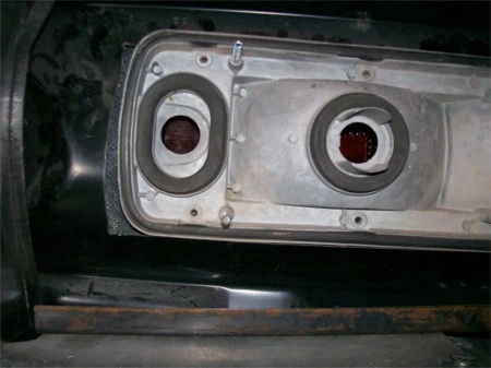

Nothing like posting two of the same pic! Here's a pic of the rear of the panel. The boxes are available from Branda, but I haven't been exactly over-joyed with their parts. They easily have the highest prices though! Anyway, I'll look up the user ID of the guy I bought mine from, he's always got stuff on ebay and I'm very happy with mine.

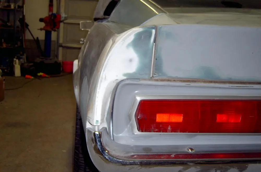

Good news, I found an older pic of my end cap as it fits on the car. It's tough to see, but if you look closely, you can see where I had to add fiberglass to the edge of the end cap to close up the huge gap between it and the taillight panel. Also, I measured my gap with a paint stirring stick all the way around the trunk lid and kinda "eyeballed" the end cap/taillight panel gap to make it look even. You may also notice that the gap between the bumper and the end cap is about twice as large as an original Mustang gap, but original '67 Shelbys have the huge gap as well, so I didn't sweat it. Hope this helps.

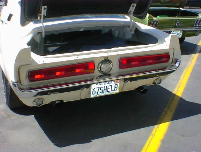

Don't feel bad zoo, it looks like the original ones had that gap too....
Looks like we're victims of our own high standards. Higher than even the originals.

Jay, thanks for posting that pic! Now I know how many screws held the upper part of the taillight panel on! Believe it or not, I've looked through countless books and magazines and have never seen that view before. Usually when a pro photographer shoots a trunk, he gets so close all you can really see is the inside of the trunk area. I also bought the Shelby assembly manual from Branda, but it didn't specify the screws. Now for the next question: are they sheetmetal screws or pop rivets or what?

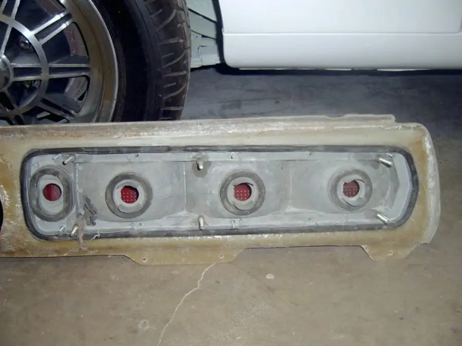

Hello again friends!
So I'm preassembling my 67 Shelby tail stuff and it's not making sense to me.
It appears that:
1-the lens tightens to the gasket and then light housing,
2- That the panel is cut large enough that the housing will fit through the hole,
3-the ring tightens against the fiberglass panel from bracketsthe outside, and,
4- the brackets hold the housings on the inside.
Please confirm if you know as I need to cut my holes a bit larger for the housings to fit through. You can see what I mean in the picture I attached.
THANKS!

Hi Mike, unless I'm not seeing them (highly likely) I don't see the Shelby taillight boxes.You need them so the 'glass panel isn't supporting all the weight of those taillights. A any rate, you prety much have the assembly right, it just takes a bit of fussing with it to get all the peices right. Here's what I did: first, set the boxes in place. Mine went together wih the top lip inside the original taillight panel, and the lower one outside the taillight panel. Next loosely assemble the taillights the way you described (lights inside the panel, trim rings outside) so the you can wiggle the lights slightly to get them inside the boxes. Then you need to make some studs to mount the lights to the boxes (I used 1/4" all thread, cut to fit). Once you get the whole assembly in there, it should be solid as a rock, even without screwing the 'glass Shelby panel in place. If you need pics, I think I have some of my car when I put it together, I know it's no picnic to get all that crap in place and fittng correctly!

Thanks Zookeeper- I do have the boxes. I probably should have put them in the picture.
So it appears I just didn't cut my hole big enough for the lens to match up to housing.
I'd rather have cut too little than cut too much I guess. Mr Plasma will fix that in about a minute.
