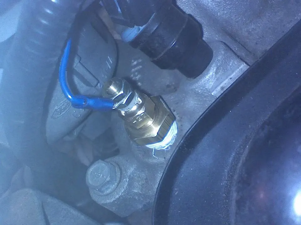

yes the ect is the one i am talking about but like i said put a autometer gauge in so that would me i replace the othere sensor for the gauge i dont even have the old one hooked up any more.... would that matter do i have to have that one hooked up to run the fan or just the ect witch is the one i replace it with....
95_cobra123
Jun 14, 2004
213
Lovington, IL
Apr 7, 2009
  • Apr 7, 2009
Ok here is the temp gauge one is that done right i am guessing yes. i did nto hook up the old one because it did not work anymore.

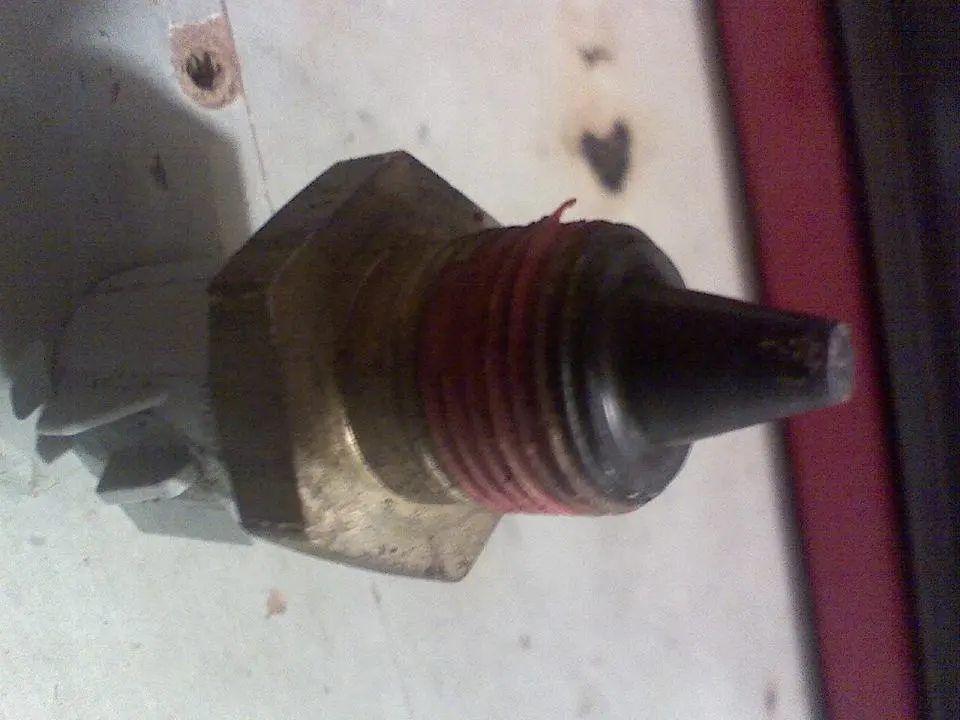

ok here is the old ect it does nto look to good to me. but what do i know

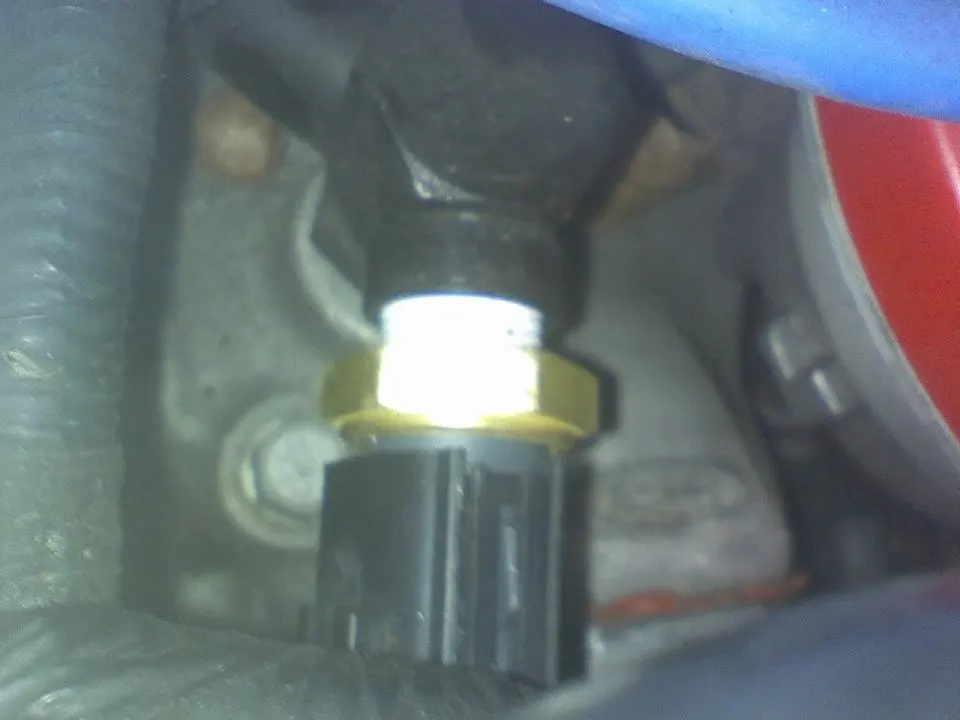

and here is the new on in.
