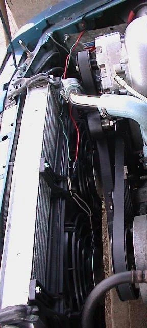

hey guys i bought an electric fab from a g3 stang and want to put it in my 93. is there agood kit i can buy that has evert=ything i need to install it? if so where can i get it? BTW yes i aso have a 140 alt to put in also, but i have all the insrtuctions for that.
Thanks
Dual 12" electric fans
